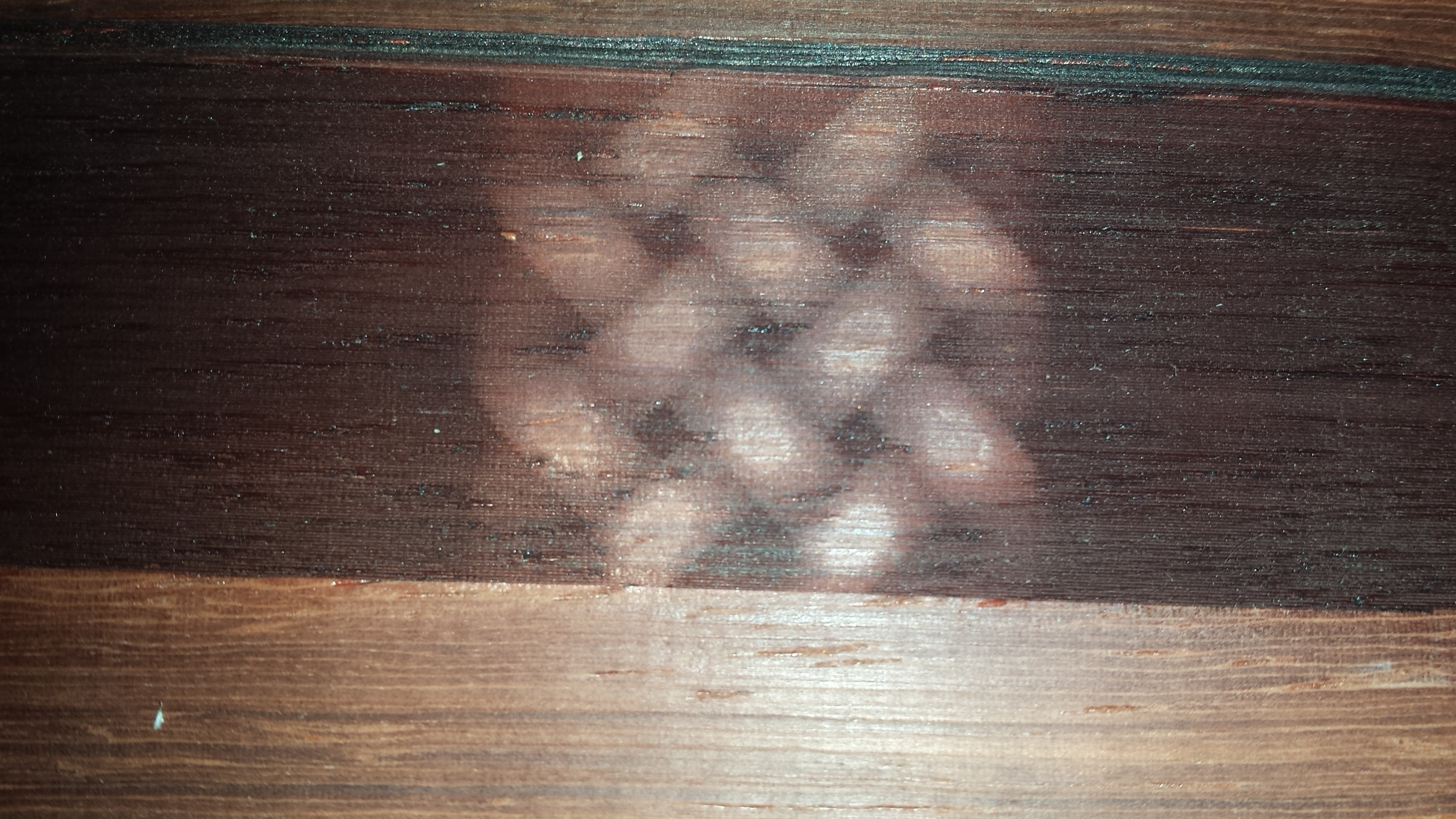

Hi Guys
Playing with 3d sculpting.. first try with a single pass of a celtic knot output.
Weird looking, looks ghostly..
