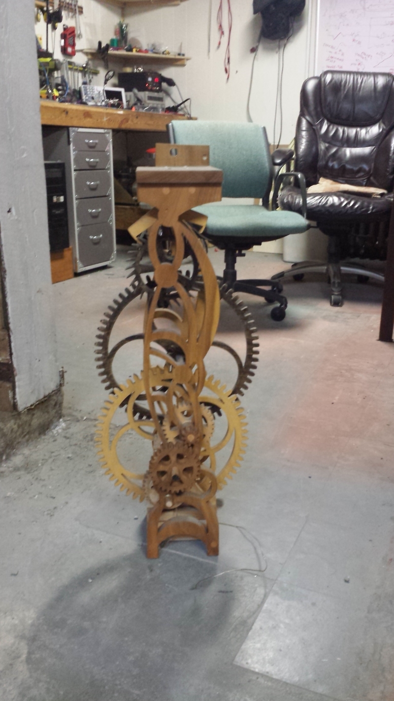

But you know, building a clock or a ticker isnt always about doing it right, Im as proud of my old wooden clock that barely runs due
to friction as I am of my ticker that runs very well. I do it to learn and make a work of Art.. ( No pun intended. :-) )
So dont feel you HAVE to use large wheels, use whatever you CAN make, it will still work. Use cycloidic teeth or cage gears to their
best advantage, start with the escapement, its always the best place, then work backwards to the weight or spring, then again forwards from the escapement to your hands..feet..whatever will display the time, if indeed a display is necessary. I'm a huge proponent of gear works that just..well..run, they dont even need to do anything other than look good.
In fact, I just took down my first wood clock and will now ( at my wifes request) turn it into a plant holder. So never feel constrained
by convention..
( Heres a photo of my old wall clock as an example, Ill be adding a small table to the top to hold a plant.. :) )
Just my advice..
