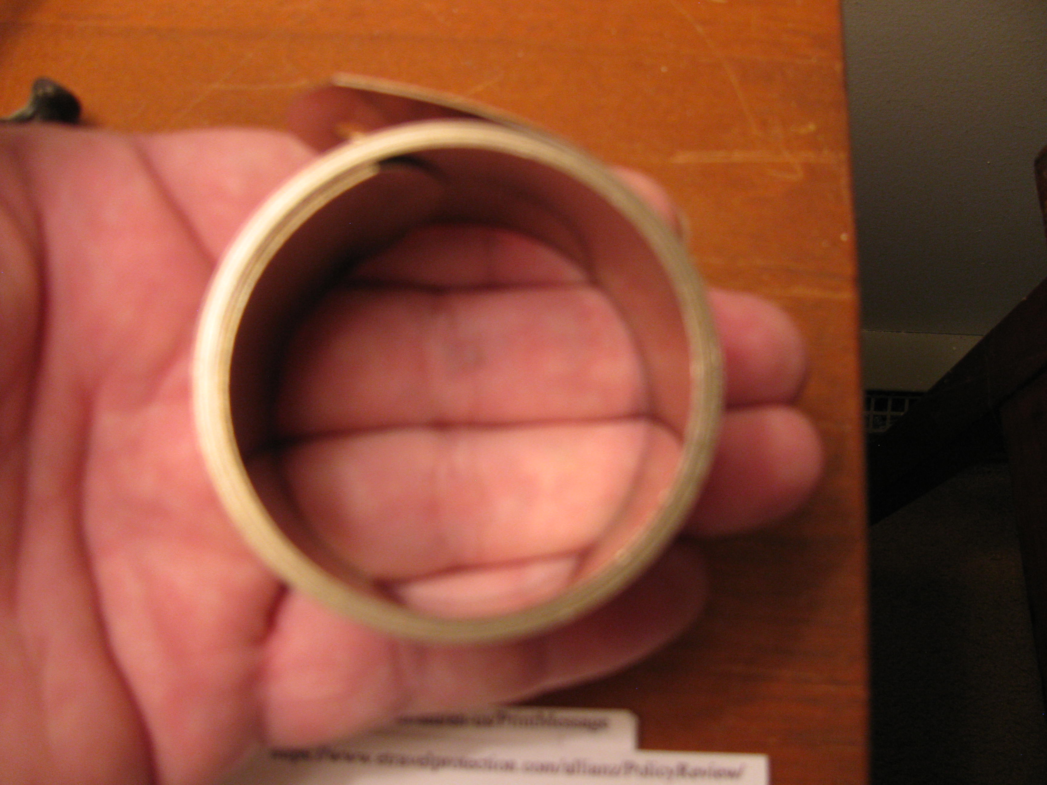

The original bat used a constant force spring, I thought it was constant torque, so I
spooled it that way. Worked fine.. but the guys at Vulcan spring told me it was wrong and
may wear out prematurely

That's interesting. The spring I bought is rated at 25,000 uses as compared to constant torque springs rated at 2500. I wonder how much it will be affected? Did you back wind your spring, or wind in the springs natural direction? Had you noticed a difference in lifespan on your creation?
I would love to be able to wind it, it being compact really leaves a lot of options.

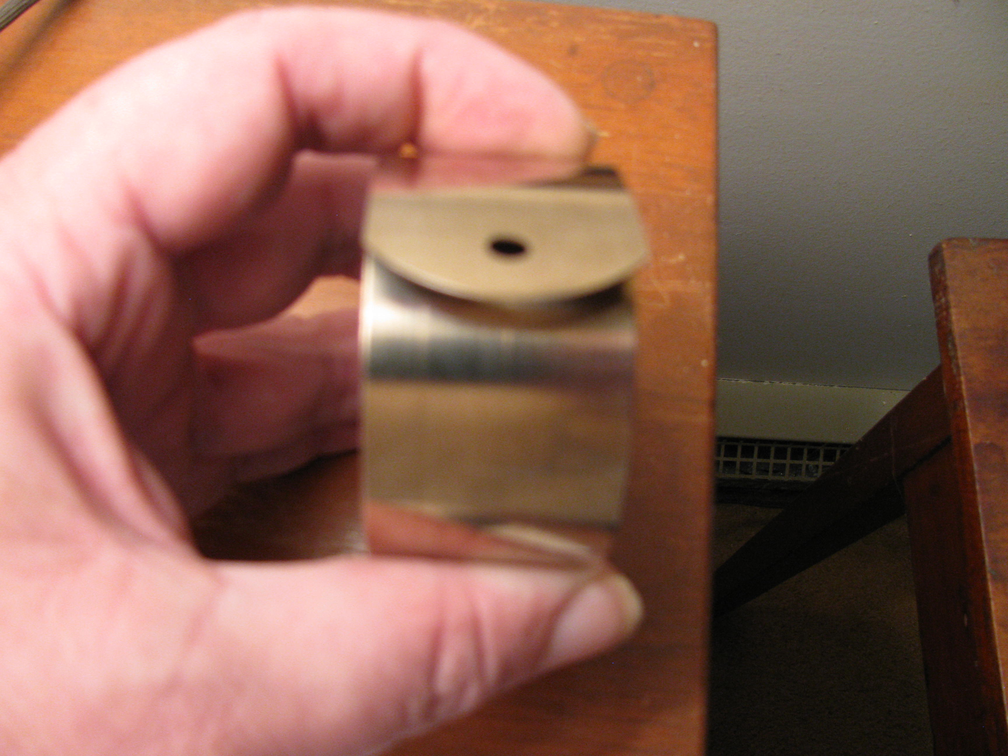

Wow, thats quite a spring. I have a couple similar.. but mine of that size are way more than 4 lbs..
I did back roll it, it worked fine in the original bat. But the springs Im using are much smaller. The spring
Im using sits on a 3/4" thick spool. Yours looks to be 2" thick or so.. How hard is it to roll off the spool?
Does it feel like 4lbs or much more? I have a couple that size and I can barely unroll the things..

If the seller can be trusted ??? it's 4.3 pounds, and an inch and a quarter wide. I can retract it, but it's my first 4 lb. spring so I have nothing to compare it to. I will test it with a known weight when I get a chance. It seems like it wont like being back wound.
heres the link on e-bay. He's got one more for sale...the price was right anyway...
http://www.ebay.com/itm/Stainless-Steel-Constant-Force-Spring-48-L-X-1-25-W-25000-Cycle-Life-4-37lbs/291898742447?_trksid=p2045573.c100033.m2042&_trkparms=aid%3D111001%26algo%3DREC.SEED%26ao%3D1%26asc%3D38530%26meid%3Dedb1d654c1b14e6e8d7d8ca2a0b06e23%26pid%3D100033%26rk%3D8%26rkt%3D8%26sd%3D311745280230
It could very well be, Im no expert on springs. The one I used was only 3/4" wide or so in the original,
the spring Im using now is quite easy to roll, and does seem to have about 4lbs of torque, though I
have never measured it.
I'll make sure to do a section on these springs when I finally get to a video on the bat mechanism
...when it works. :)
