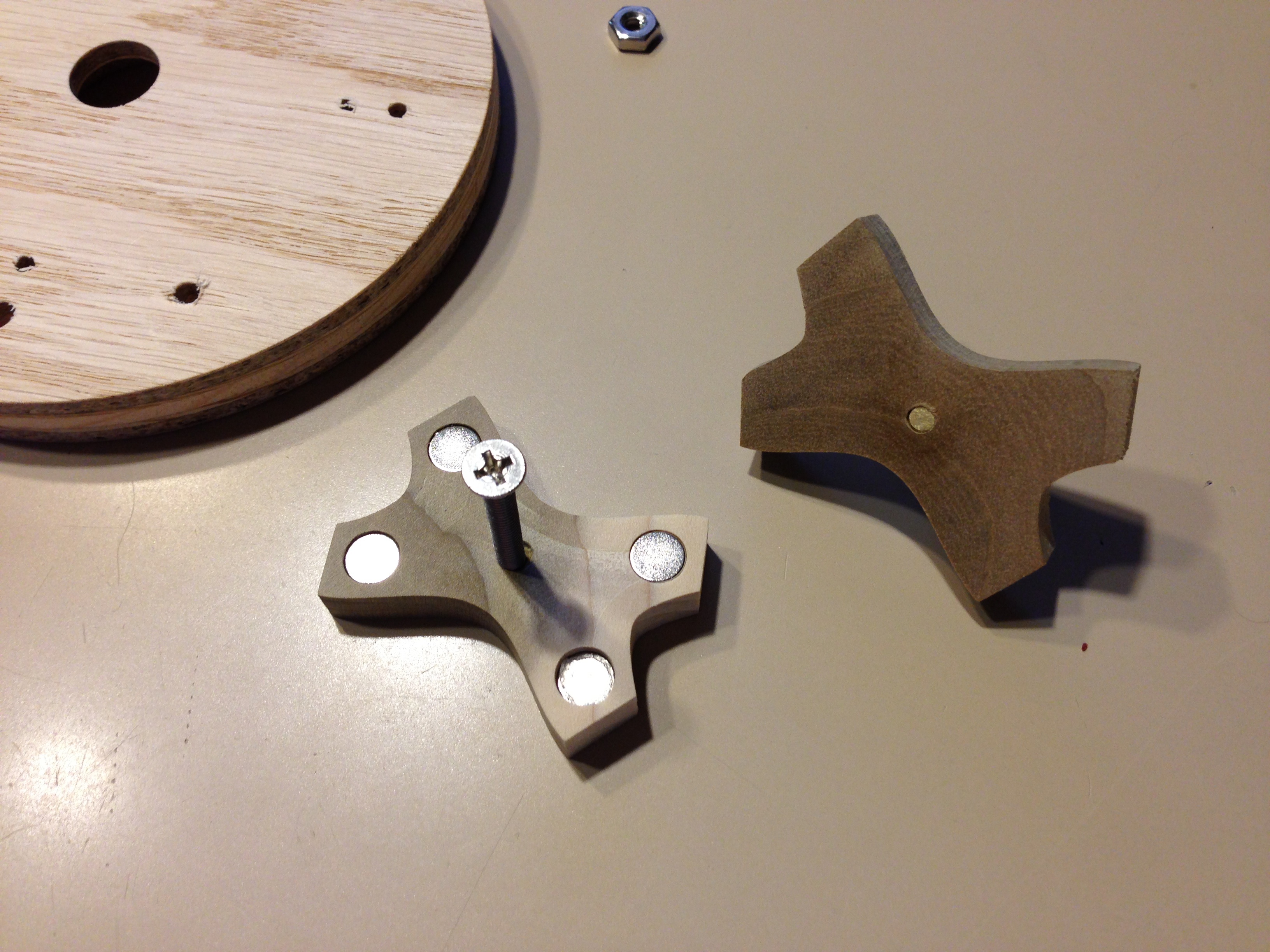

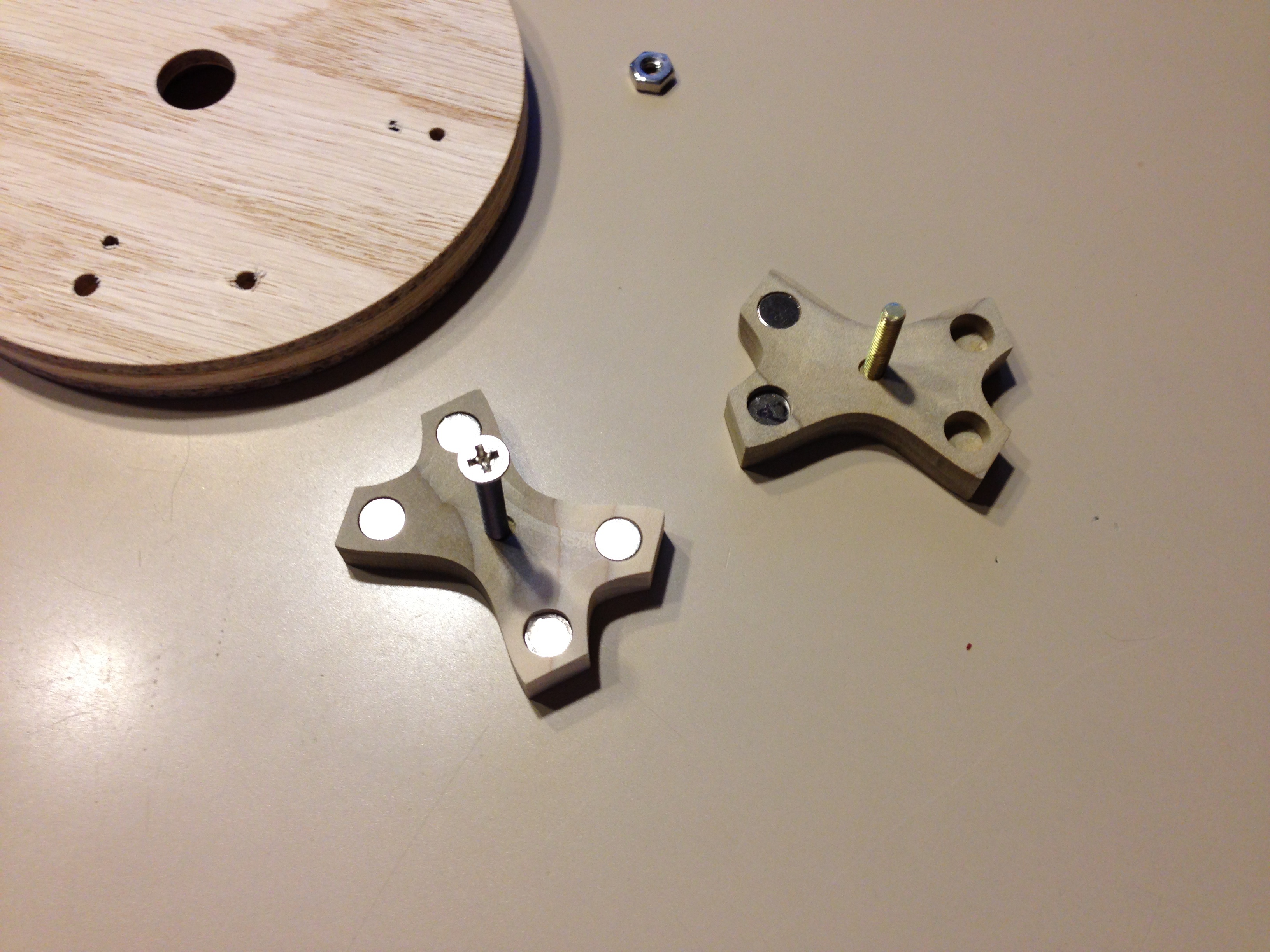

Cut out a few pawls...
Going to set up a test jig and see what happens..

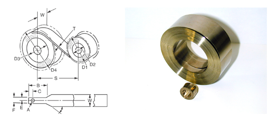

I see plenty in stock for the Negator springs...
Different Torques ...Here is an example...$27.69
Spring Torque
5.5 lb-in
Fatique Life
2500 Cycles
Spring Length
175"
Spring Thickess (t)
0.01"
Spring Width (W)
0.625"
Material
301 Stainless Steel
Drum Size(storage)
1.28"
Drum Size( Output)
2.23"

The size I need are the ones 3/8" wide. They report out of stock. I'm not positive but thinmk that is what daid used.
