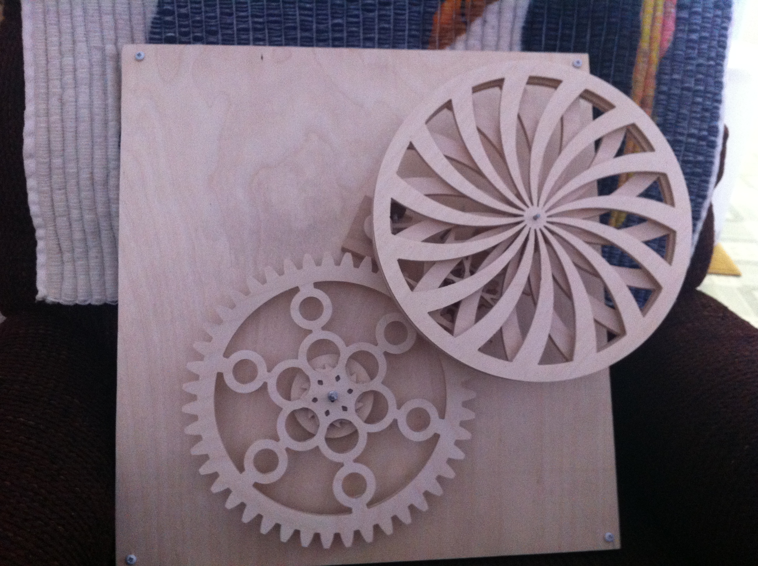

Re: Welcome to Tickers..
Here's my go at a ticker. I've used the dimensions of Scimitar with respect to the gears and the ratchet mechanism.
I don't use bearings just steel on wood and I usually use 1/8" shafts.
All the parts are cut from 1/4" baltic birch and the visual part is just a simple interference pattern from 10" toothless wheels. It works great on the test bench.
I had to clean (snow blow) about 1 Km of road to get to my CNC which is at the summer cottage where my CNC lives but it was worth the effort.
The Ticker is certainly not finished as the back is just solid wood and that will change in the future but my time has run out.
When finished it will be a shelf unit - no wall space left.
