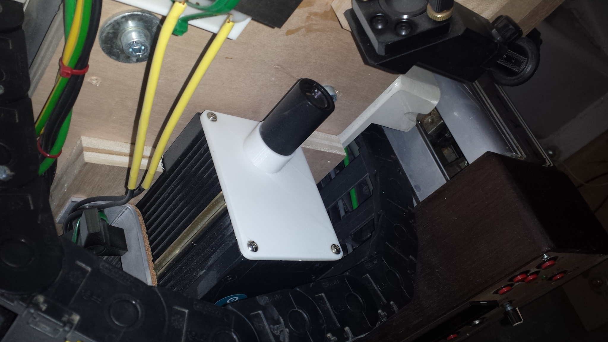

I love my 3d printer. When you need one, you really do need one. Notice the laser lens holder on this
photo.. I do stuff like that with my UP! printer. I love the results..

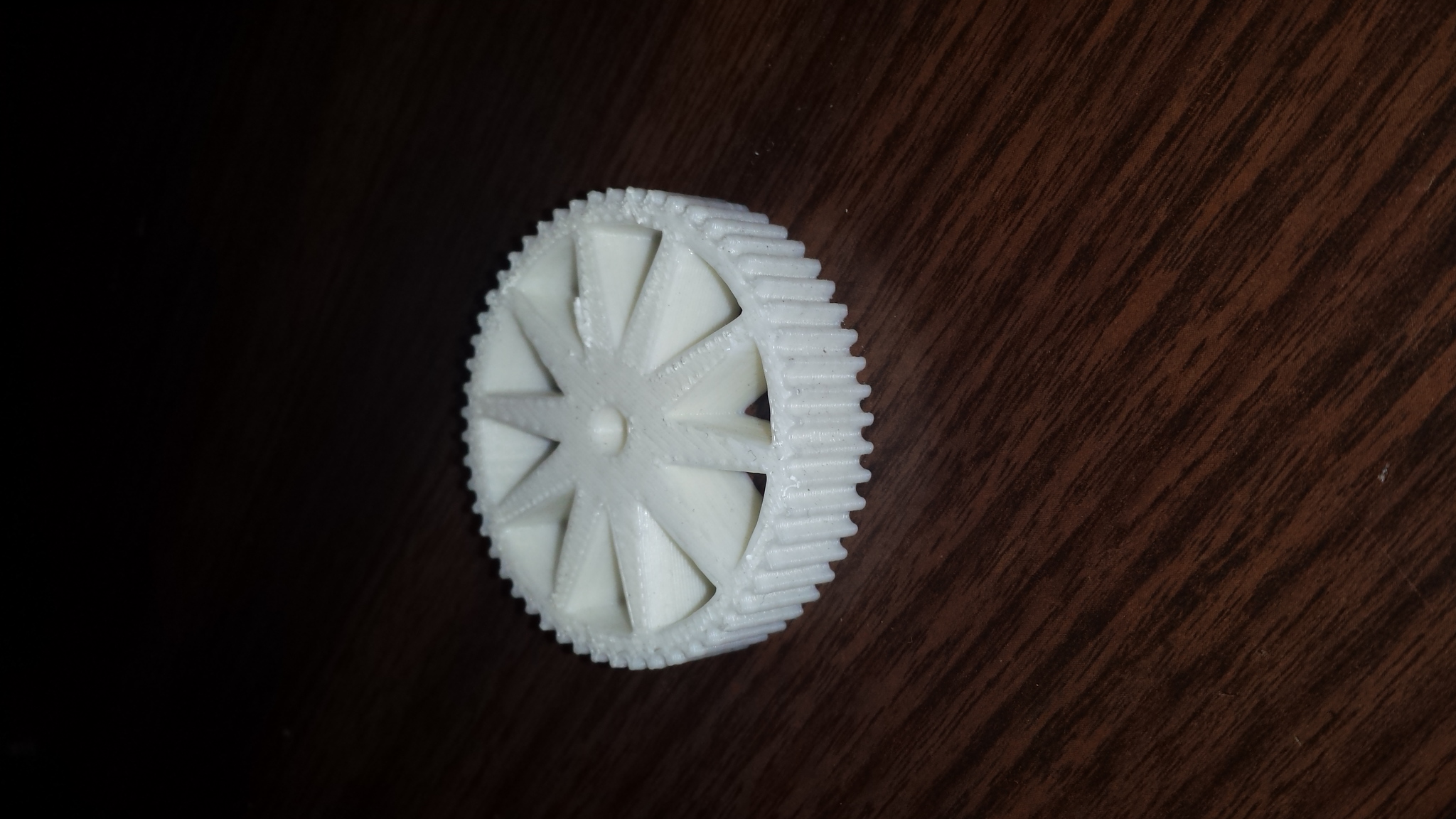

Here is a 48 tooth GT2 gear I just printed, for the Z axis reduction gearing on my laser cutter.
You can see a slight bend in the top rim, this is where I squeezed it  to remove it from the heated bed before it had fully hardened.
The slight mess around the captive nut for the grub screw is from where I slipped with the soldering iron pushing the nut into place :)
The gear was generated by the Openscad script I mentioned previously from Thingiverse and exported as an STL ready to be sliced and printed - all of the required settings are already in the script - gear profile, gear height, hub diameter, hub height, bore size, number of grub screws, top and bottom retainers, etc, you just edit the settings at the beginning then render and export.

HEre's a gearotic one printed on an UP! printer..
