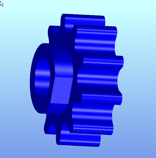

I believe it is a gt2..but its been awhile since I printed it so I cant swear to it..
  I dont usually add the hubs and such, but you can add a set screw hub for 3d printing,
though you have to drill it yourself afterwards. ( I figured printing the hole just makes it weaker..)
On the project screen, select a gear or pulley. Youll see two edit boxes on the lower properties window
labeled collar width and radius. Set them appropriately and hit respoke..
You should get a collar like this gear shows..

Thanks - that helps a lot.
