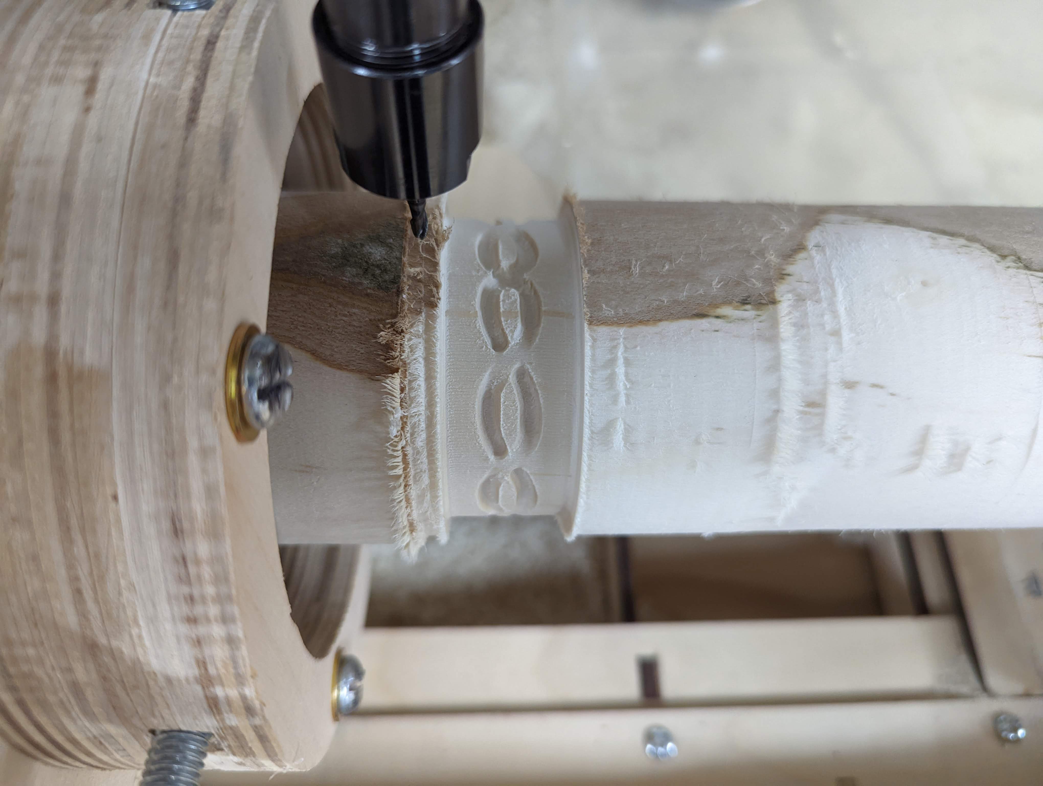

Here's a quick project to exercise a controller update from 8b grbl to FluidNC on ESP32 hardware, a celtic knot made with Gearotic.
This is on a rotary axis BobsCNC Revolution, VCarve Desktop (whose rotary handling could be better, and maybe realize that there's more to life than 0-360 degrees) and a chunk of 68mm OD soft maple that's still too wet (the side you can't see split overnight) despite having dried since last summer, brushed out of the Mooselake Manor's driveway. The controller is a 240MHz dual core ESP32 (remember when a single core 120MHz Pentium was big bucks?) that also is running an onboard webserver. Fun stuff!

Good attempt anyway Kirk..
