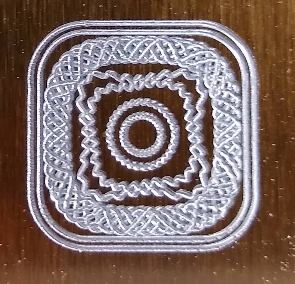

Getting there. No attempt at any actual art in this image, trying for line spacing and twists and turns (hey, I'm an engineer) but getting closer to dialing in the settings. It helped to get out the ruler and resize the window to the size I was cutting and not full screen for previews. Most everything was at 100mm/minute. Those 10mm line segments on the left are depth tests with hand written gcode, 0.05 to 0.35 mm (got carried away, way too deep, broke the tiny tip off the 20 degree bit) in one group, the second group was much shallower. 0.05 looked good in the second batch even with the shortened bit, although I didn't trust my spoilboard milling enough to use it so the bigger design was at 0.1mm (in retrospect 0.05m, that's like 2 thou, would have been just fine). Nice burr free edges and the detail is getting better. Might rework the test code to keep 0.05 and experiment with speeds, but the free online feeds and speeds calculator liked 100mm/minute for harder aluminum (said 0KW of cutting power, not really aimed at the 100W spindle market) and a 1 flute carbide bit, and the results look good. Now I need to develop some artistic technique...
I found another program, Guilloche Maker^^^^^^^^^^^^^^^Guillochograph, and downloaded a demo copy just to experiment. It comes with a number of preset examples but in a brief try I didn't get the hang of it's slider settings. When I get back to the windows computer (this is a chromebook) I'll post the type of design I really wish I could make and maybe the alaskan cruiser could help me with the settings after his well deserved vacation. Hope the moose and mosquitos weren't too big a problem...
If you look at the bigger design there's a couple places where it had some sharp angles and changed directions, don't know if that was an artifact from Carbide Create, my selection skills, or the wiz or the way it's supposed to work.

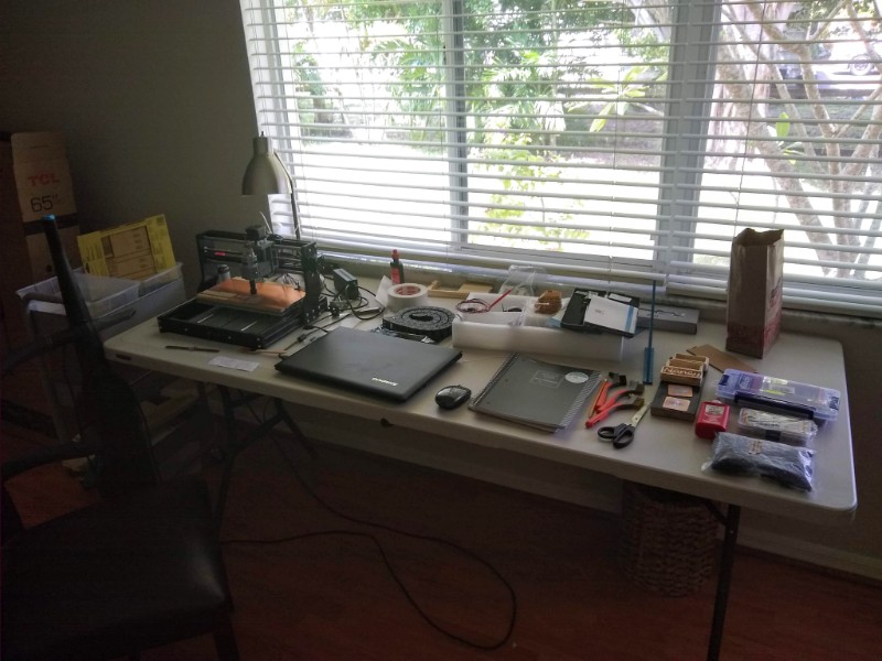

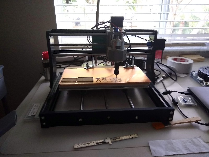

Here's the router, and for the amusement of those with real shops, the spare bedroom setup. Mrs. Moose just ordered a cleanup...
I think the table, lamp, supply cart, and misc stuff cost more than the router, maybe I should have gone for the 3040 4th axis with an 800w water cooled spindle and set it on some milk crates (around 30 came with the house, the PO was a lawyer and had a big 2x12/milk crate shelf setup for his legal files that we had to disassemble)
I was going to throw in a pic of the 20x15 drag chain I ordered (hey, it's 20mm extrusion) on the router but that's just too embarrassing. Guess it's been a long time since the last order.

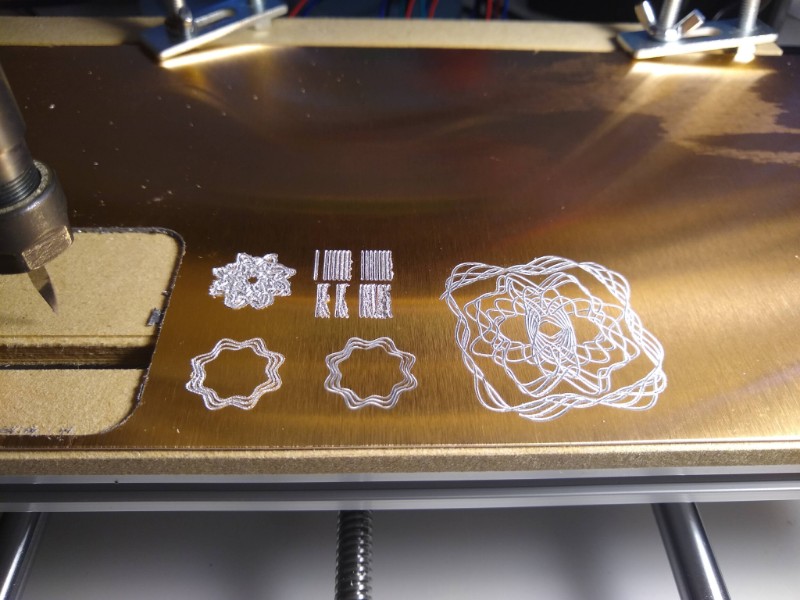

Today's effort, 25x25mm. Same broken top 20 degree V bit, 0.05mm DOC (had to rezero the bit, the piece of paper I was using is 0.05mm and forgot to compensate for it), 100mm/minute. Scrubbed with a stiff nylon brush but very little ridging around the cut even before that. Might need to dig out a new bit and get narrower lines. Could use a better camera and lighting, the lines are a little out of focus and maybe a smaller light source than the 20W LED in the desk lamp would bring them out better
