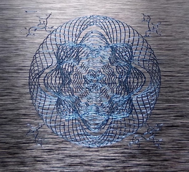

Did the test pattern again with a 20 degree flat v bit, 0.1mm doc, 100mm/minute. While the detail is better I don't like the effect as well, lines vs chiseled cuts, and it left a burred edge. Caved in and ordered a 90 degree diamond drag bit and collet set off eBay, will see how that works out, but for now the 90 two fluter wins.

I don't know if this is possible (pencil and t square guy), but I'm trying to take a simple guilloche pattern and use it to fill a random downloaded celtic knot dxf, remove all the guilloche pattern except within the knot which is composed of what look to be closed vectors. I was hoping that intersect would work but no joy. I grouped each object after importing or creating them. Weld (really need to rewatch the videos) turns the imported dxf into a bunch of circles. I also found an interesting undo feature, if I give up by clicking new after several failed undone attempts the old objects stay on the screen but are no longer selectable or deletable. I've attached a .vexx file
FWIW, I couldn't make Carbide Create do it either. My goal is to take a vector object and only have guilloche patterns inside it. For example, there's old engravings where only the interior of a leaf (or dragon) in my book are engraved and I was wondering if there was a way do to something similar. A more advanced technique would be having different patterns inside and outside the leaf (dragon, flower, etc) but one thing at a time

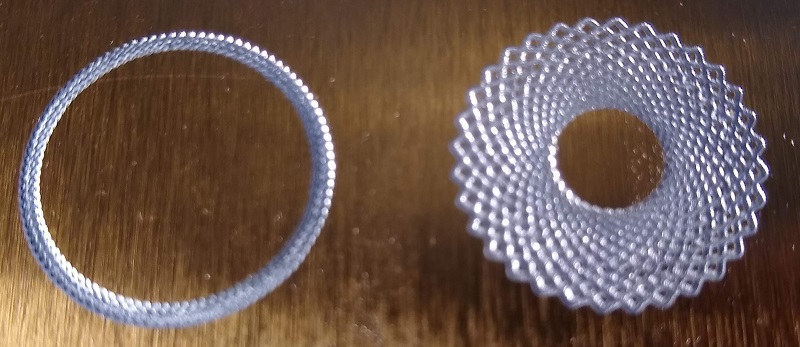

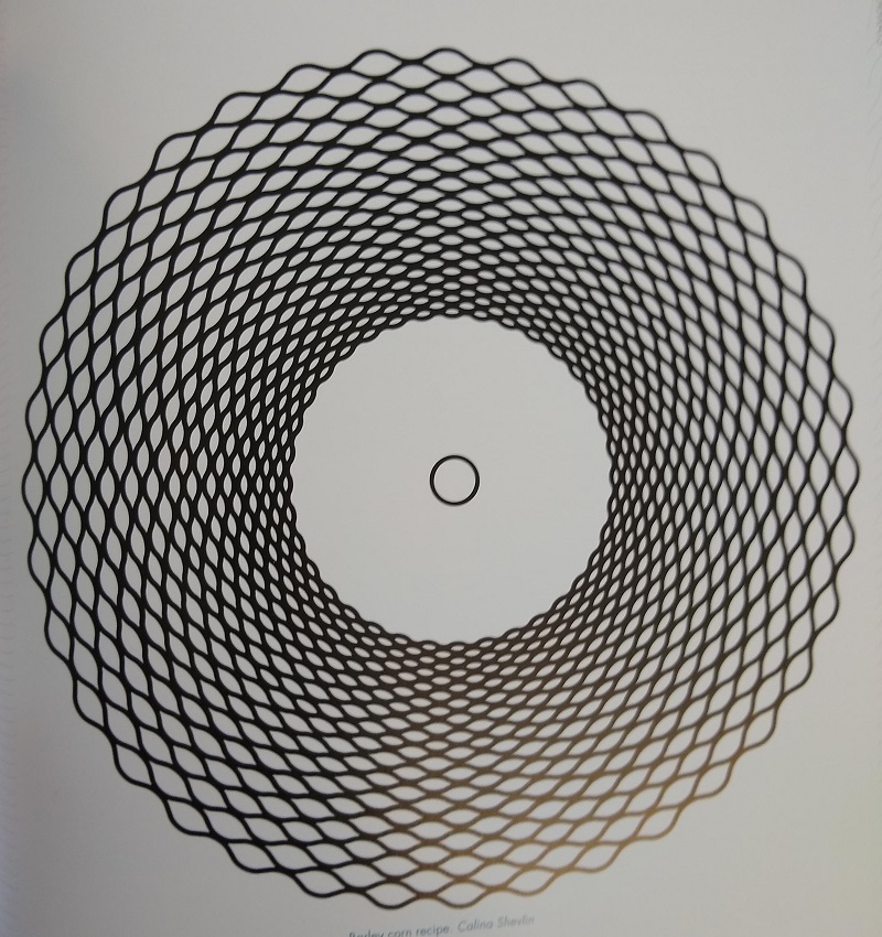

Barleycorn! Aka Grains d'Orge. The first one is a (simulated) 96 lobe rosette, the second is a 32 lobe. I adapted the recipe from my Guilloche book. Giggle "barleycorn guilloche" and you can see how the experts do it, in gold on expensive watch dials.
Creating them is fairly simple, if tedious. Set the inner and outer elliptical order to the desired number of lobes, and set both elliptical coefficients all the way right (you could use a higher number but for my 25mm size the smallest, i.e. most defined lobes, worked best) and set both phase sliders to 0 (not completely necessary, but if left at 100 you can't read the numbers easily). Set the maximum radius as desired, fill type to line, density to one. Using the outband and inband radius place the outer wiggly circle where desired. Click next. Enter a bigger max radius, then adjust the inband radius so the new line is just inside the first. Use the phase controls so the lobes touch, i.e. the valleys on the outside line match the peaks on the inside line, both should be the same. You will need to tweak the inband (or outband, either works) radius, I zoomed in on one lobe and stayed their, panning the display when necessary. Happy? Click next, readjust the max radius (you need the outband outside the new line), set phase to zero, tweak inband radius (the left and right arrow keys are really handy) so the valley and peak just touch. Repeat, varying the phase from 0 to what works, each time. Hey, it's easier than clicking the rose engine pawl 25 times.

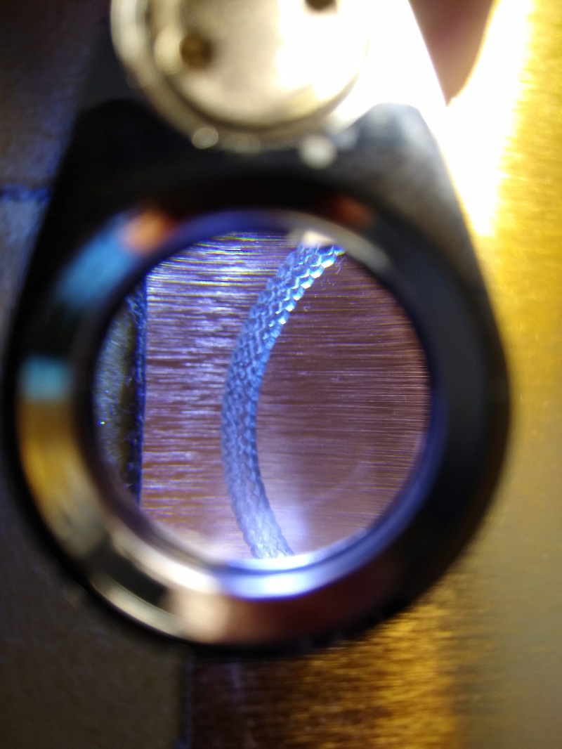

The 96 lobe, my first try, looks good under magnification but is too small for these aging eyes (cataract surgery after the knee heals up...). The 32 lobe pattern is just a little too coarse, should have either used a higher elliptical coefficient or more lobes since it left some uncut aluminum in the outer rings (I think there's 16 loops, something like that) but it otherwise looks pretty good magnified. I also attached the printed version from my book (all rights belong to the author, of course), so you can see how it's laid out.
90 degree two flute endmill, 25mm diameter, 0.1mm doc at 200mm/minute. Output as dxf and cammed with carbide create. And don't save your vexx file as .dxf, by the time I realized why Carbide Create didn't like it I'd already restarted from scratch and overwritten the file.

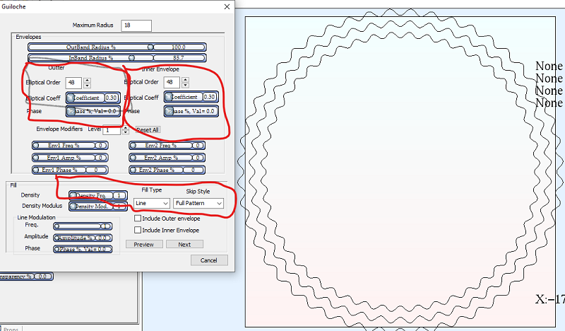

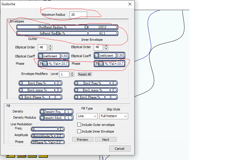

I'm sort of working along with a book on Guilloche and Rose Engines and trying to duplicate some of the simpler patterns, of course no guarantee that this is the right or best way since I'm really using the wizard in unintended ways.
I used the Elliptical Order box to set the number of lobes, and slid the coefficient slider all the way to the right to get the "gently undulating" curve. I've been setting both the inner and outer envelopes the same for now, but real rose engines used a variety of shapes. Search for Bill Oombs for a rose engine simulator, trying that out is on my list for the future. I set phase% to zero, only because it makes it easier to read and match up the numbers on successive traces.
Fill density is set to 1, Fill type to line.
The maximum radius will need to be adjusted to be greater than where you want the trace. Use the Outband and Inband Radius sliders (if you click on them you can use the keyboard arrow keys for fine adjustments) to get the size where you want it. When the outer ring looks right (it's actually the middle one in the screenshot) then click next.
I closed Vexx before the second screenshot so some values might be a little different. The Maximum Radius will change, set it back to your first value or something that gets the outer envelope outside your work, in this example I made it a little larger. You'll do this every time, different values for max radius might make the slidering easier as the pattern gets smaller.
Use the InBand Radius to get the second trace close to the first one, then use the Phase slider to align the high spots so they touch. You need to set both the inner and outer phase the same (or maybe not, if you want a different effect). Then zoom in and get the two bumps almost touching, and adjust the phase if necessary. When it looks good then click next and repeat, alternating a phase of zero and the value that lines them up. After a couple passes it goes fairly fast. Repeat until you get the desired effect or get tired of repeating :)
Hope that helps! After rewatching the Vexx videos I'm going to try the celtic knot cutout again, maybe with the snip tool and reworking the knot dxf to make sure all the shapes are closed. We'll see. My inspiration is attached (this one is from a swiss watch company via a link on cnccookbook.com) but I'll never get that good. No special reason for the celtic knot other than I like them and had this particular dxf sitting around. Why try something easy when there's something much harder sitting around :)

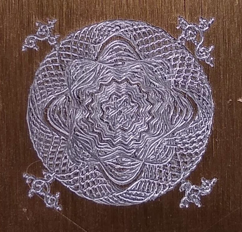

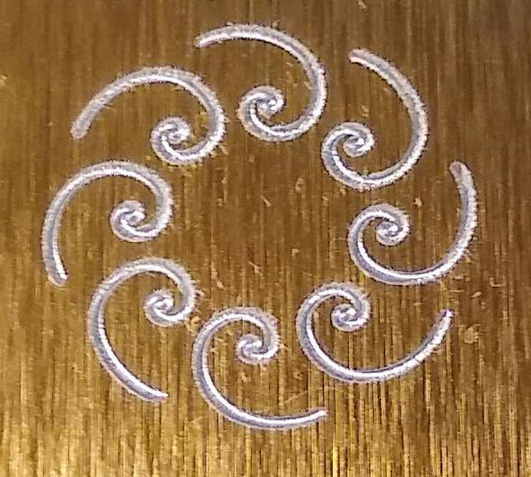

The diamond drag bit came today, and with no preparation except changing the collet and thinking half the bit extension was enough (worked out to 5mm "cut depth", really spring compression), at 200mm/min both plunge and feed rate did the attached photo; took about 15 minutes. It's the same 25mm flourished test pattern I've now cut at 0.05 and 0.1mm doc and both 90 and 20 degree vbits. I could hear little thumps where it crossed other lines, but couldn't feel (it's so slow, and non-spinning, I gently held a finger on the cutter) them, and it doesn't appear to have lost any steps. First time the flourishes and center detail came out. Pretty good for $50 US, I think, plus it'll engrave on plastic, steel including stainless, and glass from other user's reports. Tried to convince Mrs. Moose that since it was a diamond she could share it as her upcoming birthday present, which worked about as well as you may have expected.
I'm going to try the 96 lobe barleycorn for grins, then see what lobe count (no idea what the official term is) will give a nice effect.
As always the photo doesn't do it justice, just a 100Weq LED desk lamp at an angle and a cell phone. The original changes as you change your viewing angle, and has a better jeweled effect than my vbit cuts.

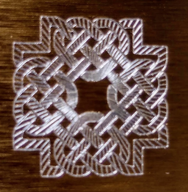

Today's effort, with the diamond drag at 300mm/minute and the usual 25mm square. Read that bigger routers do these at 4000mm/minute, might try one at the machine's 1000mm/minute max speed, and see what happens. Plan to keep the mouse over the non-physical (and really a black square) red mushroom button just in case.
This is the aforementioned celtic knot dxf with a line circular array on top, started with a line from center straight up, then did a 100 line circular array; could have done more. Much panning, zooming, and snipping later all the lines outside the knot were removed and this resulted. These lines would snip where the guilloche patterns would not.
