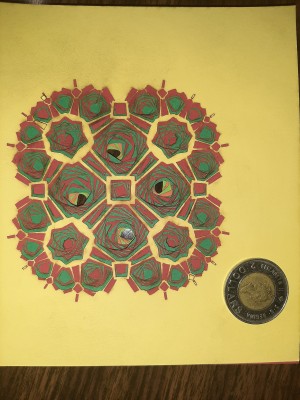

First trial cut of small autogen mandala.
Look better if my dirty fingers didnt cloud it up. :)

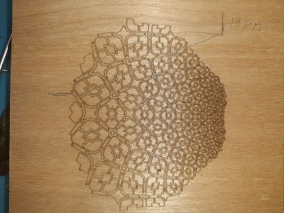

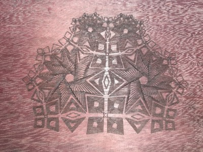

By Request, here are the first two tests on wood of the mandala output.
One is single level, the other multiple level, each took about 10- 20 seconds to burn.
