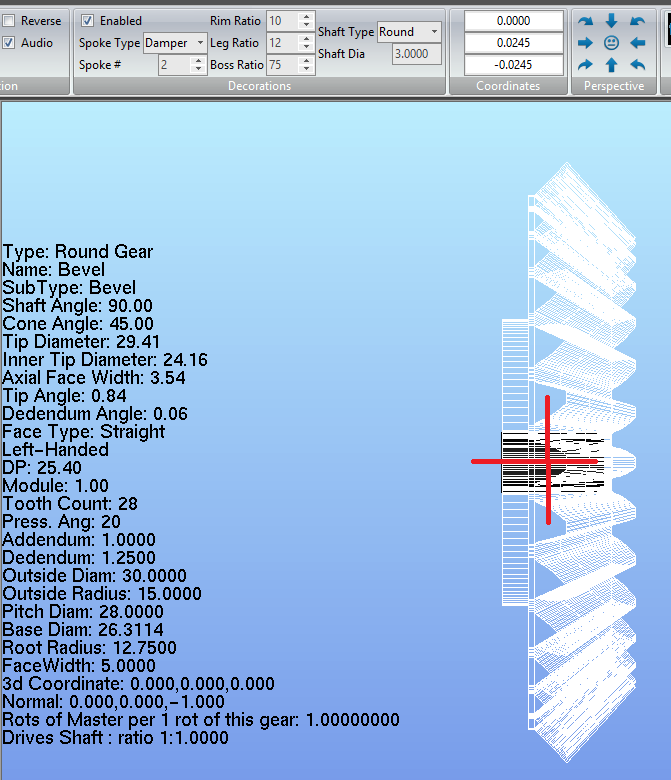

I did what you suggested, and this is what I got, see attachment.
The red cross is approximately 0,0,0
It doesn't help me position the gear on the axle at the correct position to mesh with the other gear.

I see what you mean. Even my memory was faulty on it. The 0,0 point is the pitchline start of the gear. It is the point of the gears profile that stayed in position as the rest of the profile bevels in or out. ( Above or below the pitchline.).
SO I guess what you need is to have the pitchcone distance. This woudl be the distance from the theoretical center of cone to that 0,0 point.
It would give you a distance from the intersection point of the two shaft planes to the 0,0 point of each gear in relation to the other. Do you agree
that would work for what you need? I can add that to the text output for bevels. I have trouble thinking of any other number that would be easy
to use in designing set centers... I will add that to the program and probably have a new version otu tomorrow with that data and we'll see if that
helps. Let me know any thoughts on other numbers that may help and I ll see what I can do.

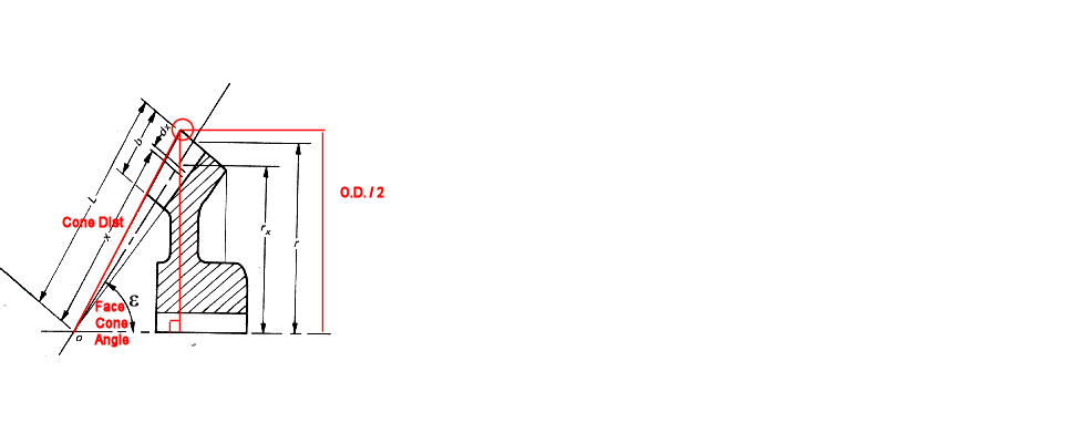

Thanks for making a new release for me, unfortunately I struggled to find the reference point to use.
What I ended up doing was calculating the distance using the Outside Diameter, Face Cone Angle and Cone Distance. See picture below. I'm not sure if Cone Distance is the correct value to use, but by eye the results look ok.
Using the outside corner made it easy to define a reference plane using my CAD software.
I look forward to the future release where we can just use the distance from the axis intersection to one of the gear's front or back faces.

A bit of a brain fade there. Cone Distance isn't used. It's just...ftkalcevic wrote: What I ended up doing was calculating the distance using the Outside Diameter, Face Cone Angle and Cone Distance. See picture below. I'm not sure if Cone Distance is the correct value to use, but by eye the results look ok.
L = OD/2 * tan( Face Cone Angle )
