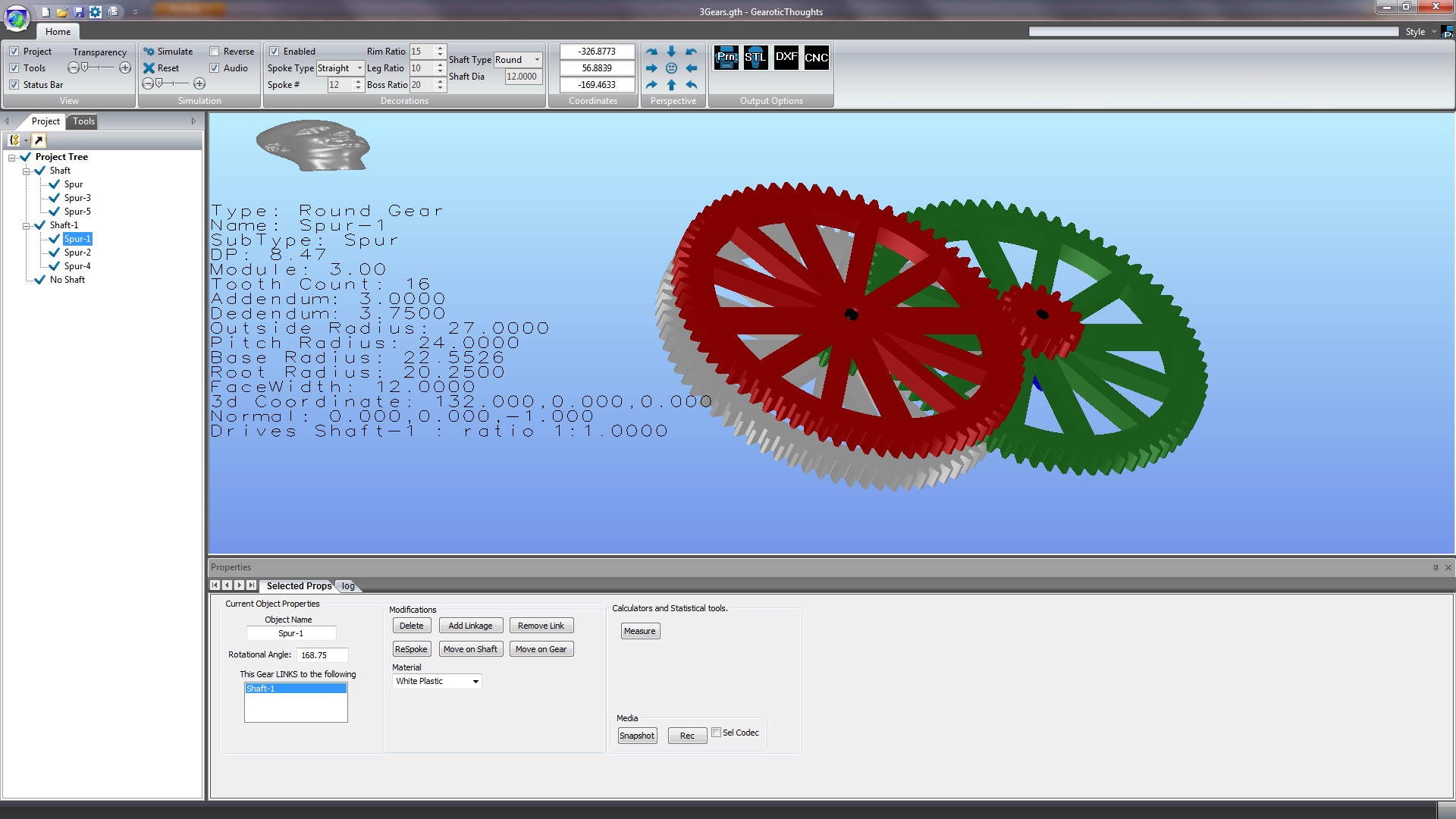

I'm muddling through with a 6 gear train, 3 x 4.5, and finding some things in GT that aren't working like I'd expect.
I'm unable to get a snapshot using the snapshot button under media on the project page. Here's one from shift-ctl-printscr. I'm unable to make a video file, and the select codec checkbox won't check. Most likely I'm missing something.
There's three pairs of gears, colored white, green, and red using colored plastic material types. The material type isn't restored when I save and reload the project file.
I can't seem to find a way to connect the gears together as I'd like using linkages. For example, I'd like the small white gear to be connected to and drive the big green one, and the small green gear to drive the big red one. Whoops, the small red gear doesn't drive anything, looks like it needs to be an even number of pairs <smacks head>. Right now, when I hit simulate, half the gears disappear. I exit the program and reload the project file to recover, loosing the colors in the process. I've tried removing linkages, but can't seem to get a list of available unlinked gears when I hit Add Linkage. I'll keep trying and see if I missed something. Zipped copy of the project file attached.
I don't think there's a way to put a bigger hollow shaft over a smaller one, or am I missing something there too?
