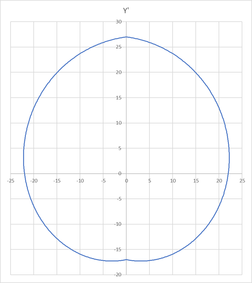

I don't have a photo of the final cam but here's a picture of the profile from Excel.
It spirals both ways - but easy to modify the code to only do one way (which was how my original was done but that can jam when driven the "wrong" way. This is the toolpath - in practice you cut the blank using a cutter with the same diameter as the follower roller, a 6mm ballrace in my case.
https://groups.io/g/synchronome1/photo/86249/13?p=Created,,,20,2,0,0
