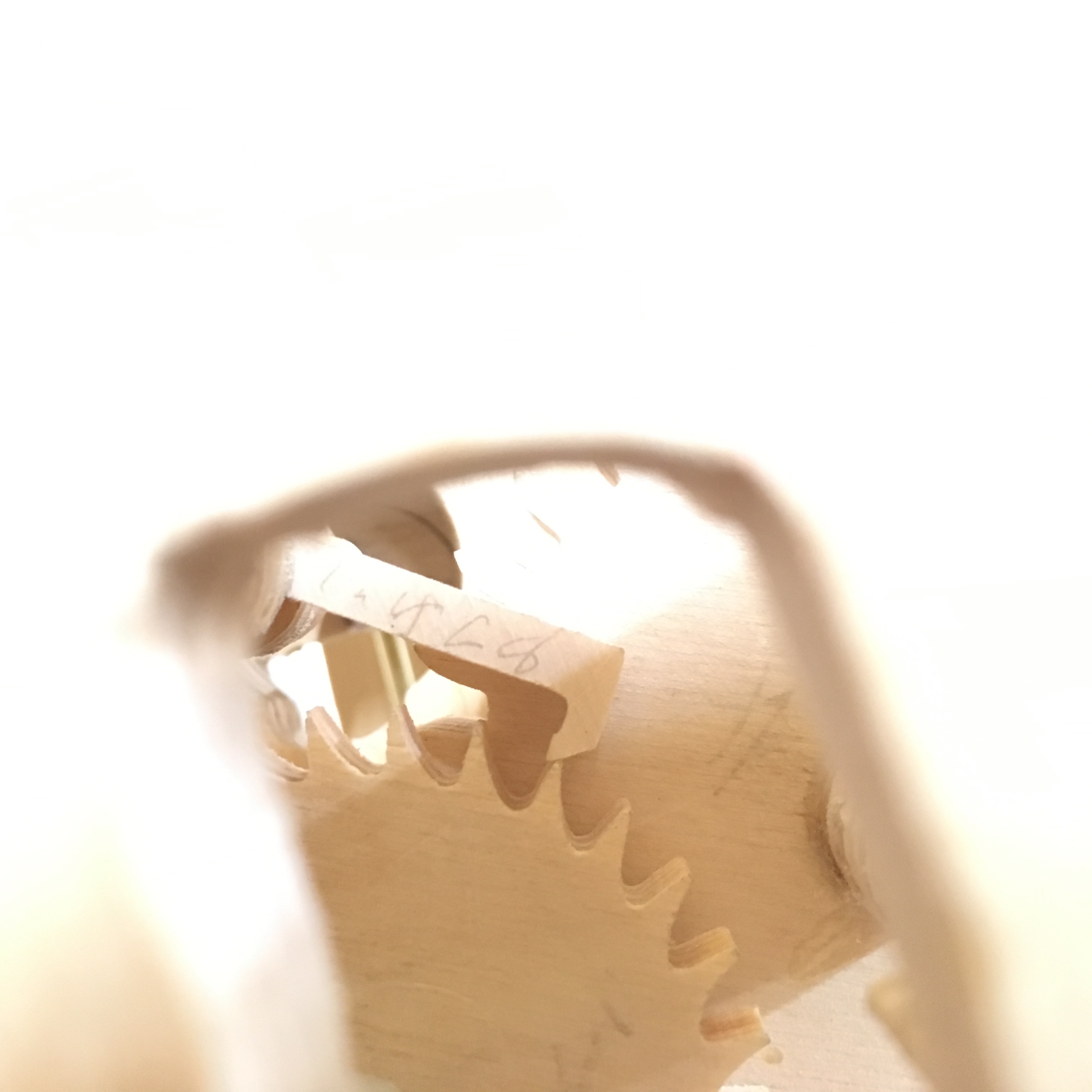

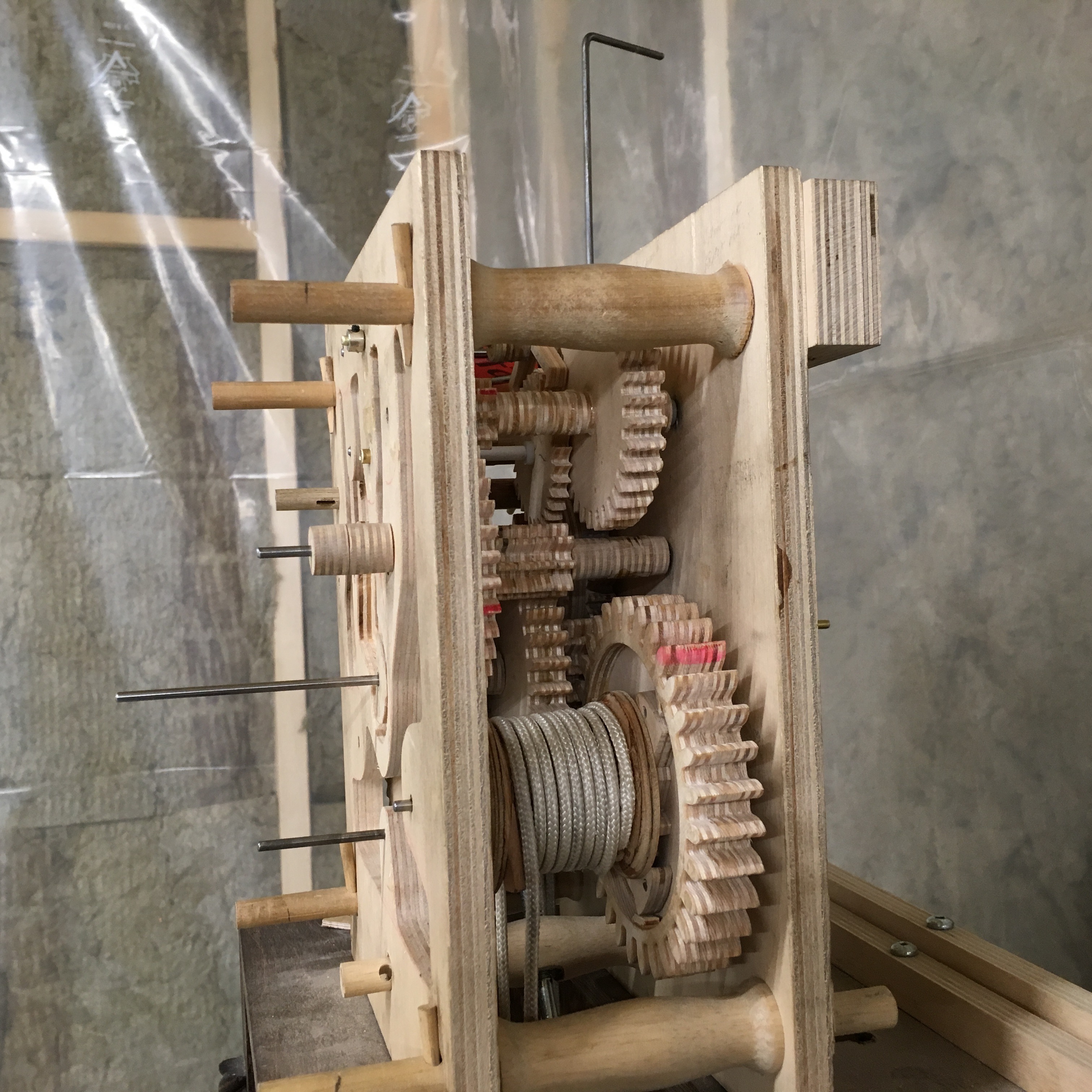

Thanks for the help. I tried to follow your arithmetic but was having some trouble. Upon looking at the formula or equation that you were using I could see that it was a simple linear relation and so I simply did a proportional change and achieve the magic centre to centre distance that I was looking for.
My Jesse now has a "re-engineered" time train using epicycloidal teeth and a new recoil escapement. The original gear set was cut on a band saw - (don't even be tempted). Anyway the clock is nicely ticking away. Thanks again.

cool, good work, looks very strong...
Yes, in most geared items, even escapements, simple linear transforms will give you the desired centers, modules ..

Since I work nearly exclusively in wood I have to make allowances for is weaknesses.
The biggest change I've found is in the tip relief of the escape wheel. If I go less than 1.5 I find that while some of the Baltic birch plies are fine others that are cross grain will chip off making the tips weak overall.
So although it's a bit clunky they are reliable at 1.5 (mostly).
I have another escape wheel project and I'm looking forward to it now.

Yes, tips are the issue. not too bad in hardwoods, but in plywood it can break then easily. I was thinking of making a glass
escapement ..for that tinkle sound on a tick , but I can imagine thats even worse than plywood. :)
