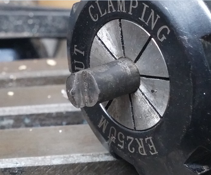

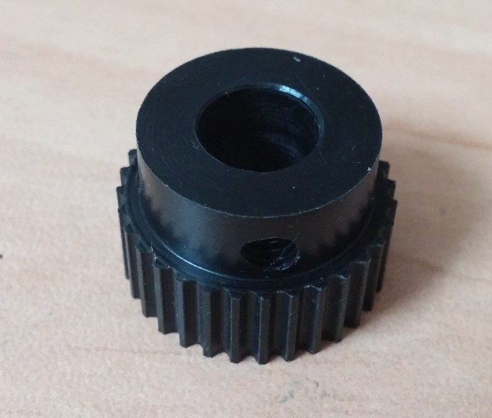

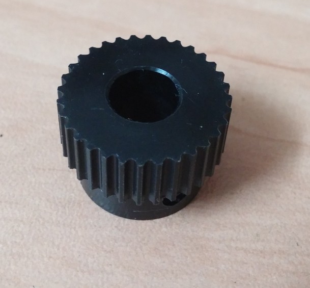

Used the DXF output from Gearotic to produce the profile of the tool which I then used to turn the tool on the lathe. My lathe is fitted with a servo motor on the spindle, so I indexed the blank and cut the teeth. The process works very well! See attached photos.
Here is a short video of the process:
https://youtu.be/pojIXefH9tU

Thanks for explaining it Art and for the fix. And Kit, thanks for the drawing.
I just measured the thickness of a GT2-2 belt and it is around 0.5mm.
Art, did you also address the tooth profile error?
