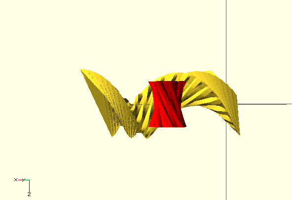

ArtF wrote: ... Trying to imagine the algorithm that generates the profile is a touch painfull.. like a headache starting way back there.. :) )
My initial thought about the hypoid worm thing didn't turn out to be true,  I'll have to try something less optimistic about the meshing.  I did get this nifty rack and pinion thing along the way:
Posts: 4649
Re: Is There a Fundamental Difference Between Hypoid Gears and Worm Gears
lol
