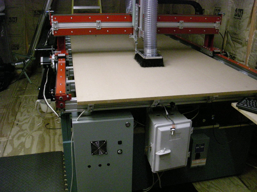

Also look at CNC Router Parts designs...cncrouterparts.com
I built the CRP4896 Router 2 years ago (960 oz-in steppers with 3.2:1 reduction, Leadshine digital drives and a 3hp water cooled spindle..
it is very sturdy and has performed flawlessly...
I have about $6 grand invested.
I can cut large gears with no problem..
This is an early photo after completion...

Nice table. Looks powerfully built and well designed. Extrusions really
are great ways to build tables, I wish they had been around when I built my first table..
way back when..
