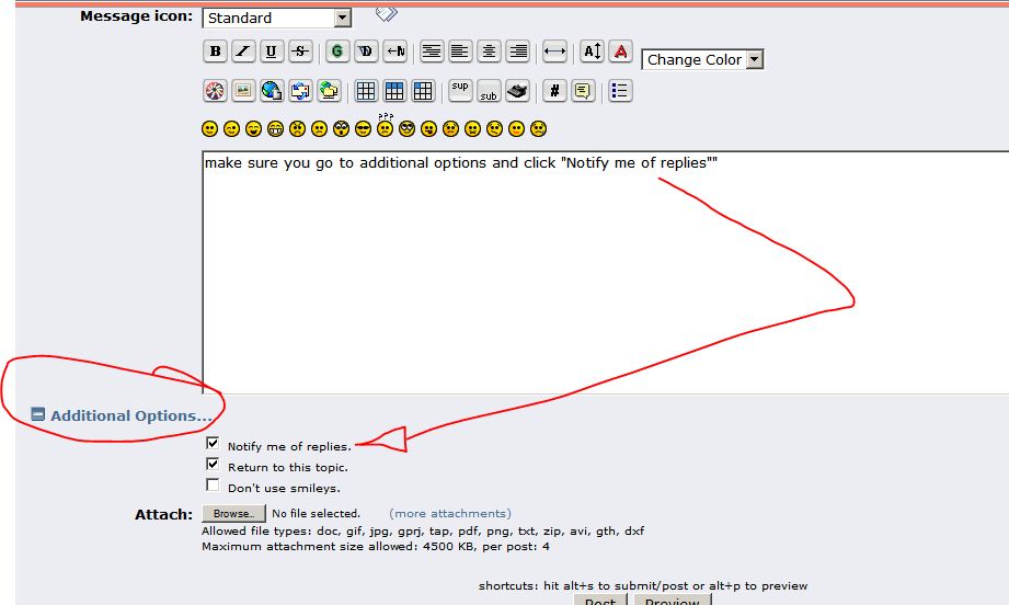

Re: A new set of questions
make sure you go to additional options and click "Notify me of replies""
Hi there Ya-Nvr-No,Ya-Nvr-No wrote: make sure you go to additional options and click "Notify me of replies""
I've been doing that each an every time I post since realizing that "Notify me of replies" (originally populated when setting up my profile) has failed to work.
Thanks however for taking time to suggest that option. Several years ago I had this issue and was required to do exactly what you've suggested until the site administrator got things sorted out at the Forum's end. The difference was, unlike currently, when I used your option it worked. Eventually this will get sorted out. Another issue I'm having is, after the current field (window) in which I am writing is filled, I am unable to enlarge this window to write more. The "auto scroll" in this window will not allow me to see what I am writing when the window is totally populated. In view of that, I write everything in MS Word then copy and paste into this window.
Once again thanks for attempting to help. :)
Harold
odd it worked for me, ??? see... Ya-Nvr-No
hope ya get it straightened out.
Well son-of-a gun!!! It has begun to work. I received your notification.Ya-Nvr-No wrote: odd it worked for me, ??? see... Ya-Nvr-No
Harold
Sweet, guess it just needed some loving or a little exercise.
I'm happy with all. Maybe the window, in which one writes, will "right itself" soon.Ya-Nvr-No wrote: Sweet, guess it just needed some loving or a little exercise.
