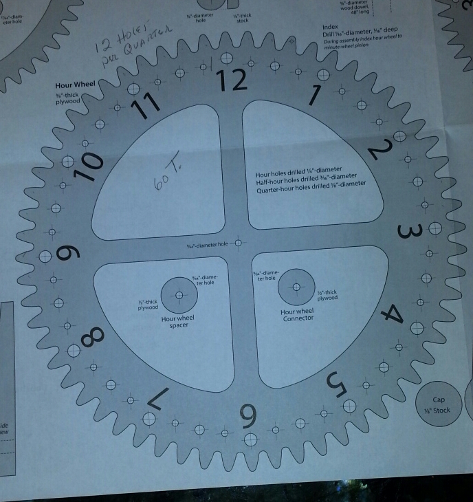

Huge question:
Can I make the gear in the attachment, including all those different
sized drilled holes in Gearotic???

For that youd need CAD. Id use Vectric for example, I load Gearotics gear DXF, then add drill holes.
Eventually, youll probably be able to do that, but till then , youd need a cad/cam program
to add such features.

I only have a paper copy, no dxf file for this Genesis Clock from Clayton Boyer.
Would Vetrics' Cut to Desktop work, it is much cheaper than the Carve program.
I would have to buy more plans from Boyer in .dxf format.
(or just cut the gear in Gearotic and drill the holes myself)

Yes, Desktop is fine..very useful if you make Boyer type things... As far as getting the dxf's, if its a gear, you can probably duplicate it in Gearotic, just figure out its approximate DP and adjust till its exactly the right size. To do that, create a round gear with the right number of teeth. Then adjust DP or Module up or down till outside diameter is the same as the drawing... pretty close at that point..
How do I make the base circle smaller while maintaining the outside diameter?
I want the gear frame? to be wider to accommodate the hour numbers.

Dependsa what you mean by "base circle", try the % settings for Rim % and such in the top panel..
