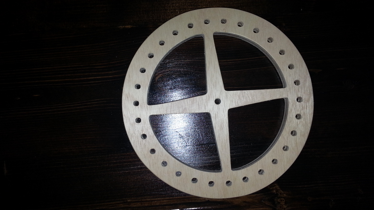

Is it possible to make a wheel like the attachment with
no teeth?

Yes, two choices. You can create a spur gear of that size. Once its in the tree, right click
it and select "Strip Teeth".
Second choice is to make a cage gear , the holes will then show up in the dxf as well.

I like the cage gear, how do I keep 30 holes but increase the size to 7.75 inches.
RR
RR
Press the calculator button under the DP and Mod
