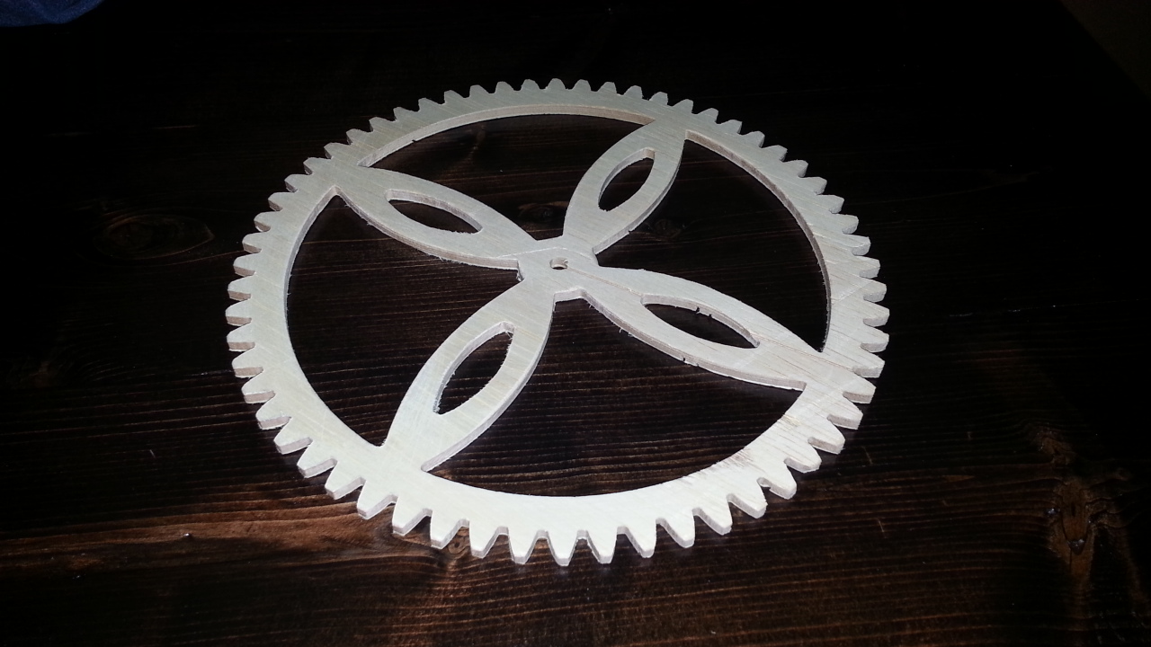

Photo of last gear......
It is getting better..........
RR
RR
Much Much Better. I cant even see any backlash. (but then I cant see backlash unless you show it
straight down shot.
Backlash causes round to be less than round. It can be on one axis or both, but your original
gear appeared to show it only on one. It may be the first gear moved a bit on its tape, you'll
notice backlash if you cut a circle. It should be perfectly round. If not, one of your axis
has a bit of backlash. If you'd like to test that, just select your gear on the project tree and select
"Strip Teeth", your gear will turn into a spoked circle , suitable for wagon trains.. and should,
if cut, be perfectly round.
(Nothing in life is perfect, it may vary a bit, most of us like to know just how small
or large that "bit" is. We can then fix it, or plan for it. ).
So , good job, all that reading is paying off, you and the Donald "almost" deserve the
treasure in that photo. (The car's nice too..)

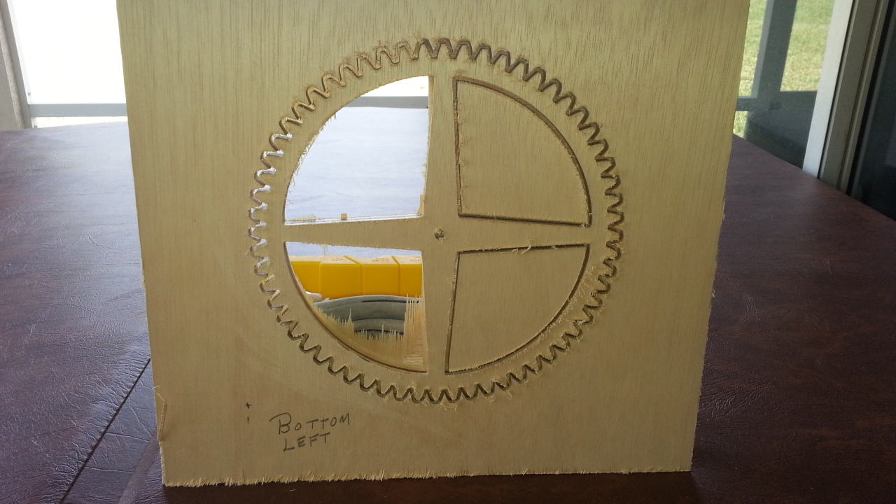

What causes this..........left side perfect, ride side not.....
I check all alignment on machine....seems good...
R
R
one side of the table is slightly higher than the other. Use a sacrificial piece underneath
and cut deeper than the thickness of the board..

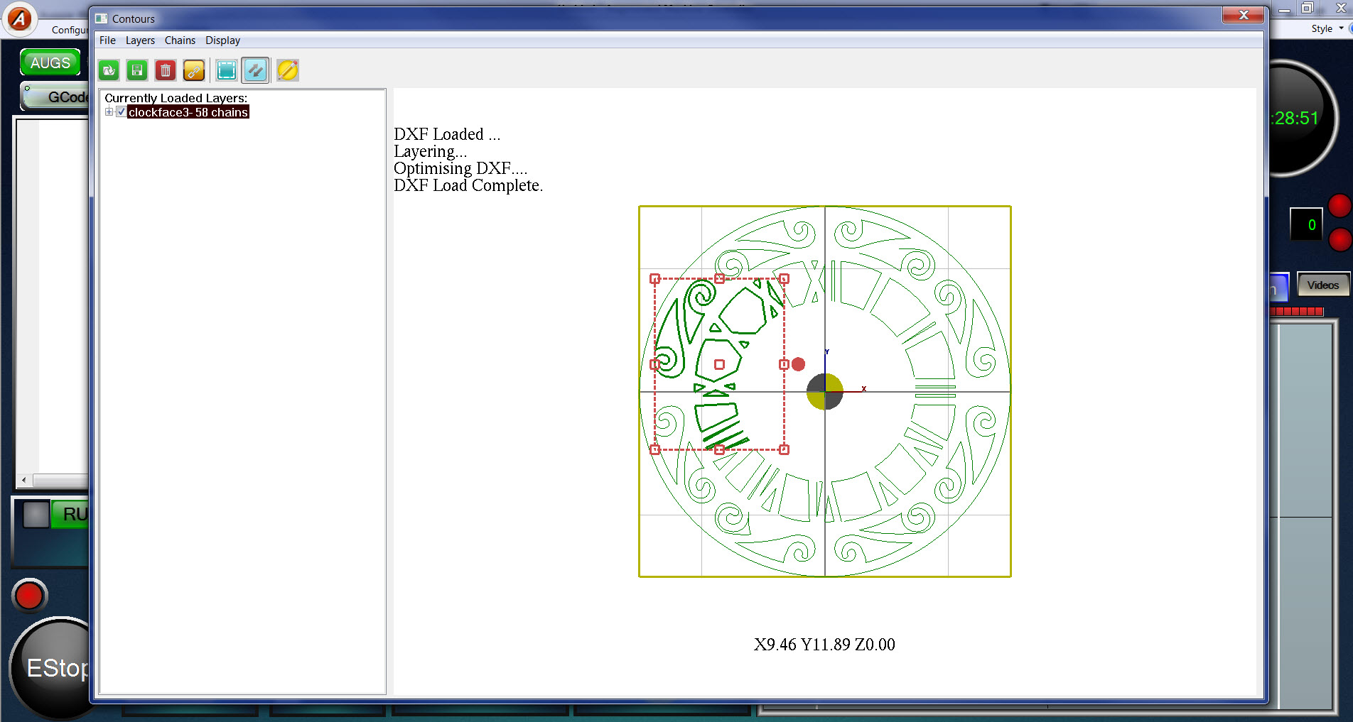

At the moment, you cannot import a dxf to generate toolpaths. Soon however, you can.
Auggie has now hit a point where its capabilities will start to add to Gearotics. Its now importing
DXF's here, and I'm adding editing and toolpathing to the loads.
Ive been lucky in that Gearotic is mature enough I could switch hats to a controller this year,
and though I am aware many will use MAch3 or other controllers for hardware and comforts sake,
it was my plan from the start to integrate functionality between the two.
So shortly, Auggie will load dxf's of any kind, allow you to join, move, swap and add vector data,
and post out as Gcode or other forms. This vector import will include GCode, so one can load Gcode
as a vector drawing, modify it, and repost it. Combined with DXF import, this will allow much more
power to the user in various ways.
So even if one doesnt use Auggie as a controller, they will still be able to use its CAD/CAM capabilities
in concert with Gearotic to do more.

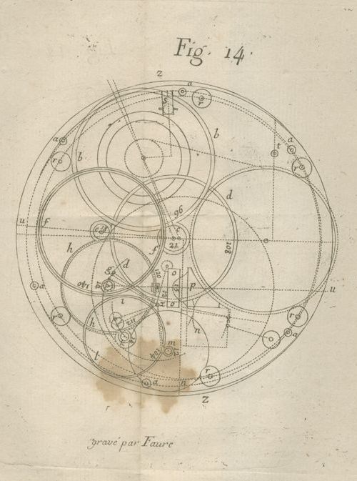

When I first started a Chronometer simulation project, I had a description of the chronometer and rough scale drawings of gear outlines (see jpg). I used a simpler program, a gear template generator http://woodgears.ca/gear/index.html, to get an idea of what the gears would look like. After I printed out the gear outlines and overlaid them on the drawings I thought that it would be cool to simulate the mechanism. That's when I discovered Gearotics and felt it would be a worth a try.
For the tower clock simulation, I had access to the mechanism and was able to measure gear diameters (or sometimes circumferences), tooth counts, shaft spacings, etc. and used the tools in Gearotics to build the simulations.
The resulting simulations are close enough for me to illustrate the workings of the mechanisms.
