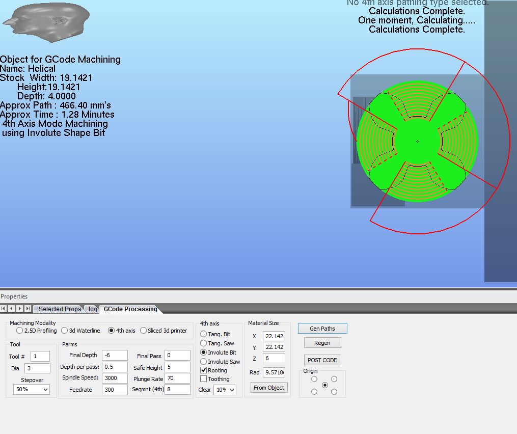

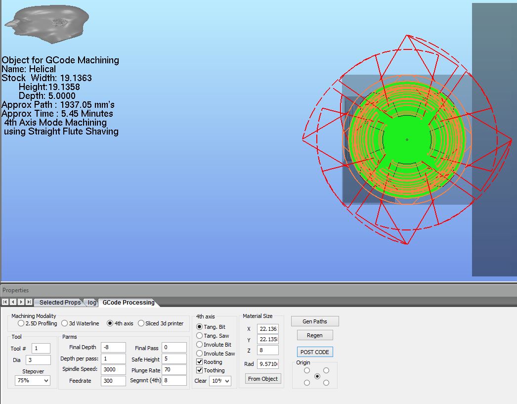

New version is now online. Heres a phot of how my test 4 tooth output looks. All numbers crunch well,
Ive blocked clearance from being able to push back beyond center, so the flank erasing shouldnt happen anymore,
(Im hoping that was it as I cant find any other excuse for why clearance increasing erased your flanks.)
Youll notice now the rooting doesnt try to cut outside the blank at all, the tangential passes no longer move the Z
at all, Z stays at the calculated base circle value. Im going to make that the true base radius for involutes, but since sprockets, pulleys and other types dont have base circles, Im hoping the AI works in that regard.But I dont mind doing code that recognises Involute gears for special handling..

Re: 45 degree worm M2.5
I can't see the photo. Also my 4 tooth rooting now shows the same tool path as toothing!!!!!!
Phil :)
Phil :)
Phil:
Sry, I fixed the photo..
Youll need to explain that one?
art
art
On rereading that I think I might see what your saying. But, urn off rooting and youll see
toothing is quite different. Its still the same tangential, but it doesnt move in the Z, the old one
was trying to move around the Z to match the tangent point, this one stays at base circle.. ( Calculated base)
which means it tends to keep the tool tip below the tangent point. Since it doesnt move, the path looks a bit
different, but its the same.
Tool paths are the same for Rooting and Toothing!!ArtF wrote: Youll need to explain that one?
Ooops my mistake, involute bit selected by mistake.

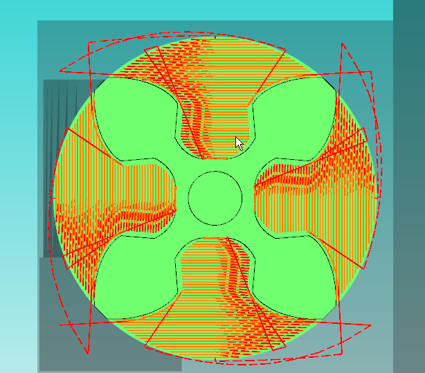

here's a very thin helical. Still seems to have that anomaly close to the tooth tip?
Phil :)
Phil :)
Its funny, I keep trying to rotate these images to look behind. :)
Switch to a non helical, its easier to see it properly, that mess is just the helical portion derived from having to
hang the tool in front of the blank.. If you use a spur or a .1 degree helical you'll see what I mean.. As the tool moves to the fron of the blank to cut the helix, it must be definition continue the helical angle past the front and rear, so the paths look bad and overwriting the profile, ( which is in the center..). All in all it makes it very hard to intuitively see whats going on. Switching to a very very low angle helical or a spur will show how close the path is to the profile.
Im of the opinion that there is no difference between helical an non-helical in terms of how they cut, but the non helical is certainly easier to see the path properly..
Quote "that mess is just the helical portion derived from having to hang the tool in front of the blank.."
If that were the case wouldn't the tool path pattern at least be uniform all the way up the curve.
Phil :)
Phil :)
Phil:
Youd think..but its another of those visual effects. What your seeing as non uniform motion is the delta of an involute angle amplified by the almost horizontal plane of the profile. Another optical illusion of sorts.
Im pretty sure about the helical angular code, which is the only difference between a non helical and a helical. Thats why I say look at the equivalent spur. The exact same code generator makes the toolpath, the only difference between the two is the helical angles added in. So if a spur works and a helical doesnt, it can only be the angular changes for helicals that are a problem, and since Im pretty sure about the helical angle, the only question remaining is "does a 4 tooth helical with .1 degree helix ( or a spur) cut properly".
Should a spur fail, then it points to one thing, should a spur work it points to another. The problem with looking at a helical toolpath is the assumptions youll make about the way it looks, which is very non-intuitive unless you think better than I in 3d space. The spur is much easier to tell and easier to see where its failing. Im still pretty sure the normal tooth count gears are cutting fine ( at least up to the changes Ive made for this problem..but even those shouldnt have affected them.). Its warming here, soon Ill be able to cut a couple myself to see where I can make things better. ( Christ I hate the cold..). In the meantime, if you test, Id test a spur of equivalent size, if its fine, the helical should be as well.
No optical illusions, it looks like the tool path in post #70. Its cut on the same blank from yesterday. Todays tooth flanks are at 12 o'clock and 2 o'clock
