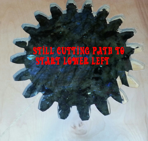

Thanks to you we are making great progress, see attachment.
I am still getting the "line" to start job being cut.
I guess I don't get why.
Can you fix the g code in the attachment to stop that from happening?

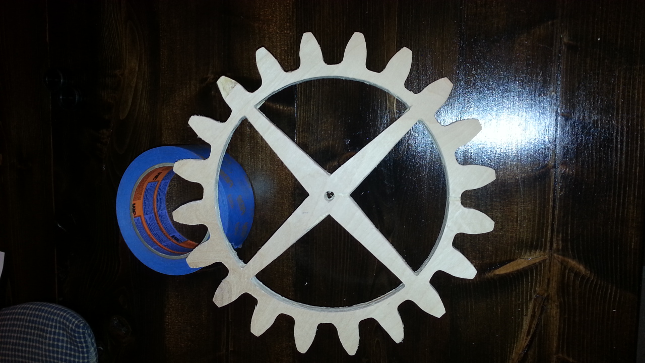

This is the best so far.....I had to redo all bolts and nuts....realign and tighten belts...
Working well now...
I am now using only Gearotic and Universal G code sender....only 13 minutes to cut...
rough and needs some fine tuning....

Rocket:
Well done.
I think your at the point you need to edit the files yourself and test
to see why its dragging on the material.
Here's the first few lines of your file..
( No Prolog Set )( GCode Objects Begin. )
( Object Spur20 Unv gcode and gearotic Begins )
G20
G0Z0.25
( Shaft Hole path - Inside Profile )
( Tool --: EndmillInch1-E-R0.05-T0.0-F0.0 posted as T5 )
M5
M6 T5
M3 S1750
G1 Z-0.050 F50
Any lines with " ( or )" are comments, ignore them
G20 means enter imperial mode, it should be first
G0Z0.25 means raise Z to .25 ( so it shouldn't be dragging.. )
M5 means to turn off the spindle had it been on..
M6T5 is a toolchange to tool #5, ignored by your machine..
M3 S1750 is turn on spidnle set to speed of 1750..
G1 Z-0.050 F50 , and this line is dropping back down..
G1 X5.724 Y5.512 F100 //and this is moving to center, dragging through the material,
The obvious solution then, is to not drop until you
move to center..
so the two lines above should be..
G1 X5.724 Y5.512 F100 /move to center FIRST,while still in the air
G1 Z-0.050 F50 , and then dropping back down to start cutting.
That will fix your trouble.

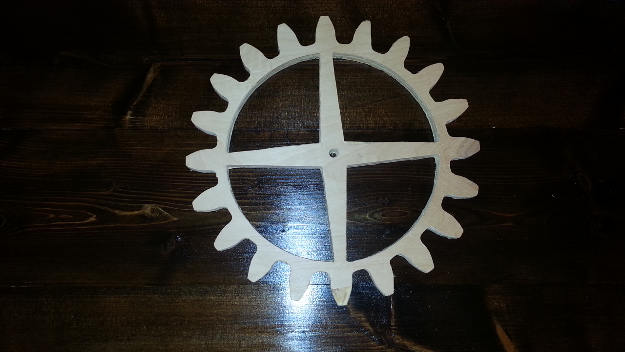

I made the gear below in Gearotic, created a tool path in Gearotic, and then used Universal
G code Sender to the Shapeoko.
5/8 inch plywood, .25 end mill, 15 passes, and Voila.
Still a little rough, but my greatest job in 3 weeks of trying tons of software and files.
Still have a problem with some of the g code, as to placement and cutting a line
