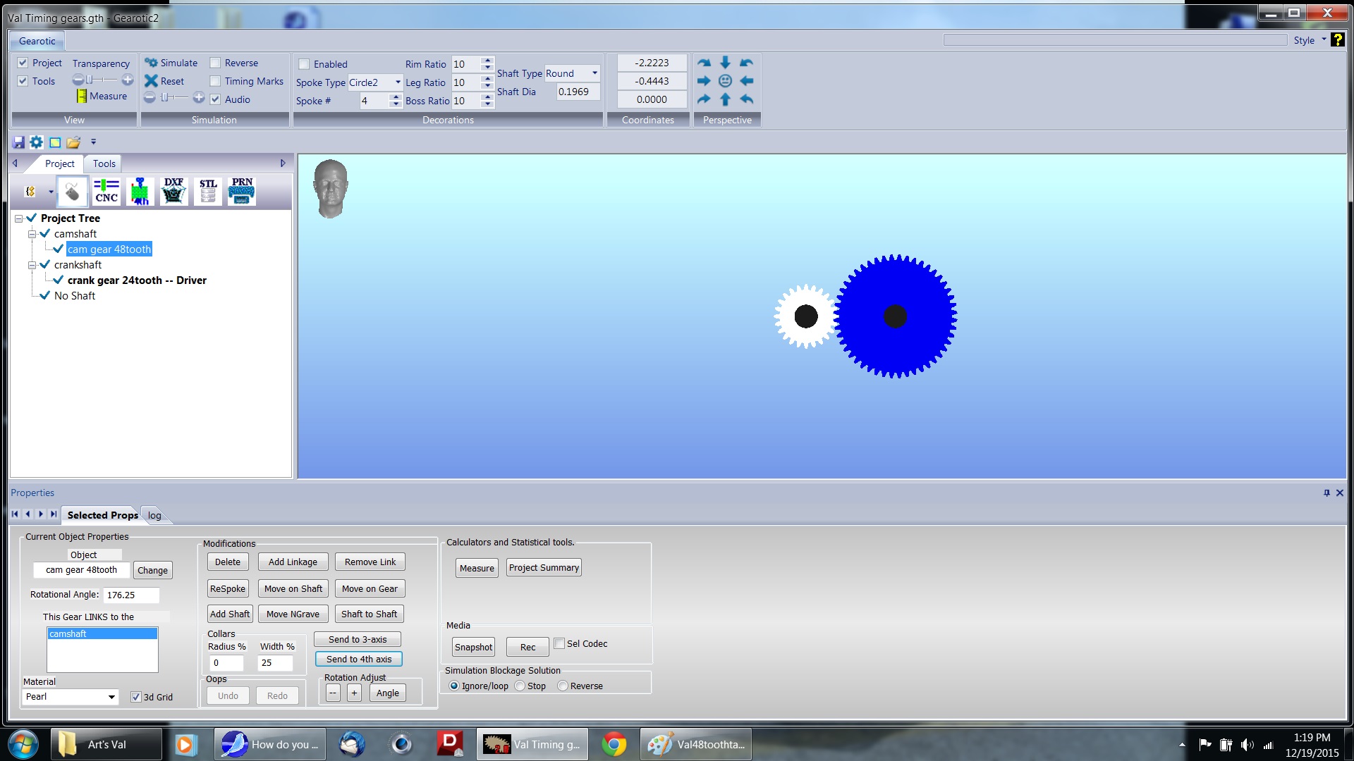

Just so we don't get confused over terminology, it looks to me like we are discussing two issues,
1) A graphics issue where the tool appears in the center of a tooth so its hard to see if its cutting properly, and
2) Whether the tool is too large or not.
on 1), I cant seem to repeat this so long as a gear is selected as driver. If I then send one of the gears to the
4th axis for machining, the tool is starting dead center in the tooth space on mine. Is this the case on yours now or
is the tool in the middle of the tooth still?
on 2), the tool I tested with at .017 seems to Just Fit.. not much room , but seems to be able to do the job.
Which of the two are we talking about when you say the tangentals are in the tooth. Its the nature of the system that if rooting is properly starting in center of tooth space then tangental must as well, so are you saying rooting looks good, but
tangental is being pushed into the tooth as opposed to starting in center of it? As if the tool is too large?
Not unusual in this type of thing for terminology to be a bit of a devil for support...

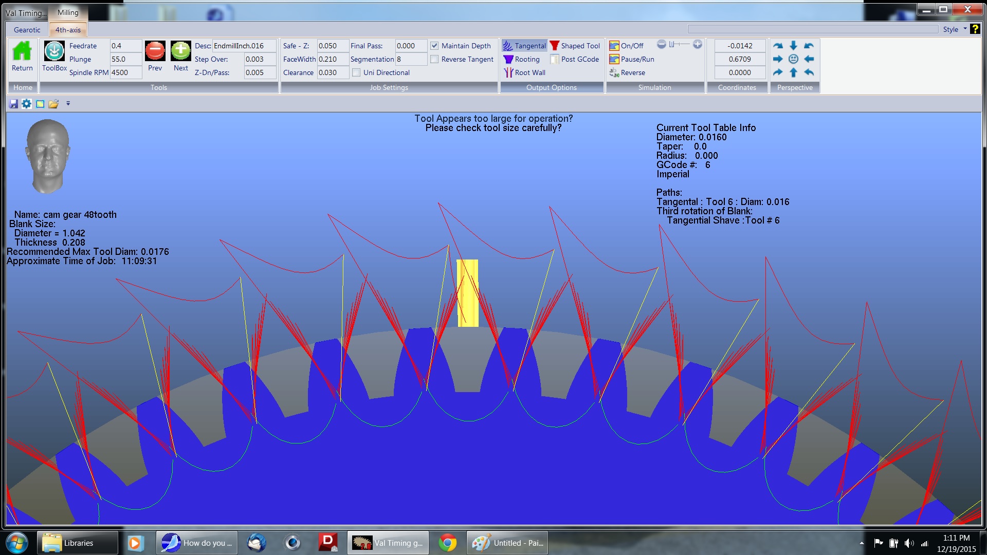

I've taken some screen shots in hopes of clearing up ?'s. Yes there does appear to be two issues as you have stated. I went into the tool box and changed the stepover to .003" left the depth of cut at .005, I am using a carbide .016" two flute end mill I don't recall of the top of my head what the depth of cut was but set that as .048". Previously I had gotten the root wall pass and the tangental pass with the origin in the middle of the tooth not the gap between. The first shot is the home screen before clicking on the move to fourth axis button. I then did the screen shot after sending it to 4th axis and before the message disappeared. I then added the rooting (which didn't tell me it was to many passes) and the third shot is that one. I hope that this gives more information than I could impart by typing :-\.
Today the rooting operation not only works right but in the right location as well.

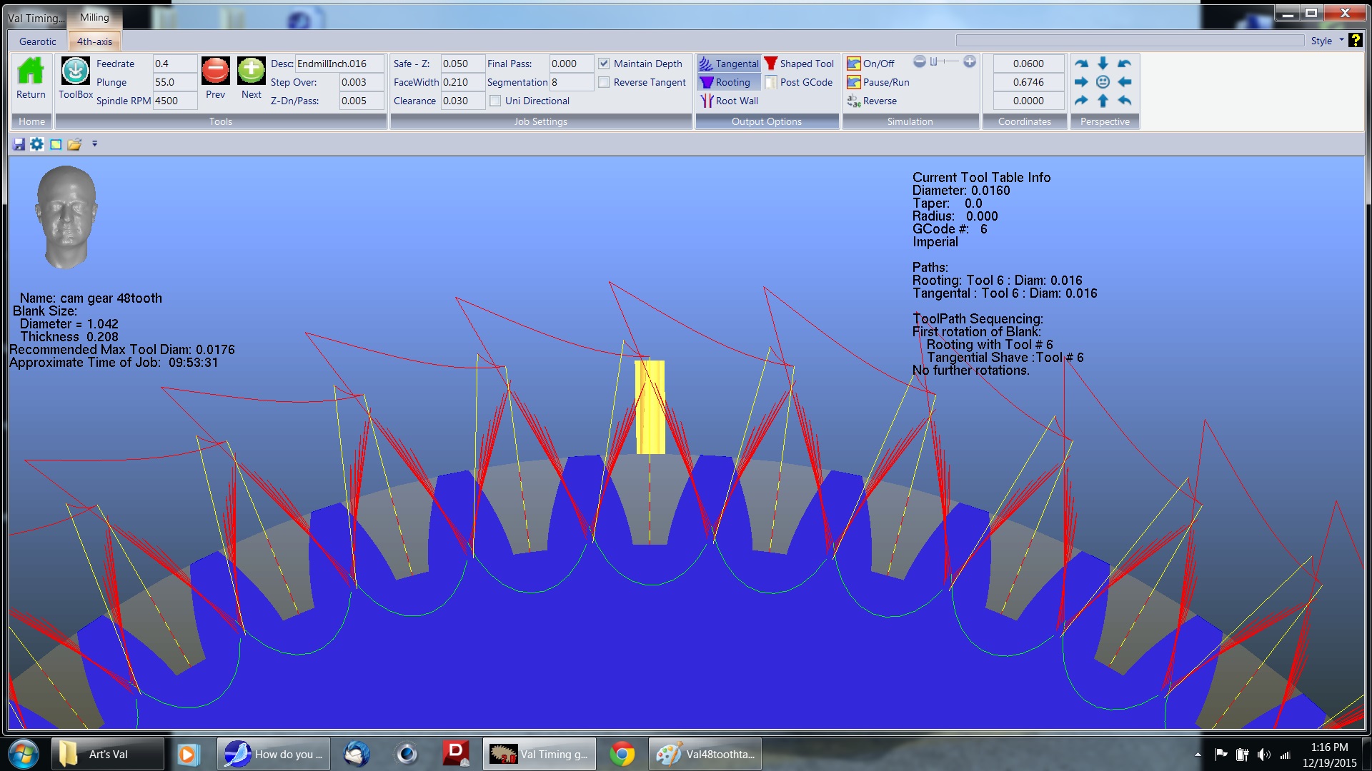

Two photos for you on your job. One is with no clearance set. Clearance tells the tool to keep away from the
actual gear by a set amount. Notice when set to zero, the tangental run is in the center of the tooth. This gear is SOO
small however, that the clearance of .030 taken form your snapshot, as compared to the tool size of .016, tells it
to stay 2 diameters away from the wall, this moves the path to a point just about center in the tooth.
Set Clearance to 0, and your problem should go away. Sorry it took me awhile to diagnose this, I dont
often deal with such small gears so didnt notice the offset setting used.
Re: Cutter to large?
That did the trick. I hadn't noticed that setting, when should I use something in that setting? When I have a larger gear and want a finish pass? Thanks for your help! when I get home I'll try to cut it.

Yes, if you do a pass in any technique with a roughing tool, its there to keep the tool away from the walls, OR to make a
gear with slightly wider teeth. :)

several times with decreasing clearances..each time less will be taken..
Id suggest you toy with the parameters, and check and uncheck the tangental each time to get a clear
idea of what each does. Its very graphical, and the simulations show what "should" happen, so when you
snap a tool its best to check if all is OK, before just going to finer passes.. Breaking bits in tengental
shaving should be a fairly rare occurance.. except with very small tools, then it can be a complex dance to
get things right..
The step-over should have been exactly as you specified. BUT, again, on the screen under the tool description, is
an override. This is there so you can quickly set any step-over and change it from operation to operation.
Repost the job, but while your doing so, set the stepover override, then uncheck rooting and recheck it. Each time
you uncheck and recheck the rooting box, the job is replanned using the onscreen settings. (Make sure you hit
enter after typing in a new number and before unchecking and rechecking rooting. ).
Do this with larger and smaller numbers and observe the result on the screen of the rooting path. Notice how tight
or loose the passes get together as you enter smaller and larger numbers. Get used to seeing that change so your used to
how it affects all operations. This step-over overrides your tool step-over but only affects the rooting though, for the number
of passes during tangental use the "segments" setting.
Tangental shaving isnt really a stepover, its a matter of dividing the angular change by an appropriate number
of shaving passes. How many you need depends on the gear and the tool, but generally, tangental doesnt take much
off each pass, but in very small tools even that much may be too much, so if you want more passes to reduce
the amount of edge taken each pass, increase the Segments value and uncheck and recheck tangental each time
you do to see the effect. Youll notice the more segments, the finer the passes and the less material removed each pass,
this isnt stepover, but more an angular division.. and so is labeled "Segments".
Take note Art, its not uncommon for a person on their first gear to have their A axis turning wrong
direction, this is because few CNC systems actually have their A axis direction set to any standard.
Make sure, ( run in the air), that the rotary is turning as in the simulation. If it isnt, it will snap
bits every time.. and its not obvious always, Ive had several people cut entire gears in reverse
without knowing why the gear looked so bad..
The rule, is that if you look back in minus direction on the 4th axis parallel axis, and rotate positive (A++),
the gear will rotate CCW.In better words, if your 4th axis chuck is facing X++, and you watch the chuck
from the X++ looking X--, it will rotate CCW if you go A++. This is the standard for rotary axis, but in
my experience almost 50% are set backwards.. youd never notice except in something like tangental
shaving..
Now, as well as segments to lessen how much the tool takes, you can also, in the case of very small
tools, set a clearance and cut the gear with that, and then cut with no clearance, ( or in extreme cases, cut
get things right..
I went out in the shop and fired up the machine and sure enough the A axis was reversed. After spending quite a while on the phone with the tech guys at Tormach I think I have that sorted out. I had to go and reverse the wires on a few drivers cause they were backwards. I have an early Tormach mill and had to install the 4th axis myself. That doesn't explain why all the other drives ran backwards from the pendant though. My machine is early enough that a lot of it was still in the development stage. And they didn't have good records of those original setups. I think I will need to make a new blank for the gear. The lines in the gear that I initially thought were caused by the broken tip of the cutter are actually separate passes of the cutter, probably .040" deep. That little thing was tougher than I gave it credit for. I already know it will do the roughing pass I might forward it to the tangental portion and see how it looks there.
Art K
Art K
Thats good news anyway. As I said, its not unusual at all for a machine to rotate A in reverse, most dont know
the spec for it and its rare to use a 4th axis in this way. The code form the gear cutter has proven to be pretty bulletproof
over the last while, Id say the only real reports of trouble have been the rotation direction, as its not very intuitive
when its wrong. Seems right, just snaps tools. and only in tangental phase..lol
Hopefully your now off to the races.. Let us know how your gear looks, I think you'll find each one gets better
as you get used to how it all works..
