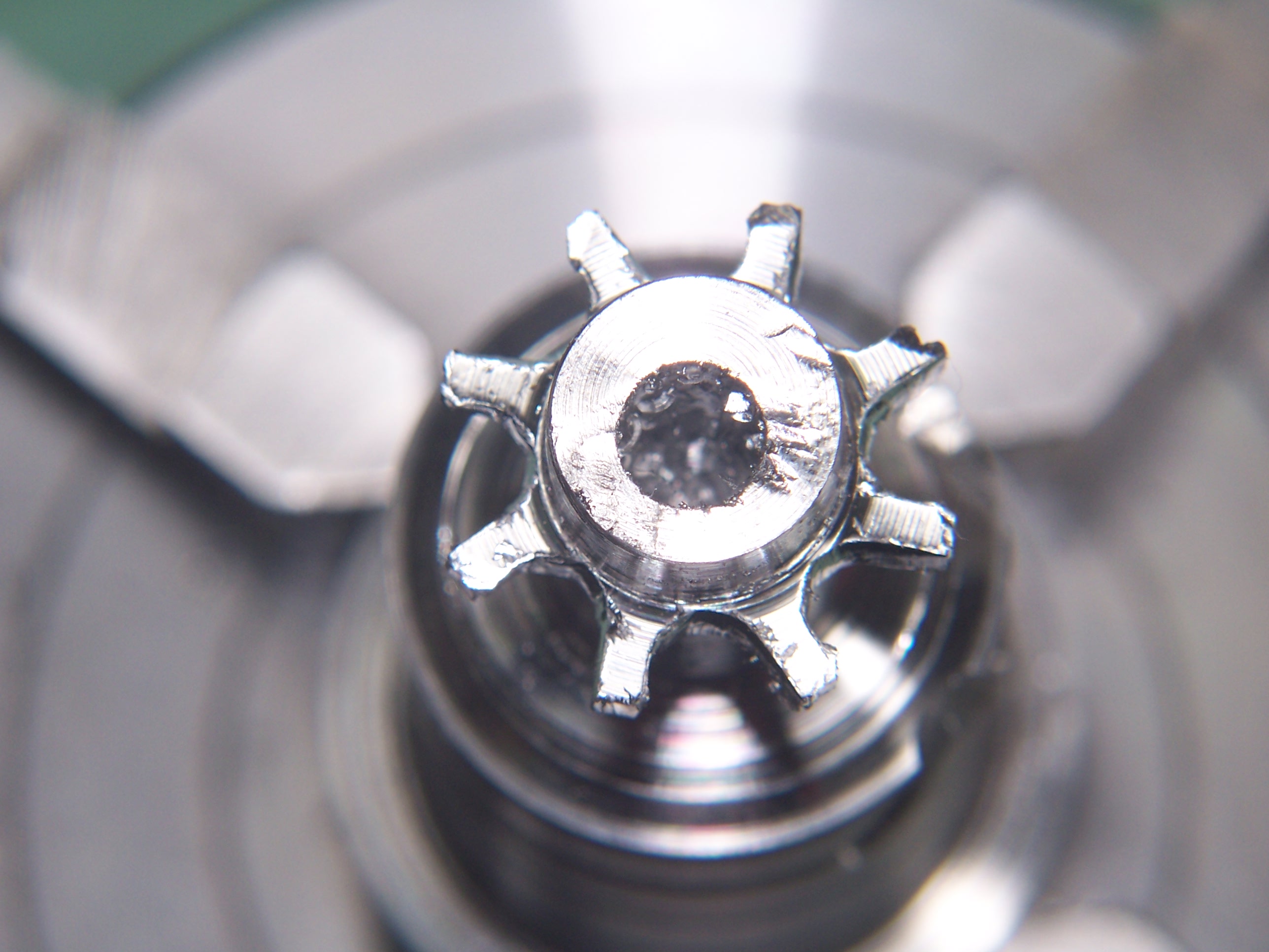

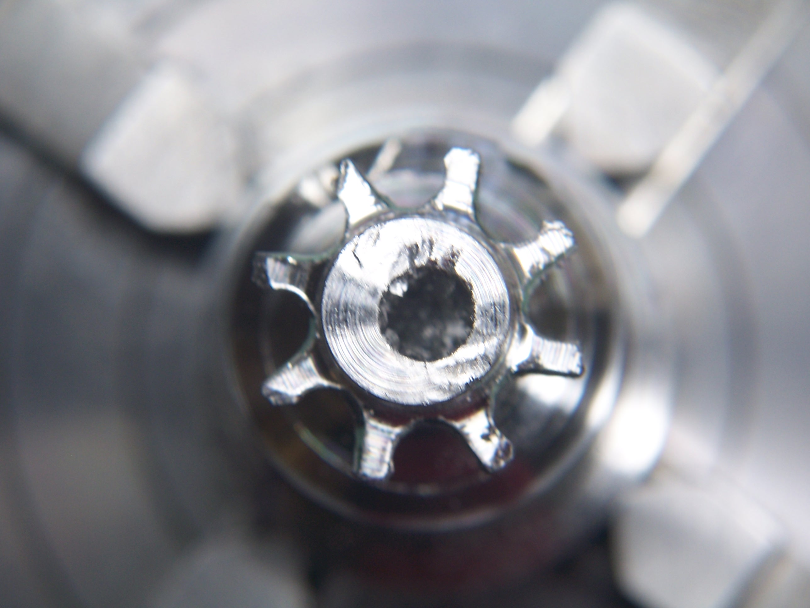

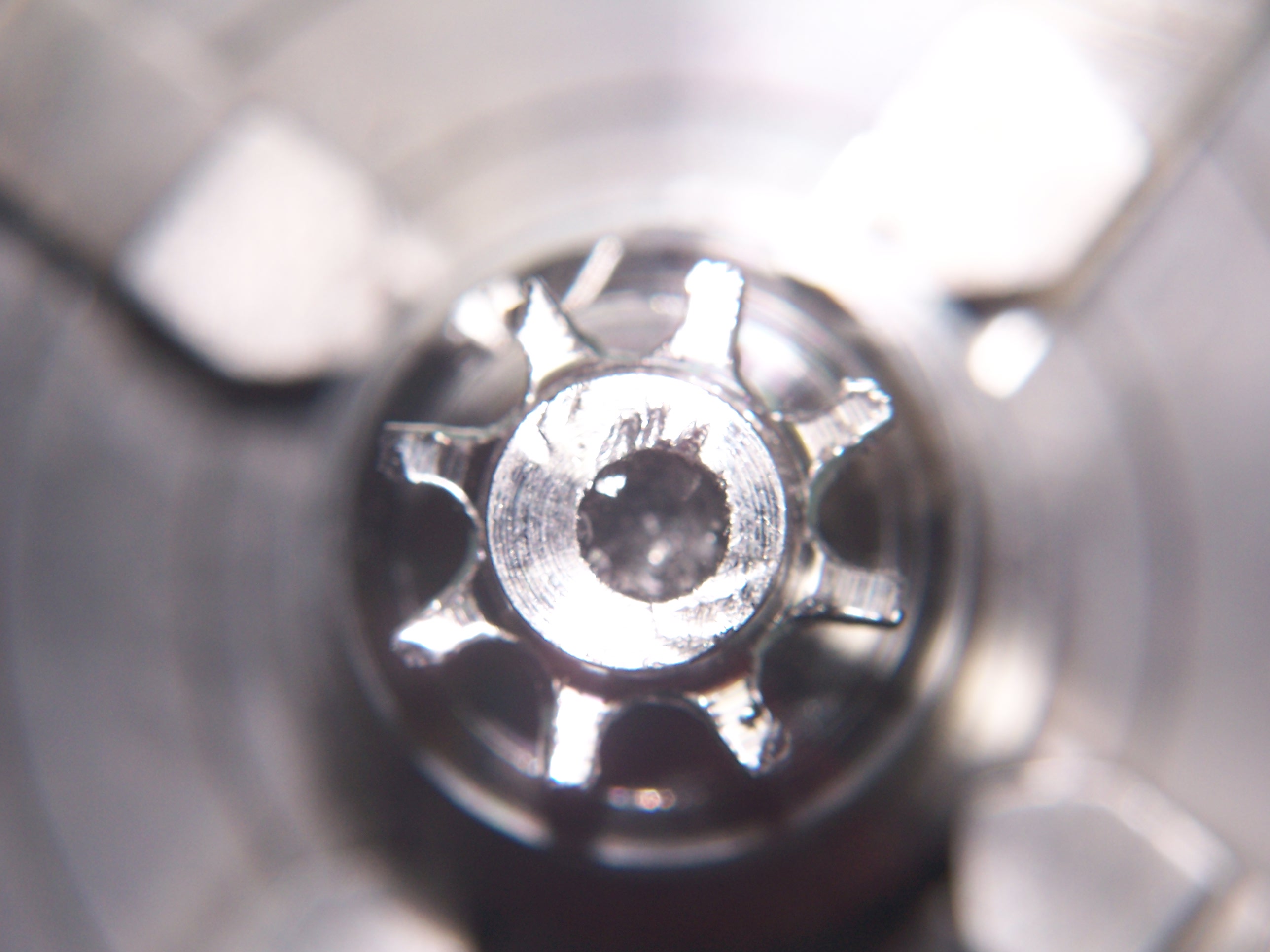

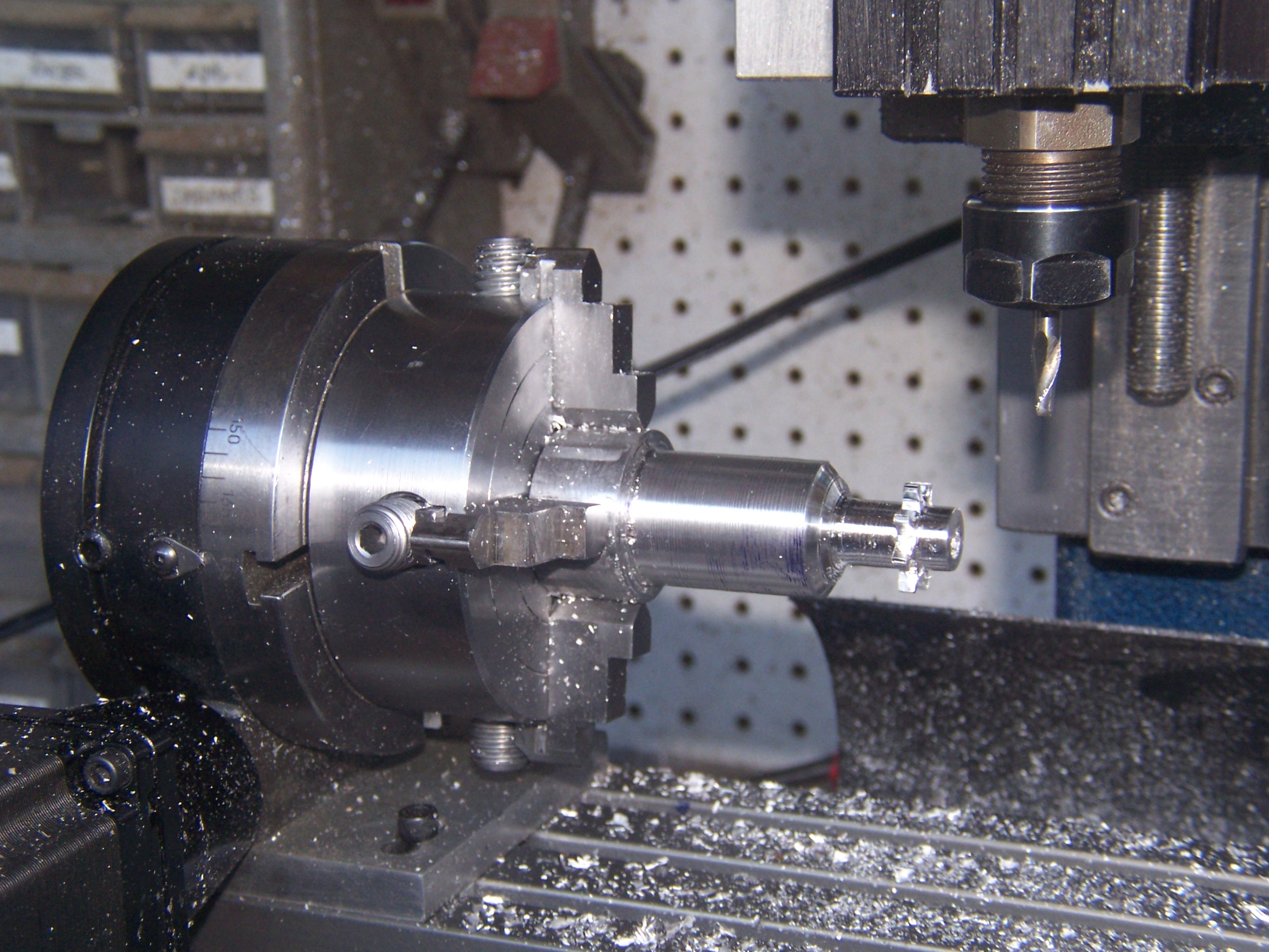

Did another test and it's truly scary. I divided the program into two portions - the roothing portion and the toothing portion.
I ran the rooting portion with no problems. Made nice little shallow cuts at .05 depth on one cut and .1 cut on the next using a .185 round nose bit. Not as deep as I wanted but spaced OK.
Ran the toothing portion of the program. It starts, indexes and then immediately drops the z axis to .3 inches down, cuts across the material and then does nothing but cut air for the rest of that tooth. Repeats on the next tooth with that .3 deep cut. After going one way around, it does the same cutting pattern in reverse - one deep cut and then it moves up and cuts air the rest of the time. Perhaps my bit is too big and leaves nothing for it to tangentially cut? If the bit were smaller, that first cut would snap it off. I may try again tomorrow with a .125 end mill and see if it leaves something for the tangential cuts.
Attached are pics of the result of today's experiment. Ignore the off center hole (different experiment).
Steve
Steve

That does look like too large a bit to do it.. Ill be doing some changes to the rooting for tomorrow.
Ill see if I can make it trigger a stop if it senses the bit is too large..

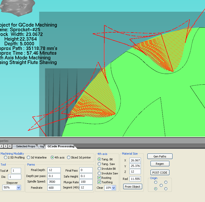

I notice in the program that when I play with the bit size, a little green bar appears in the simulation. I was assuming that was telling me that the bit would only go down to that point.
Steve
Steve
Re: Trouble with 4th axis
Steve:
Not sure what Green line we're speaking of..
Here what the path should look like . ( Press the left arror perspective to this view..)
Steve:
Take note in that photo of the trouble in making a sprocket in 4th axis. The tangental shaving can work only when the tangent angle is above PI. So only the top of the tooth is tangentally shaved. The rest is up to the rooting, so youll get many stepping artifacts o a sprocket cut with a flute. Sprocket shaped flycutter is probably the only way to get a really good sprocket profile..
