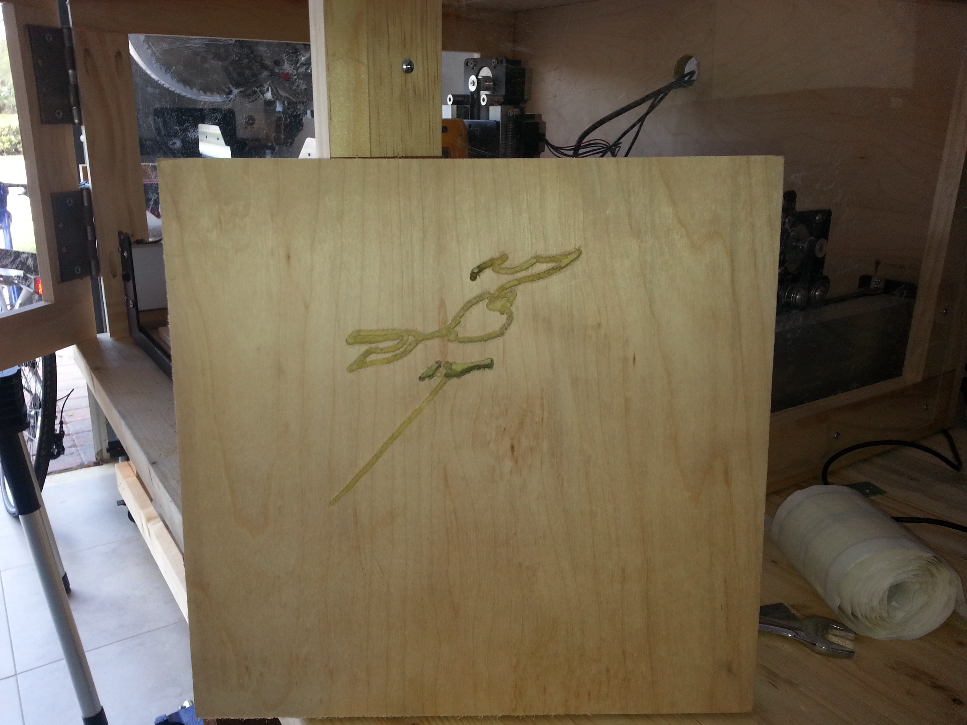

Thanks....RR That is a photo of my last table build, before getting interested in CNC...

Re: First test gear today
Art help...
Made a gear in gearotic...2 files attached.
Thought is did everything right (see attachments)
The photo is the mess that came out of Carbide Motion.
What is wrong???
Attatchments 2 files
one photo
Thanks RR............
What is wrong???
one photo
RR:
Your gear and file are good, so your fine to there, BUT.. Im thinkiing your machine cannot handle F100, 100" per minute may be too fast for it, it looks as
if your steppers are stalling. Chane all the F50's and F100's to F10 and see what happens, then raisse it to see where it screws up and starts wandering again.
The result looks very much like a machine stalling on its steppers.
If you purposely zero in the air, so it doesnt cut the wood, does it appear to follow the path? Does it only go wandering while in the wood? Focus
on the machine, the command file looks good. Does this machien cut anything as of yet? Or is this your initial testing of it?
