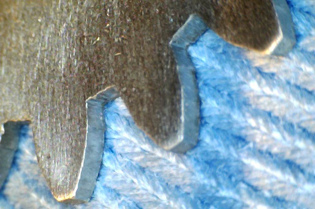

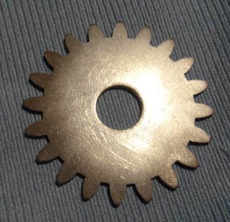

Reversed A axis rotation as suggested and proceeded to cut a trial gear of 20 teeth 2 module using the previous parameters.
I used just rooting and toothing and had no problems producing a respectable gear with no root walls.
Without touching anything (same blank) I ran again but this time with rooting and root wall no toothing, which ran correctly and finished the gear. I have attached a couple of pictures.
Considering the blanks are large washers from the local hardware store, the saw at least half past its best, the mandrel scrap brass sticking too far out of the chuck and unsupported (the last two to aid vision and photography) the magnified tooth view is surprisingly good.
So far no code produced giving wild swings of A and deep Y cuts. Next job to try all three: rooting, root wall and toothing in one file.
Now it is beginning to work as it should I think this method has true potential with fine saws for cutting clock gears in brass.

Those do look quite excellent. I'm going to have to get a set and try that out. How long did it take to cut those?

Hi SkyMoBot
Glad you like the gear, even if it is just an old washer the cuts do seem pretty good.
I ran the program twice on the same blank with different things checked as Art and I were looking at a particular issue
Feeds speeds were deliberately slow, X clearance generous; guessing if ran all three parameters together (rooting, root wall and toothing) it would have been about 2 hours.

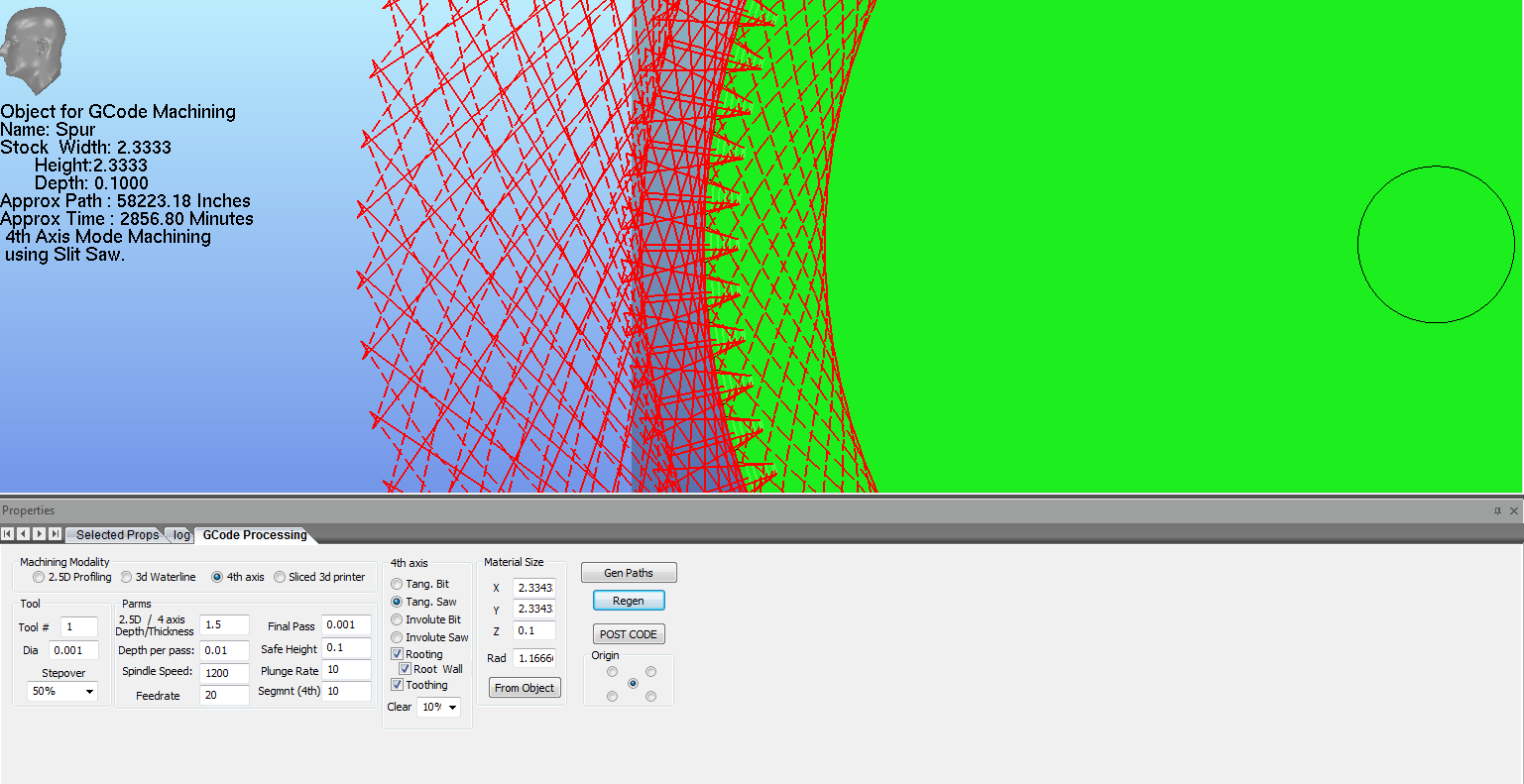

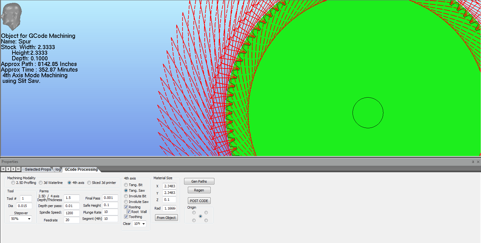

Re: Tangential Saw shaving 4th axis
First screen shot is the 96 tooth 0.6 module with 0.015" saw as requested. I regenerated the code and still got the A 90 degree and deep Y plunge.
Second screen shot is same but with 0.001" saw, code generated also has the A 90 Degree and deep Y plunge.
Hope this information is helpful
David
David
