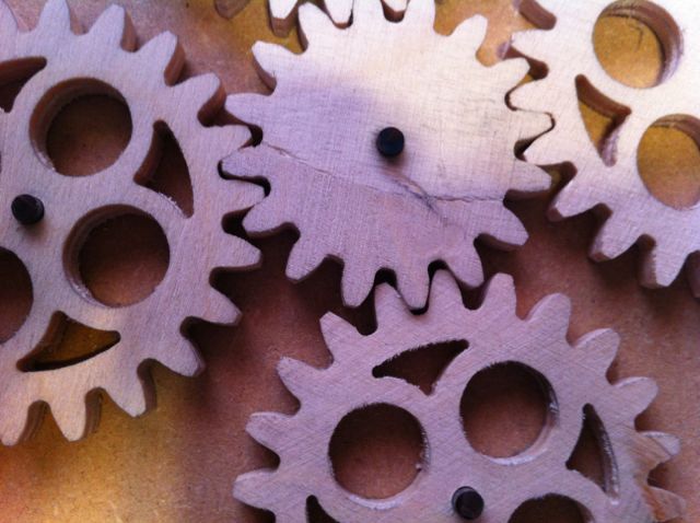

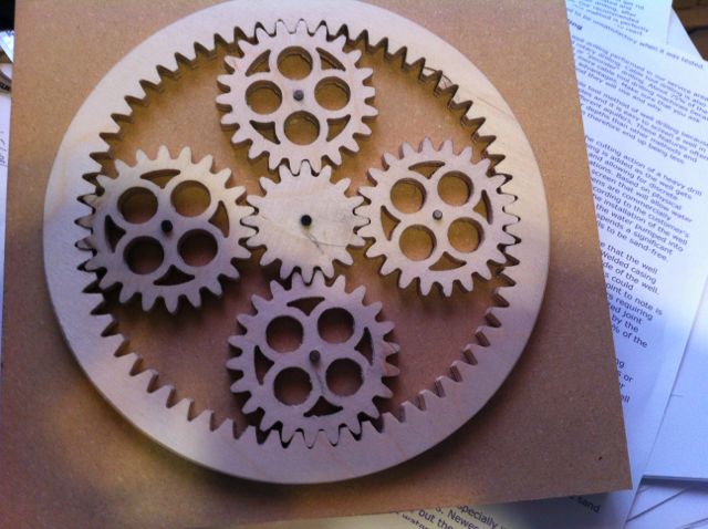

I've tried planetary gears before but without great success, so I decided to try and follow your posting.
The planetary works! I do have one question - as you can see from the photos the teeth are quite "pointy" and the sun gear seems to be points to points. Is this a function of the planetary button on the spur gear tools? I checked the epicycloidal and the involute and the only one thats active is the involute.
Makes for a neat model - but curious about the tooth shape,

Re: I would like to make a planetary gear with inner gears and center gear
Those teeth are far too small. Looks like youve added backlash and left it on, is the Width setting set to .5? Something is wrong
for sure, the planetary I described should work nicely and tight fitting as an involute. Looks to me as if you tooth profile is being crushed..

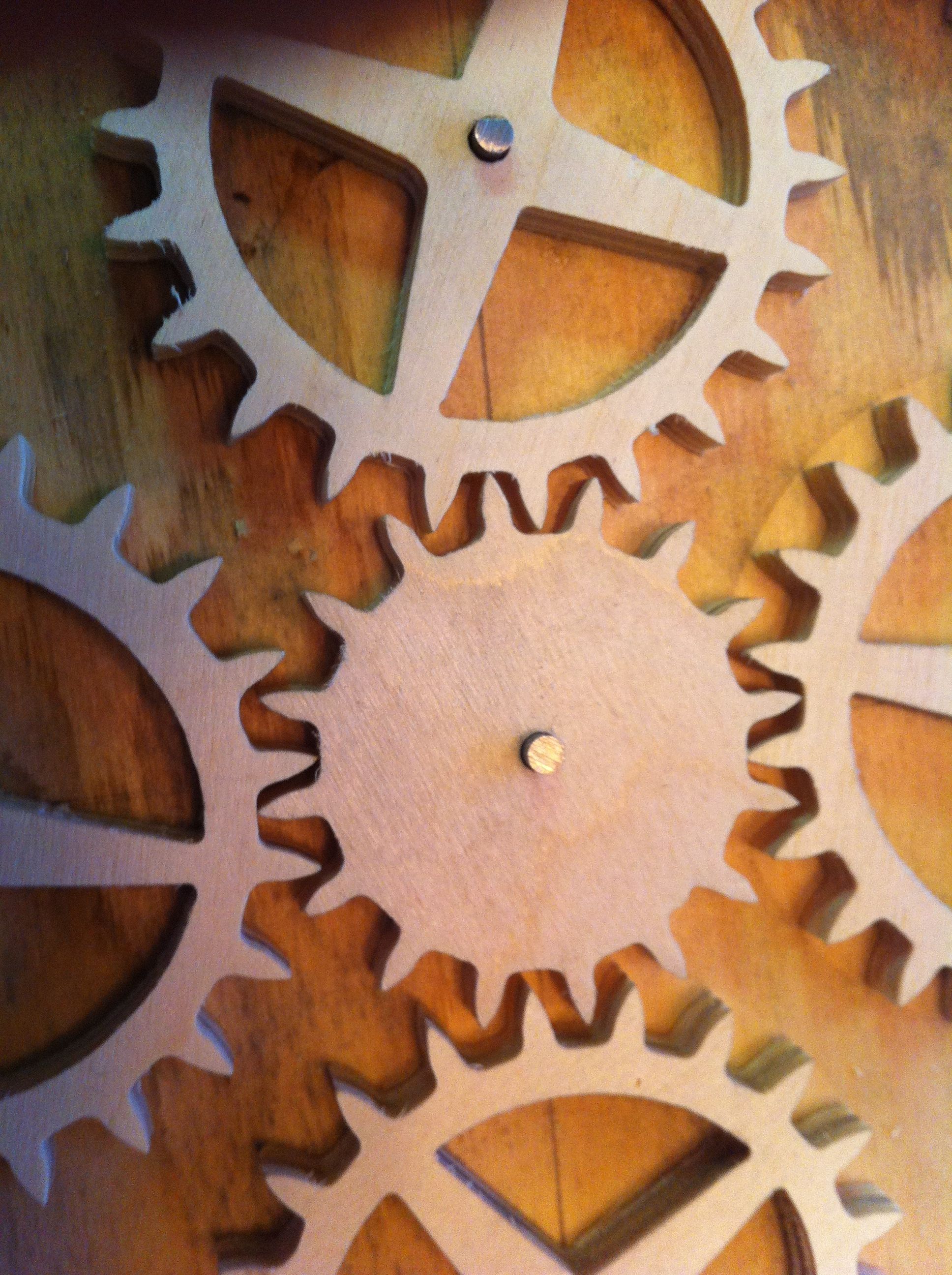

I went back to the design and didn't discover a backlash setting it was as 0.5 never the less I reloaded the program and started fresh. This time it works as advertised. Must just be a gremlin (operator) at work somewhere.
Thx for the update, yes, thats much nicer looking. On the bright side of all this , youll now remember that if a planetary
is too tight for you, just slightly lower that .5 to like.. 0.48 and it can make things run much more smoothly..
