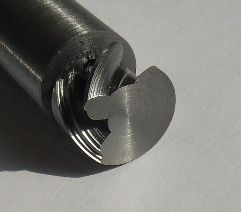

Hi Art, still seems to be the same problem. The lower tooth "space" has been run with rough and fine and on the upper tooth "space" I just allowed the fine to carry on and cut a second space with out any roughing.
I'll be away working until next weekend so no chance to try anything until then.
Phil :)
PS: using version referenced in post #27
PPS: the surface finish on the upper fine looks much worse in the photo than it actually is.

The z zero was within + or minus .03mm.

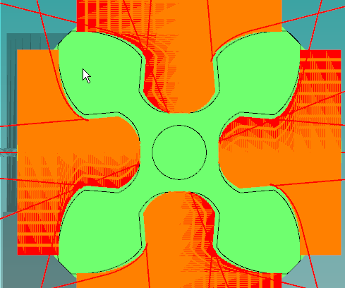

I notice in your spur gear screenshot that the line of the cut profile doesn't follow the line of the tooth profile but gradually converges on it, also it does still leave a small anomaly at the tip of the tooth, and both of these points are in common with the issues seen on the helical. Have you run that spur with a larger tool and coarse feed? Unfortunately I can't load gearotic to my employers' PC.
No, unfortunatley I'm not setup at the moment to run such a test so Im working solely with numbers. But lets discuss that photo and its convergance. The toolpath shown is exagerated of course as its very small step down, but in roughing there is no rotation. So lets just look at that spur gear. With no rotation the path above should generate a tooth shape just barely away from the profile at the top, but a bit further away at the bottom. The photo uses the actual numbers for position so in theory the shape above shows a very tight root for a tooth that will not rotate during the cut.
I did this for a reason, in early GM I had many people tell me I left too much on the flanks during the root, it caused the bit to be stressed
(Primarily of course with small bits) during the tangental run.
>>Step 1: use an end mill to rough slot to maximum depth and width, cut per step user defined (leaving material for a finishing cut - user defined). It would need to auto do some widening if the useable flute length is not sufficien t for the full depth.
This is basically what is being done. Look at the photo, this starts at the top, and works its way down clearing each depth from side to side until
it misses the profile by the setting of 10% of the bit diameter plus a clearance factor. THEN, two passes are made, they are made with rotation, first the straight wall flank of the root is rotated to be straight up and down and a pass is made ( with side offset ) so the bit side just cuts that wall.
The photo doesnt show the tangental path, but in the tangental passes the flute is placed so it just rubs the profile edge, thus making a clean line up the involute.
Now, your cuts shows something bad happening with the root cuts only, and it seemed to show the root was cutting too wide. So again, lets look to the
roughing pass in the photo, how could it cut wide and into the tooth? I see only 1 way, if the toolpath is moved downwards we get exactly as you got in
cutting. And I do mean exactly. Its what the numbers show. Now, does that mean you were off zero? No!, it could mean IM off zero. Im crunching the numbers
to see where I can be off, but logically, if the path shows proper, but the cut isnt, there must be an offset somewhere..the path , so long as the display
doesnt show a cutoff must be correct, but perhaps the output code isnt. Im still looking but cant find it yet.
Now I do think cutting a spur is the secret,.. same machine, same operation, just 4 tooth spur instead of helical. This at least makes it pretty easy to tell at what stage things are getting hosed. Since there is no rotation during rooting you should be able to see if the initial rooting is gouging the sides as it roots, or if the tangental shave shaves off any gouge marks, which is what should happen.
The reason GT shows a simulation picture was exactly for me to troubleshoot such things, it uses separate code which draws the output by the numbers on its blank. Any gouges should show up as profile crossover, and Im not seeing it at all here. BUT its possible my zero is slightly off, this WOULD show on such a small gear and likely not at all on others. A spur run should show us what it is..

Art, is the fact that even for you spur screenshot the cutter does not correctly follow the involute profile but converges on it not an indicator of a systematic error in the gcode at least.

Looks like it ...but not really. Consider if the bit is down in the root. With a 1mm bit the toolpath must remain .5mm
from the side. Else it gouges. Now consider each point up the involute slope. For the outside tip of the bit to miss
gouging the edge, it can come closer and closer to the profile to maintain a .5mm distance on the flat plane of
the bottom of the bit to the sloping involute profile. Measure at any point from the toolpath sideways to the
profile and it is .5mm. It just LOOKS like its getting closer..but again, it IS critical and only happens with
very few teeth because normally the outside tip of a tooth is never on such a 90 degree tangent to the tool..

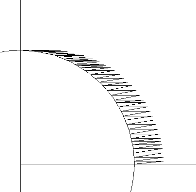

Hmm, hard to explain in words. Draw a circle. Starting at the top , draw a .25" line from the circle out .25" and put a dot. Move down 1/8" and repeat till you get 1/2 way down. Actually, thats easy to draw so here it is in the attachment. Its an illusion that the squiggly line is getting closer to the circle on the X plane. All the squigglies are the same distance out on that plane, and its the only plane that matters. The same effect is in the toolpath, only worse because the involute shape is going onto a flat plane ..faster...its as if your zooming into the very top of this illusion below. Now it is possible thats where the numbers are bad..Ill check that to be sure, the trouble with tangents is that they approach infinity as they approach 90 degrees. Again, 4 teeth puts us very close to 90 degrees..good chance thats where the error is..
Hmm, you know, Pulling up the bit zero to .1 or .2mm may be all it takes to fix it anyway, as the tangents shaving would still work the same and all thats affected is the rooting angles..which are so critical that a .1mm upwards motion of the rooting bit is amplified greatly in effect at those angles..Ill give it some thought..
Re: 45 degree worm M2.5
Art, yes I see now about the horizontal distance remaining constant.
Phil :)
Phil :)
Phil:
Now imagine the entire path is lifted just marginally. The side clearance stays the same on the root, but
the clearance from the profile grows exponentially as the zero is raised. ( It also shrinks exponentially as its lowered.),
Its why I asked about center, it wasnt I figured you were off by much, if any, but on 4 tooth gears in particular it becomes so critical is ain't funny.. ( Where on 15 tooth gears it isn't very critical at all..).
Maybe I should build in something that raises the root by a clearance amount when the two planes get so
parallel.. :)
parallel.. :)
Yes but if the issue was a case of off center then I don't think the artifact would appear equally on adjacent tooth flanks.
Phil :)
Phil :)
Actually , it would be identical. Look at that example toolpath photo gain. Mentally lower the toolpath,
as you see both flanks now get equally hit.. identically so in fact. :)
