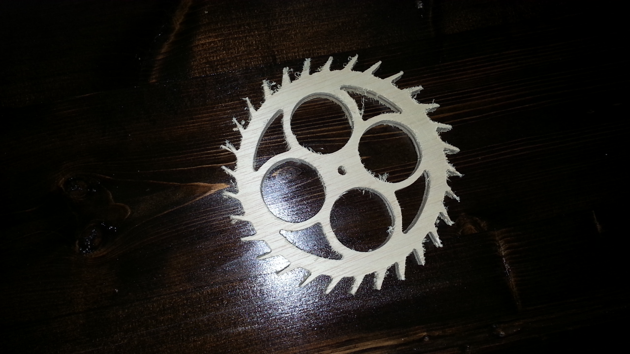

I think you are going to be very proud of me,,,,,,(I hope) but I could be wrong.....
Every gear I made in Gearotic for the past two weeks has done that
drop down from the start and made a cut on the way to the center hole...not good...
So after many hours of watching this over and over in a simulator, I came to the
conclusion the it was the first line under M3 S1750: that reads:
G1 Z-0.050 F20.00 (See attached .tap straight from Gearotic).
All I did was add G20 and change that line to read: G1 Z0.25 F20.00

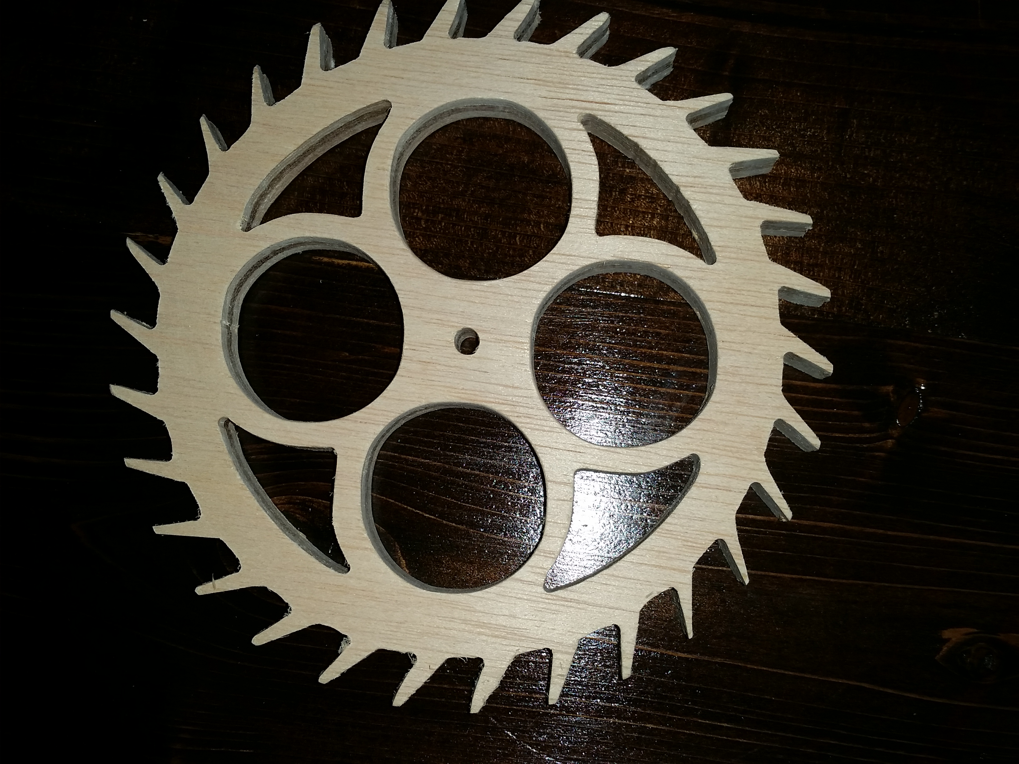

See photo of my best gear yet....( I am so excited....!!!)
Without your help...........I would be in big trouble....
Thanks................rocket

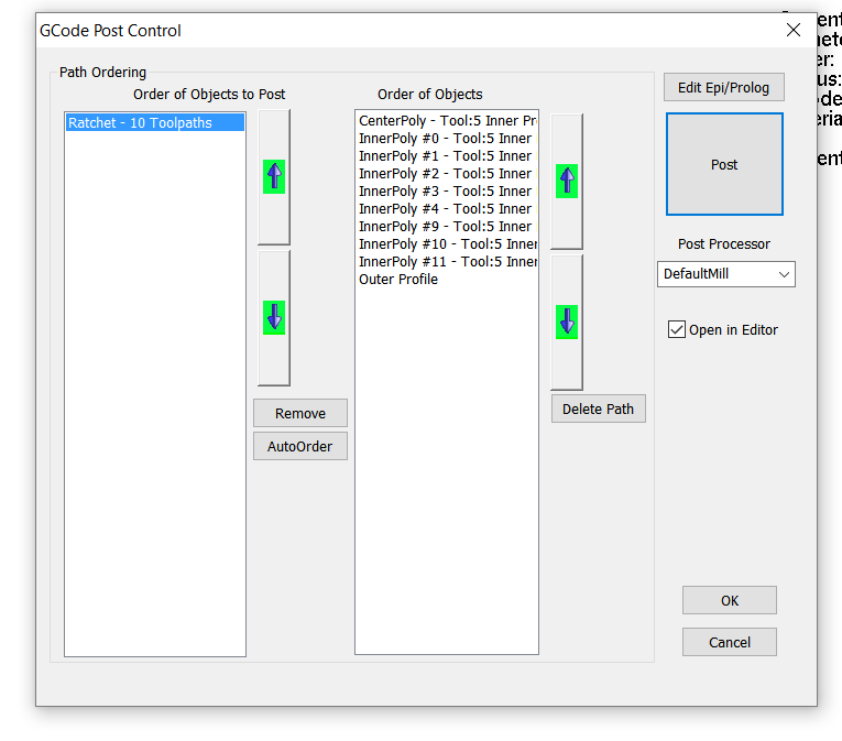

So just put a g20 at the TOP of this file, no other editing.. it will work fine. In Gearotic ,
you can set a setting called Prologue, set just "G20" in there and Gearotic will add the
G20 for you as you create the file.

I just made this gear (.jpg pic attached)
with that same file, All I did was remove the - (minus sign) from the Z line.
The attached file is the file I used to makee this gear with.....
I have no idea.....maybe Carbide 3 (Shapeoko guys) can answer us????
I am smart enough to know when I am dealing with smart people!
Thank you..................I know that I have been a pain in the ass........
r
