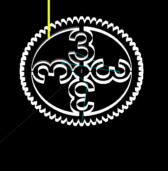

Create the gear in Gearotic. Post it and save it to a file.
Set up machine in Universal G code Sender. Everything works
great except for makes that same cut from lower left corner of
material all the way to center where it starts to drill shaft.
Line of cut is about 10 inches long and ruins an almost perfect job.
Attached G-code .tap and photo of simulation as it was cutting
so you can see the white cutting line all the way to the center....
I am stuck...

Rocket:
Are you setting a safe_Z in the settings? Your file is wrong at the start, and Im not sure how your doing it..
If I generate apost for a test gear it starts as
( No Prolog Set )( GCode Objects Begin. )
( Object Spur Begins )
G0 Z1.000
G0 X13.978 Y12.198 Z0.000 A0.000 ------- //this line moves it to the start of cut BEFORE dropping down
( Shaft Hole path - Inside Profile )

Your posted file is missing that line.. Are you removing the line? Is Safe_Z set? Ill see if I can se why
that preparation line might not appear.. a setting maybe..

Disregard the previous .tap file. I messed it up.
Here is the exact file from Gearotic (I did not change anything).
I know I must remove the G43H0 and add a line: G20 for inches.
Attachments: .tap as is from Gearotic.
I tried to send you the .gth file but it is too large according to rules here.
Thanks....

Rocket:
ahh, thats better.
Attached is a new post processor. Replace the file in your installation folder, the G43H0 will no longer show up.
Just add a G20 to the top, you shoudl be fine. The rest of that file looked good, you got the line cut
because you removed the first move..which was to the center to start cutting..
