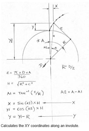

Art, are you using something like this as the basis for the Z and Y coordinates of the cutter position relative to the involute when rooting above the base diameter.
Phil :)

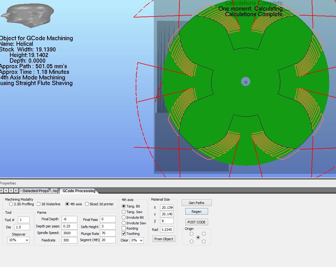

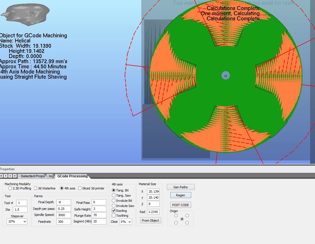

Here is the rooting of a very thin blank compared with toothing the same blank. Note that due to the virtually zero thickness on the blank the toothing tool path shows no overlap witrh the involute profile whereas the rooting does, why. The rooting profile looks like it is using the root diameter as the basis for calculating the Y and Z values rather than using the base diameter. Have you checked which diameter the rooting uses as the basis for roughing the tan shaving area. Such an error would be more noticeable with lower tooth counts.
Phil :)

Still trying. This rooting (again, a very thin blank) looks like it is following an involute profile all the way from the root. Does this support the theory that the calculation is based on the wrong diameter???
Phil :)

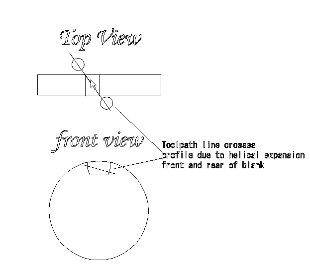

Hmm, best I draw this point, its a hard one to word.. look to the photo below. The top shot is the helical, to machine its helix properly the toolpath has to start outside the profile and end outside the profile because the tool must start in front and end in the back with the same angular offset. Its why I keep saying its an optical illusion that the profile
is being violated. Look at a spur, same code generator, notice there is no profile crossing..because there's no helix.

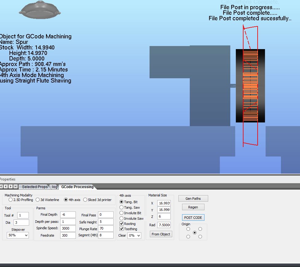

Trying to run the straight spur but there seems to be something wrong with the gcode values versus the gear blank thickness. See attached. The gear blank is 5mm thick but the x axis only cycles between X+1.5 and X-1.5, which is the tool diameter. clearance is zero!!!
Phil :)
Re: 45 degree worm M2.5
Damn..what the hell did I break while in there... Ill fix that very shortly.
