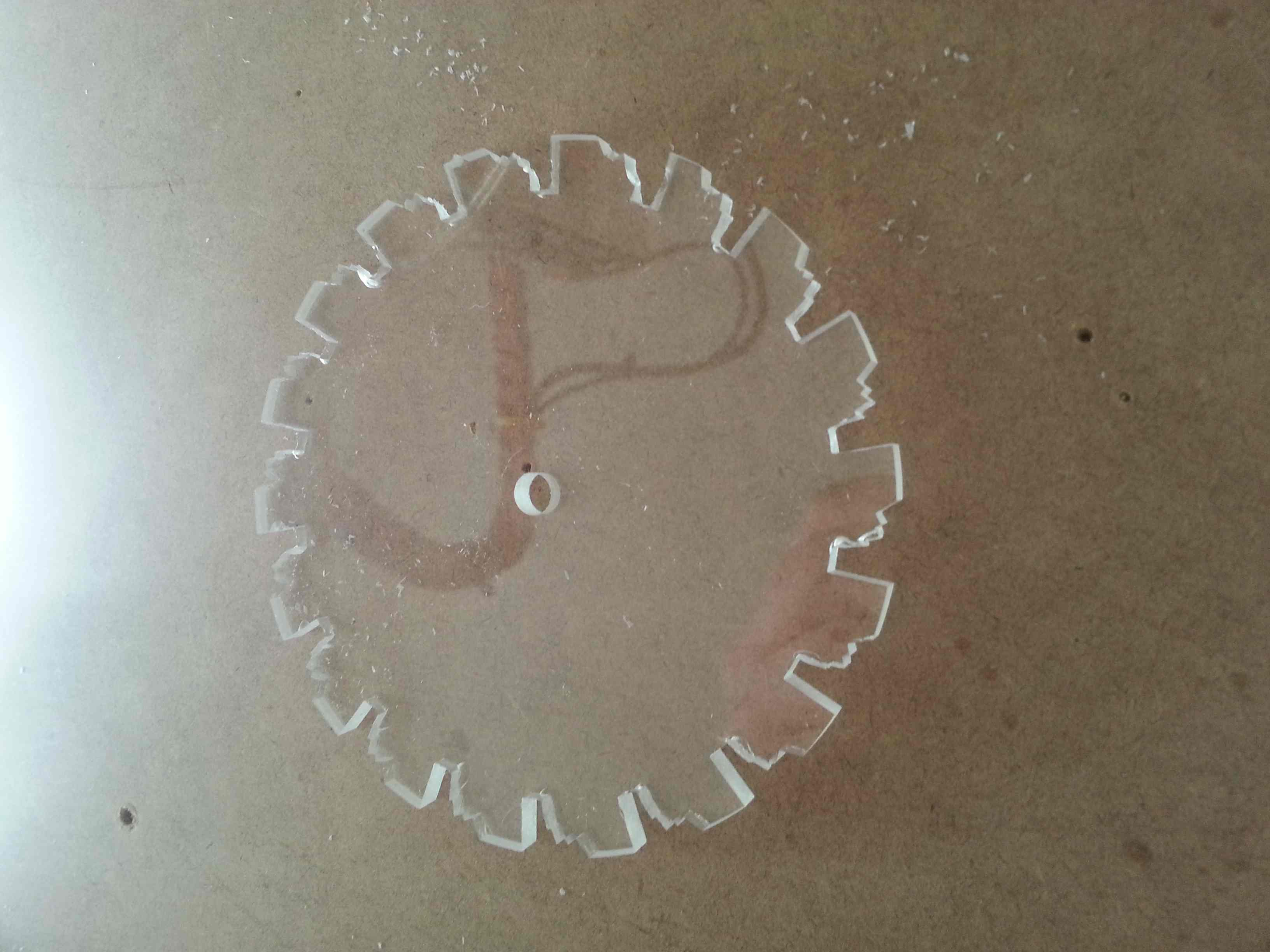

Hi Justin,
Yep I did ZERO the machine just before starting the cut, X-Y-Z and A, I did not stop the machine during the shaving. I'm using the HEIZ High-Z S-1000 machine, http://www.cncsolutions.co.za/products. ... %20S%20400 and the CNC controller is their program called WINPC-NC.
I wonder, Gearotic outputs for MACH3 (I think)?, do I maybe need to specify a different Post-Processor? Do you think that might be the problem? I'm out of ideas...
Regards
Re: Newbie help with 4th axis gear cutting
  Sorry Im late replying, I didnt get notifications again on this thread..
The video shows whatever this is its bad, while its common to miss onme or two shaving steps,
this one is missing too many and is way off.
Final Depth means nothing in 4th axis, its only for 2.5D cuts, in 4th axis you'l cut to root depth
always. Your teeth look too deep, the shaving is way off so Im surprised oyu get teeth at all really. :)
OK..
  hmm, you know , that gearis just too large to show effect properly.. Can you try a 10 tooth
module 5 or so, any gear with 10 teeth thats about 100mm in diamter would be good.
Show me just the first tooth cutting on it and I cxan usually tell whats wrong..
Tx

I am quite certain that the you are really close to getting a perfect gear.
G-code programs with only G00 and G01 are pretty global. There are differences around the globe besides metric/inch that might need to be addressed in a preamble line. Some controllers default slightly differently, who knows?
For some reason there is an offset in the A and X axes. The Y and Z axes seem to be okay.
The offset is about what you would expect if the machine were zeroed where the faces are cut with 11 Y passes, instead of where the roots are cut with 4 Y passes.
I think the G-code is fine. Perhaps there is a persistent offset variable being saved between runs. You should have a preamble line to make sure that your controller is starting fresh. G20 G54 G40 G49 G90 G80 G94 is a preamble that I just sucked off the web. It is for a machine being run in inches (G20). You would want to find out what other people with your controller use when they run a typical North American program.
Double check your zeroing procedures, and check and confirm the results as you zero.
Are you working with cncsolutions? They might be more familiar with international issues than we North Americans. They would  also be a good source for a generic preamble line.
You really are very, very close to having your gear. It's probably something silly and simple.

I had some time before flying to Bangladesh, I tried cutting a 18 tooth gear 100mm, at least the results made me laugh!! I tried changing the pre-processing code as per the previous post. Hope you can discover what I'm doing wrong?
Video is here
http://www.youtube.com/watch?v=HcbOVptC ... e=youtu.be
It looks very much like your not centered at the top of the disk?? You must be at the absolute top, and the rigth distance from the center of the disk. Is that the way its setup or am I seeing a perspective issue in the video?
JustinO
Posts: 136
Post by JustinO »
Replace the first G01 in the program with:
G01 X 0.0 Y 0.0 Z 0.0 A0.0.
M00
Delete all subsequent lines of the program.
Run the program after zeroing the machine exactly as you have been.
Where is the cutter?
