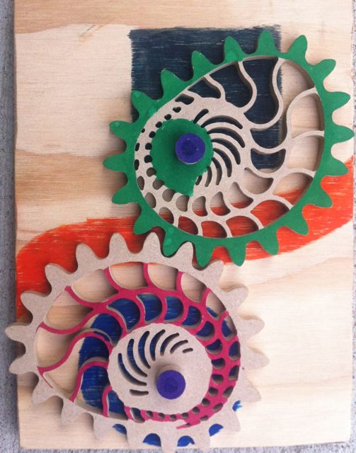

This set was created from the GTA tab. The pinion is 100% controlled by the gear and although they look like they are the same they aren't but they do mesh just fine.

Zafar:
It can be very very hard to do such a gear as your photos show. There is no accepoted method of figuring out the modification proceedure or elliptical formulation used for a non-circular gear. No one measurment will tell you what youd need to know to duplicate someone elses gears. GM cannot yet do rotational analysis ( which is what youd need to figure out what the actual calculus is behind the gears shape.. )
