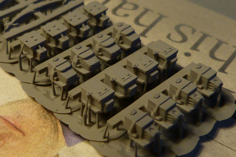

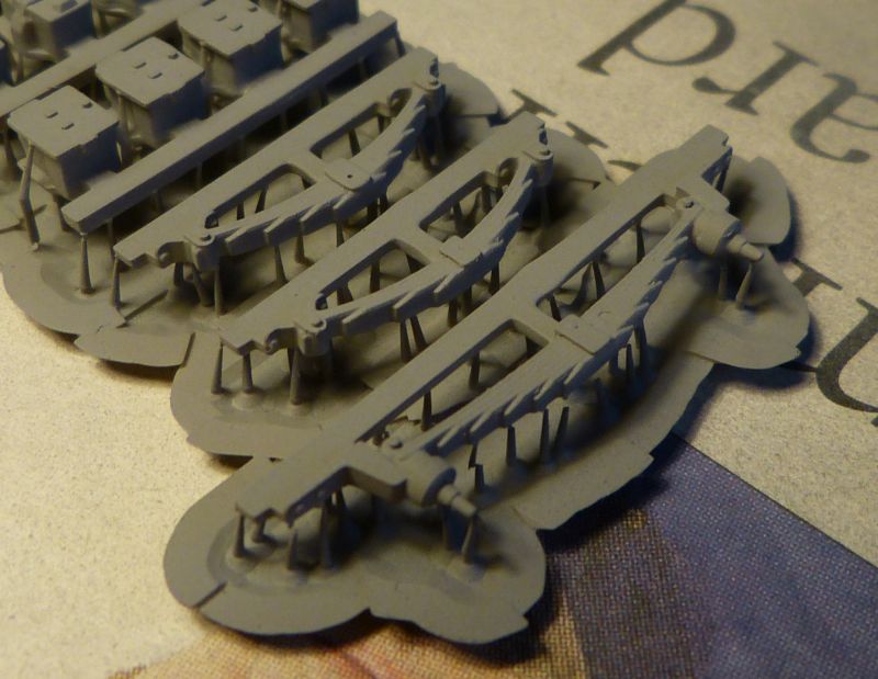

I haven't done very much printing principally because I'm still trying to get my head around modern 3D CAD packages.  I was fairly proficient with an ancient copy of Rhino but that stopped working when I upgraded to Win 10.  I've been fiddling around with some of the free offerings available and not really getting under the skin of then - old Rhino and thirty years of 2D CAD experience aren't much help.  :)   However I did have some files of small detail parts for 1:64 scale models and I printed some of them with excellent results.  I used ChituBox slicer on these files and sent them to the printer and they printed extremely well with no problems.   Admittedly they are quite small and low volume - the smaller wagon springs are about 17mm long - so they are probably not a full test of adhesion to the plate.  But they were certainly fixed very well when it came to getting them off at the end of printing.
I was impressed with the Shuffle when I got it out of the box.  It's a very sturdy piece of equipment and the quality of its Z axis driven by a ball screw is very good.  I don't think there will be any problems with "Z wobble" that seems to be an occasional problem with other similar products with lighter Z axis construction.   It literally was a case of getting it of of the box,    switch on,  square up the plate (very easy),  pour some resin in the reservoir, and load a file into it and press "GO".
Would love to see a pic of any work models gears that you have made.
Hopefully I've attached a couple of the wagon detail parts.  :)

That is nice, I am still amazed by what talented people can make nowadays from the coders to the makers making life for me the "end user" a breeze.
I ask you why would you now buy parts when you can produce quality of your own.
The face of manufacturing is changing, I can already see walking into a auto store ordering parts for you car, and the sales person telling you the printing should be done in a few minutes. There is no logical reason to keep millions of small plastic parts in stock taking up space when you can print and go on demand.
I hope you get many years of enjoyment from that printer. I'm waiting on a delivery today of some tints and some more flexible resin, I have a job primed and rdy to go so see how this flexible stuff works.

wow, those are great prints. Seeing stuff like that always ends up costing me money.
I love my fdm printer, Im getting the feeling resin may be in store
soon by the look of those prints.
