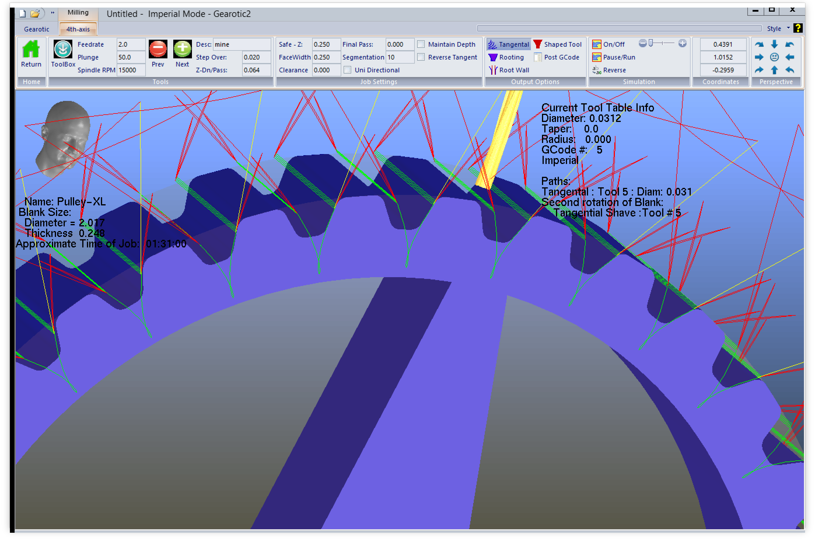

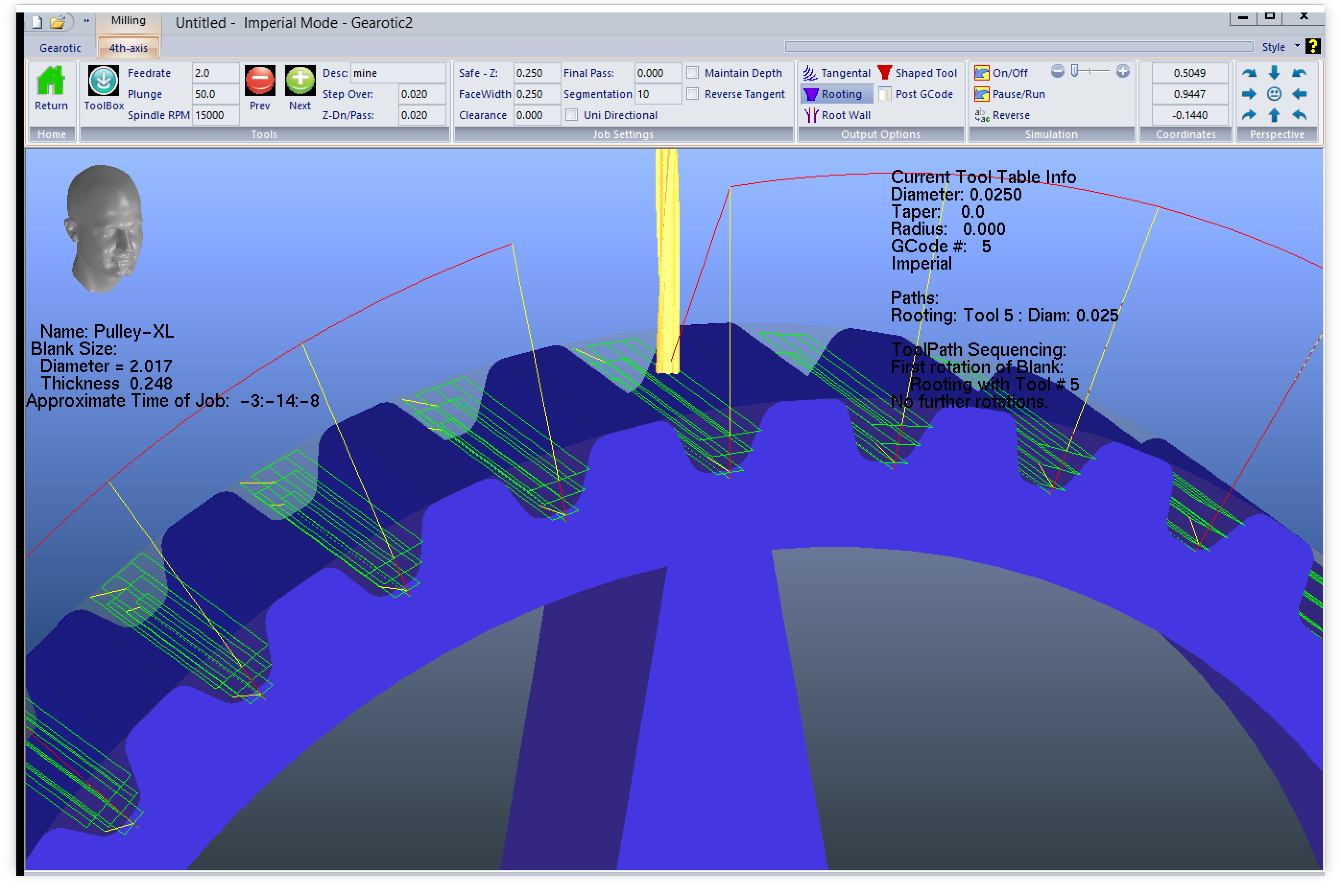

That's not correct Art. I am watching it with the slider all the way down.
Anyway, with the sim zoomed in so it just envelops the action, and tilted for the best observation I have watched what is happening; watched it for quite a while, and I don't see the walls of the pulley being cut.
During "tangential" the tool only shaves the small radius, goes down outside the pulley and loops over to the opposite radius to shave that.
During "rooting" the tool only goes straight down, no movement of the 4th axis except to move to the next tooth.
What am I missing?
What am I missing?

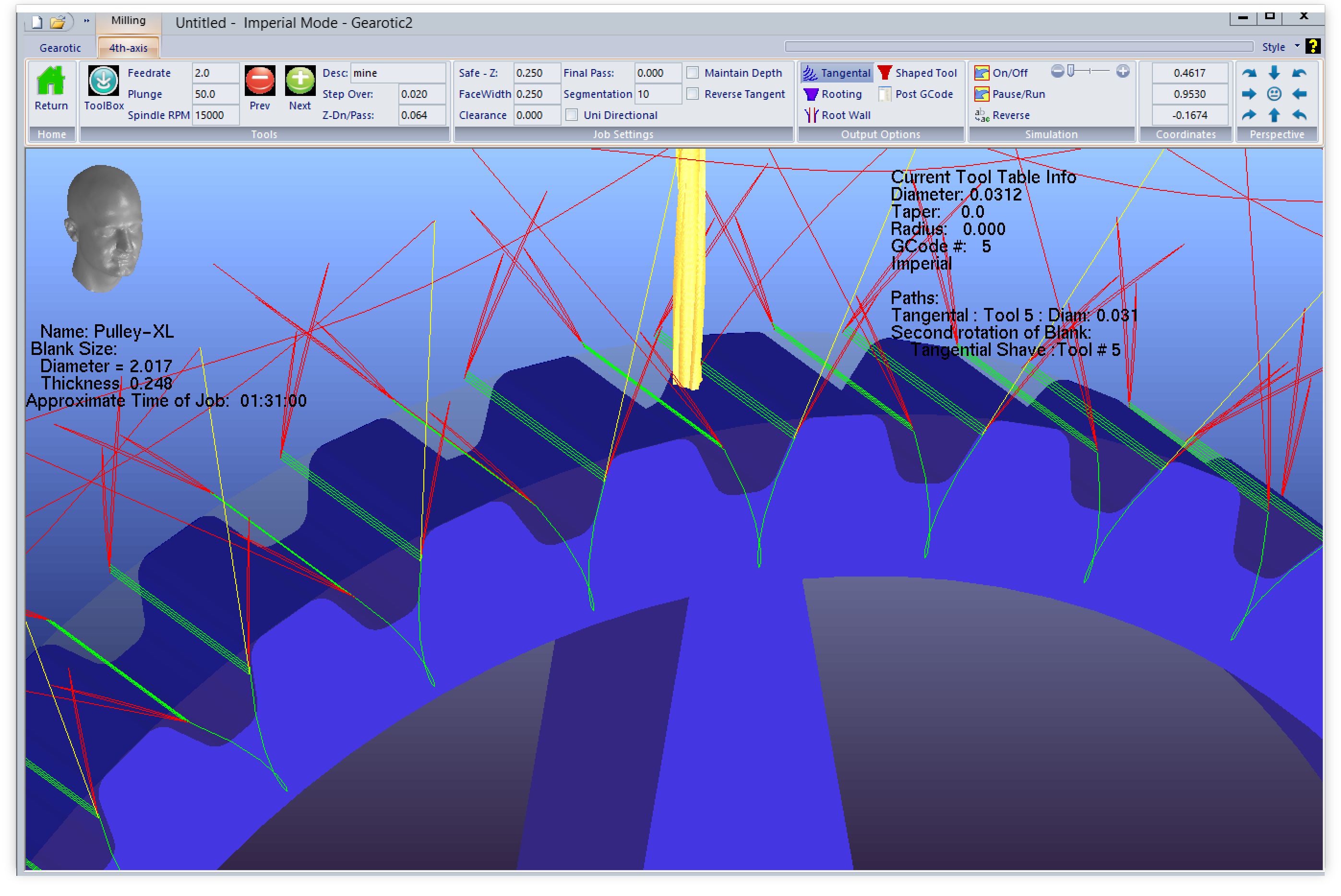

Here's another shot with the color changed slightly. Only the bright green are cuts.

Doesnt sound liek your missing anything. The root wall routine rotates the blank so the root wall thats straight is cut in a single pass, the tangental wont try to cut anything that isnt curved, curves are the only thing tangental can really do. As the root wall is a straight line vector, the program puts a single line pass on it to straighten it, then applies the tangental only to the radius at the top. Unlike normal spurs, the side walls of that
timing pulley have no real curvature. The bottom radius cannot be cut by either so
the rooting section does the best it can there.
So in your case it sounds like the rootiing isnt doing what it should, but it may be trying to do it in one pass, in which case the smallest radius at the bottom is all thats cut. If it is rooting in passes, each higher pass can typically cut a bit wider. Change your depth per pass and see if the rooting ( not the root wall) cuts wider on each pass..

Yes, with a pulley you end up with a stepped radius at the bottom of the tooth,
the walls should be straightened with the wall routine though. A radius bit tends to
make it all come out ok as that bottom radius is for relief and the belt doesn't usually run into it. Doing it with a shaped bit is always preferable for a pulley though, there
just isnt enough curve in there to shave.

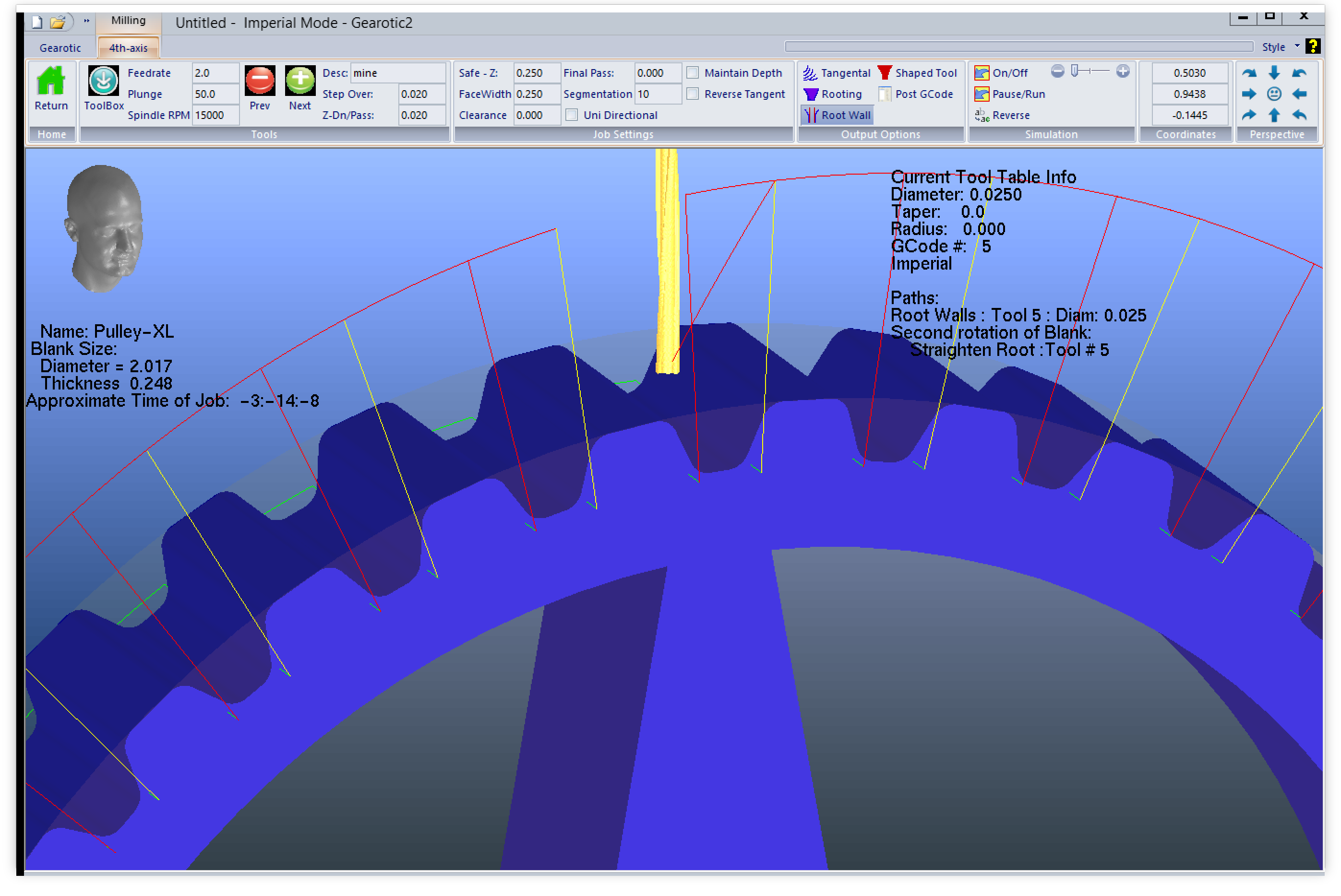

Steps at the bottom radii don't matter, and at the top the shaving should be fine.
But I don't understand your statement regarding the walls being straightened by the wall routine, I take that to mean flattened. The only way I get any taper on the walls at all is to make small depth increments as you suggested. That makes steps in the wall the size of the depth increment, certainly not flat.
It seems to me that while not the same as making a gear tooth, it should be possible to shave/cut the side wall with the 4th axis rotated and the tool offset the proper amount.
The wall routine does not do that.
Ozzie
Ozzie

I agree, purely a problem due to the fact the routine is meant to do gears as opposed to pulleys. Its a problem where shaving is done on the curve, and with no curve the algorithm is a bit lost as to how to do the wall. Ill add this to my list of things to look at in gearotic, it is definitely a deficit. Works well as designed, but pulleys are kinda a get what you get type of operation , though to its credit Ive seen many done that worked very
well and the user was quite happy. In this case the XL's wall is at the bad end, the GT's seem to have far less trouble. Your shaped bit idea is probably the best way to go, and it is the way I always recommend for pulleys if you have the technology to make one.

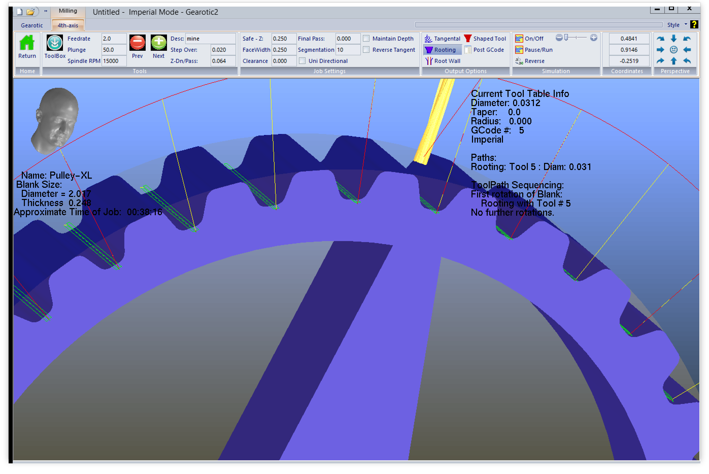

I'm having a similar problem, but it is enough different that I don't think it is the problem described above, and maybe it's my misunderstanding of the tool description
The issue is this. The pulley is an XL pulley. All research on that form shows the bottom of the pulley grove is 1.27mm or 0.050" The radius of the bottom and top curves is 0.61mm or 0.0025" I figured a 0.005 radius mill ( the finest radius I found ) would leave a slight amount in the bottom that the belt wouldn't tough. So I defined the tool in the tool table as a 0.050" flat mill with a radius of 0.005" and bottom flat of 0.040" The profile of the mill in the simulation looked good, but the mill cut beyond the diagonal 25 degree slop of the sides and it also posted a warning the mill was too big.
I make it a sharp corner 0.050" mill with no radius, there is no fouling of the slope sides in the simulation.
If I make it a 0.030" with the 0.005" radius it is OK also. But a mill over O.034" fouls the side. My guess is that either I don't understand the tip radius and it really doesn't apply for this application, or that the radius isn't calculated in the edge of the tool.
A kick in the right directions would be welcome.
Don
What am I missing? I'm new to the program, so
Don

The end radius wont be taken into account. In tangental shaving the radius at the
end is not material to the algorithm. The algorithm tries to align tangental points on a curve
to the vertical axis of the tool ( so only the edges). This works well in involutes. While never
planned for pulleys it turns out they do often work as well, but its hit or miss until it simulates well.
It really depends on the pulley type. If the root walls are a tangent to the center it tends to work
ok, but in some shapes it simply gets as close as it can.
The algorithm in 4th axis is actually just trying to figure out how best to place the tool
at various steps along the way without hitting the stl 3d model of the tooth.
Thats not to say a radius on a tool wont matter, even in involute cutting it still will make the
root more rounded in its trochoidal root area. But all cutting will really be attempted
at the bottom edge of the tool on each step,unless "Maintain depth" is checked, in that case all cutting
will be attempted on the side edge of the tool so the tool will be kept lower.
