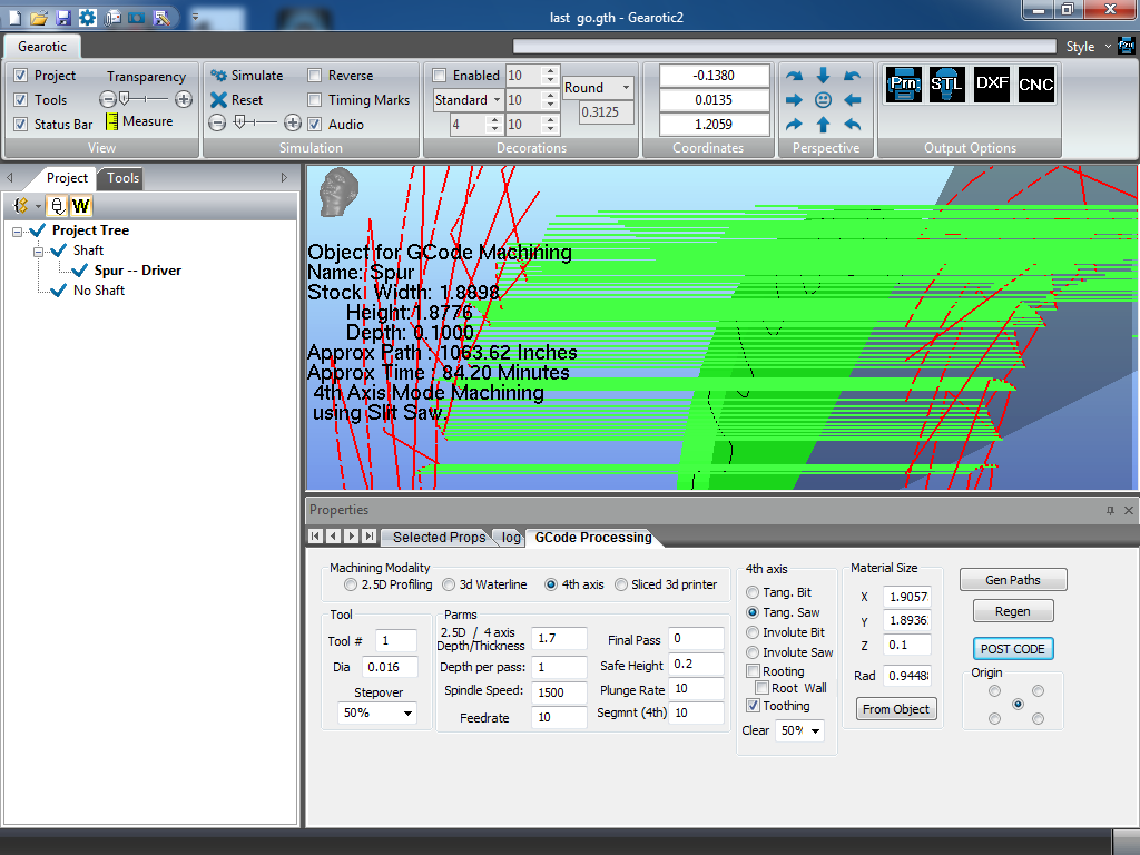

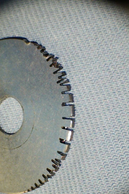

Re: Tangential Saw shaving 4th axis
A rather frustrating day, did not get to my workshop until after 6pm today :(
Tried another simple gear; 22 teeth 2mod using a 0.016" thick 2.75" diameter saw and a 1.85"blank
Not a great success, cuts a number of slots above and below Z zero ending in a rapid 90 degree A and a full depth Y fortunately just missing blank above and beneath.
No Z or A movements were cut with saw in work.
Then proceeds to cut away almost all material of some teeth. I think 16 thou should be thin enough and no warnings given in Gearotic.
Attached gth tap screen shot and picture
Thanks but I am not longer sure if this a program error or my own stupidity!
David
David:
I ont think its you, the numbers seem deeply wrong in the Gcode, but I cant make head nor hair of it. Its one of those things
that unless Im doing it myself, someone elses number mean nothing. Leav it until I can check to see whats going on internally, and that may take
a few weeks from where I am. Sorry for the screwyness, I cant see where its coming from but Im sure I latch onto it..

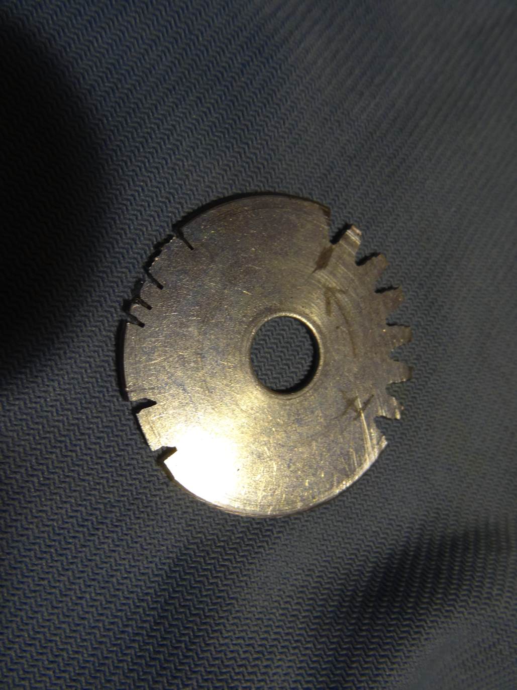

Thanks for your help
Attached is a picture with two arrows to show direction rotation of chuck when A increases (more (+) which I think is counter clockwise
Attached is a picture of a part cut blank. One side shows the slashing cuts with toothing on. The other side shows a part cut "gear" with just rooting on, you can just see 1 under first tooth 7 under last and the direction of rotation arrow all in pencil, looking good.
I notice that with toothing off depth of cut does work and these teeth are cut in depths of 0.05" no finishing cut.
As soon as toothing checked everything goes haywire, results as described in previous posts and depth of cut does not work cuts up to 0.20" can be seen
Hope this helps
David
David:
Well, those rooting passes look good. The depthperPass is used to set only the root passes, and is used if toothing is on or off. A saw has so much power you likely dont need it, but keep it in mind to flute work. The teeth are shaved in a number of "Segments" and thats what the segments box sets.. You might want to invert your direction bit for the A axis to see if shaving then works...its odd to me its that far out..
The shaving looks good numerically, so it will take me a while to dig deeper. It may be the rotation backwards on my end.
