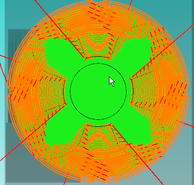

It still looks wrong to me.
The roughing stil does the overcut at the tip.

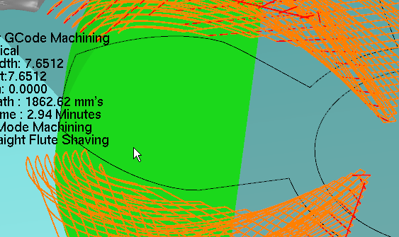

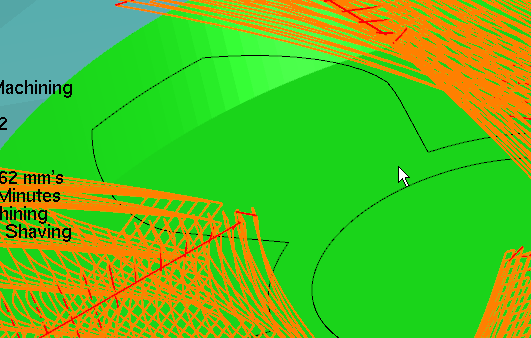

Hi Art, with the toothing tool path is the orange line the edge of the end mill or the centre line. If its the centre line then the cuttingedge possibly goes over the involute line. See attached screenshot:
Phil :)
PS: the amount of overlap appears to be influenced by the gear thickness. Which I can understand if the overlap appeared only one side of the tooth profile, in the direction of the helix, but it's on both sides? I'm probably miss something!!
Re: 45 degree worm M2.5
Phil:
  There will always appear to be overlap on both sides of the flank and this will be influenced by the
thickness of the gear. Remember, the profile you see is in the center of the blank, so the helix moves on each
side by a function of the helical angle. For  45 degree for example, the tool is moving 22.5 degrees on either
side.
          Rotate the drawing around and watch the center profile, see the way the toolpath wraps around the center
profile to either side of it and youll see what I mean.
  I think I see the problem, its a matter of too few teeth I think, the fewer teeth the more it has to rotate from center tooth
to clear the trochoids, and when that angle gets critical the bit is shaving the opposite flank while trying to clear the trochoid.
Im looking into it to set a maximum rooting angle so that it cannot hit the opposing side. I suspect this is why I havent seen it
before, never tried a 4 tooth. :) , good news is I think its fixable, just a matter of calculating that maximum angle of tangency..

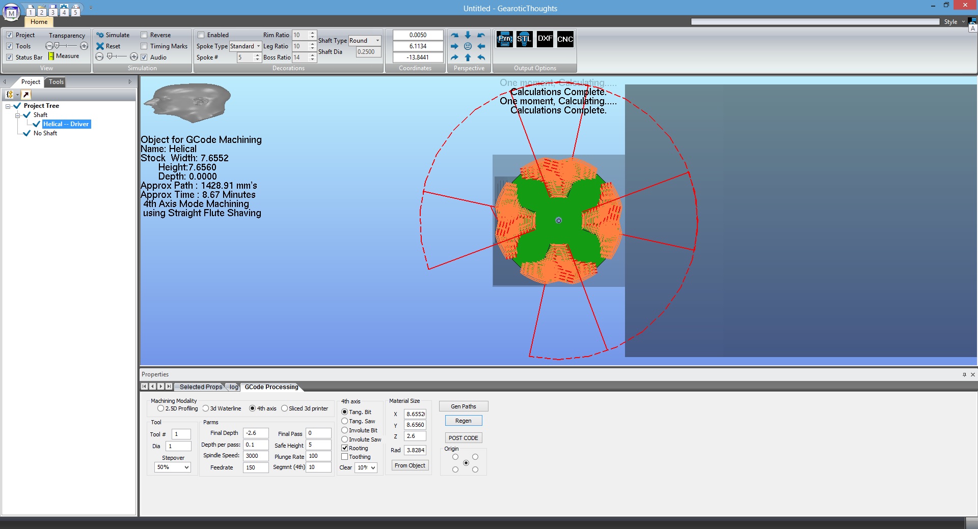

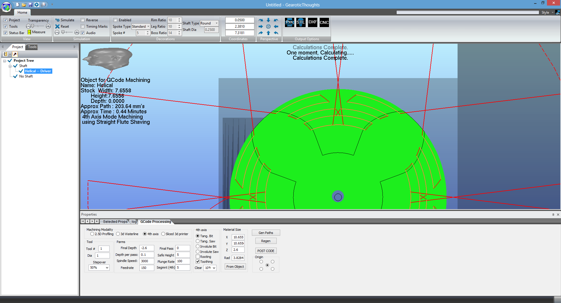

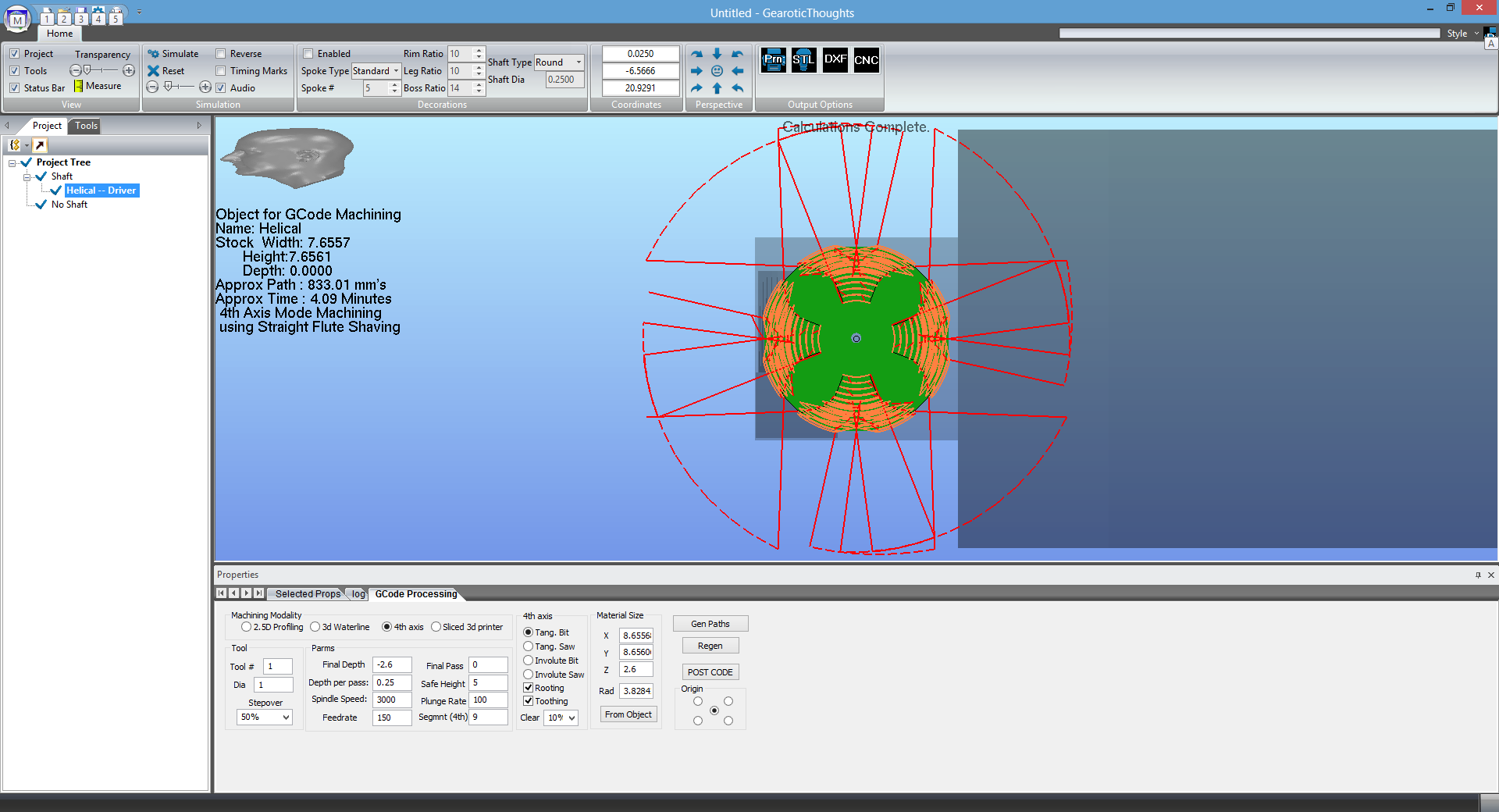

Hi Phil:
    I just uploaded a new version that should correct it all. The toolpath will still look like its cutting off until you rotate it to see where its hitting.
(But it shouldnt hit anywhere anymore.)
  Check image1 .. looks like cutoff, but rotate to image 2 and you can see it doesnt..image 3 shows both flanks are clear.

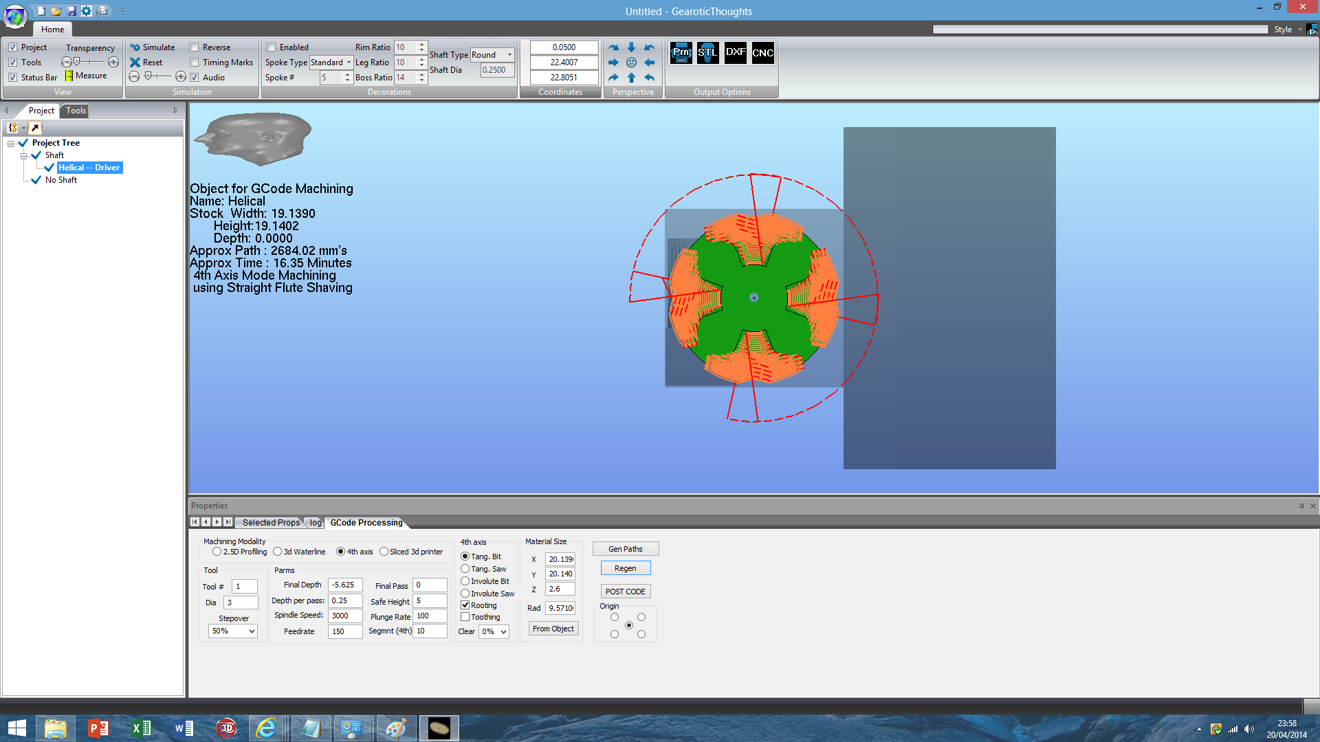

Hi Art when run for a very thin gear (0.1mm) it still looks an awful lot like the gear I produced with the tooth tip error:
Phil:
  Unlike before though, the red lines seem to show a proper relationship..
What does it look like when tilted around so you can see the profile.?
