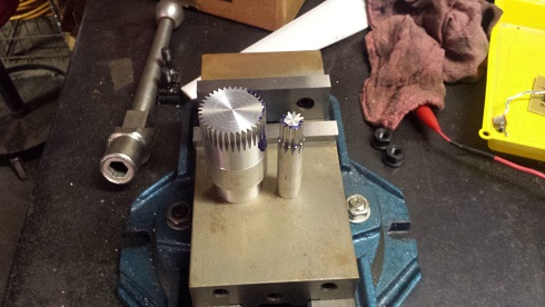

[img]http://pinion_12_pix.jpg[/img]
Not sure this picture of the 2 gears i made using the 4th axis. I used aluminum since i didn't have the right brass stock.
I need to go over the parameters for the g-code generation since i was cutting more air than material.
Re: OD calculation
Bruce:
Shaving does cut a lot of air depending on parameters, or was this
a shaped tool? If shaving tangentally, try fewer segments, usually 7 or so is fine, also check the safe_z to make sure it isnt raising too much. Other than
that it is pretty typical to cut lot of air as the technique is all about positioning..
They look pretty good from that distance though...
Re: OD calculation
I used a shaped cutter, the mod 1's set I purchased a year ago. I used a G0704 mill converted to CNC with Flashcut
hardware and software. The g-code generated by Gearotic worked with out making any changes. Sometimes
Flashcut doesn't like the way some g-code commands are setup but not in this case.
The gears shown seem to mesh ok but I really need to either cut some thin slices off each to make a set that i
can put shafts in and see how well they do run by hand or cut up some brass blanks and make them over again
now that I have proven out the g-code.
