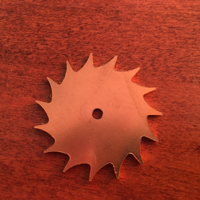

I had tried in the past to cut brass but always ended up with a broken bit and no gear to show for it.
So, I took you advice and have cut a 1.5 inch escape wheel that is 1/16 inch thick. The CNC was set up at 100 inches per minute using a carbide 1/16 inch end mill.
The difference this time was that I set the cut per pass at 0.001 inches and it worked. Even though it took 62 passed to complete it was worth it. The photo is as it came off the CNC with no burr removal or anything.
A beautiful gear (in my opinion).
Thanks for your help!!

Excellent!, glad it worked out. Thats the thing about low power machines, you really can do amazing things, you just
have to be patient and take very little at a time. Eventually, you do get through..
