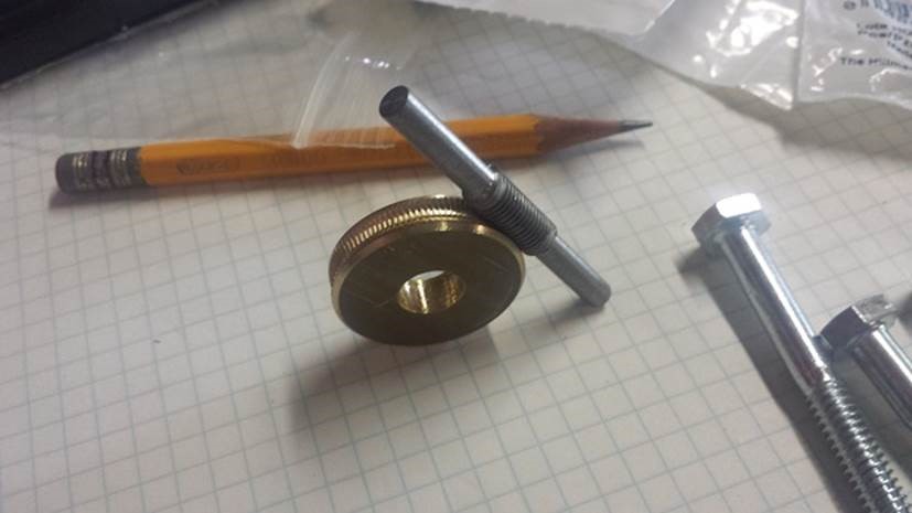

Well been awhile since posting this thread but I have finally made 2 worm gears. Here is a picture, still need to
make the bracket to hold gear and driver. I used the info in the link I had originally posted. Haven't tried counting
the teeth, should be about 100. Will do that later just to verify how close I got but not critical.
Bruce
Re: Worm gear making
That DOES look very good....
