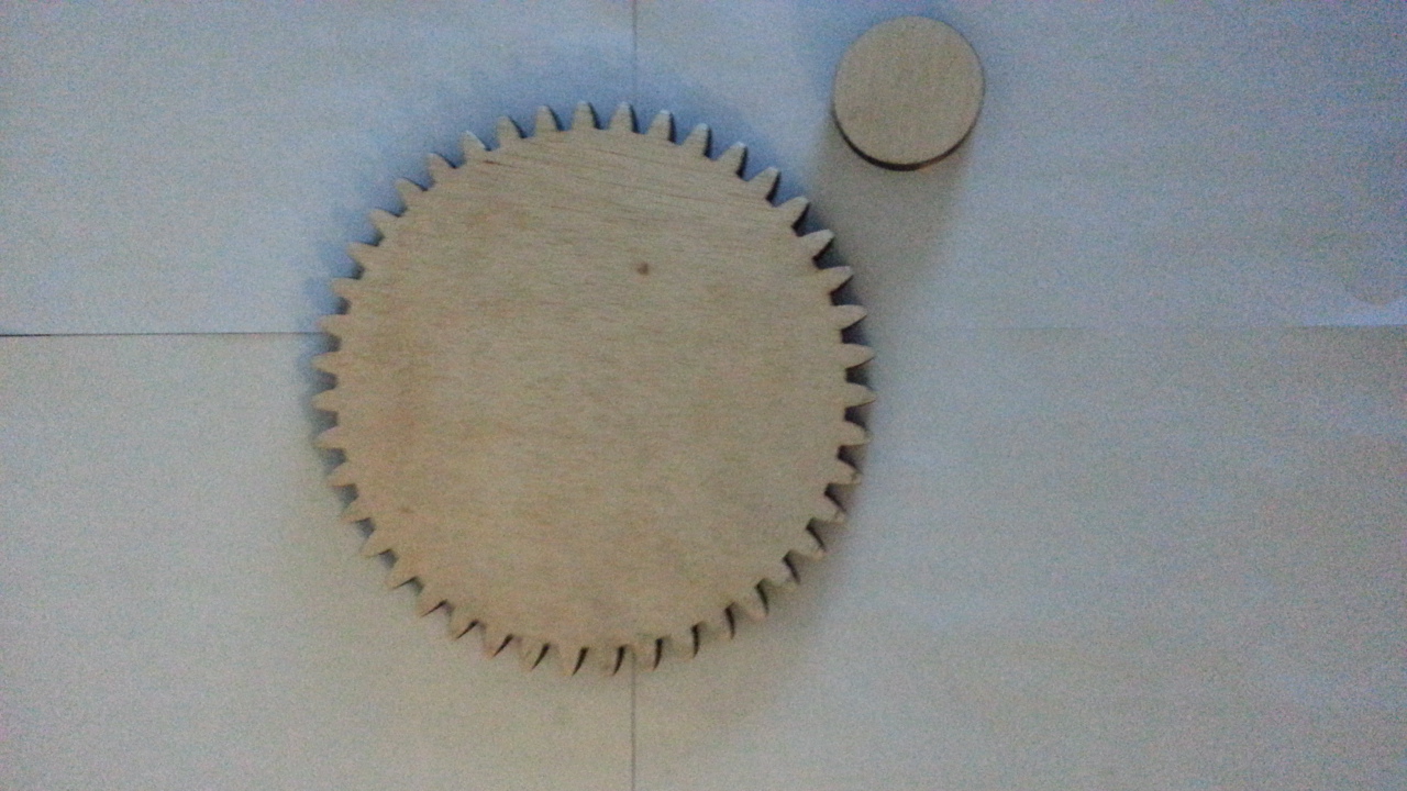

The mirrors were aligned perfectly and I made a plain test gear from Gearotic
to see what would happen.
1/2 cheap plywood.  Power 95%, speed 5%, gear is about 8 inches in diameter.
Took about 7 minutes to cut....amazing.....

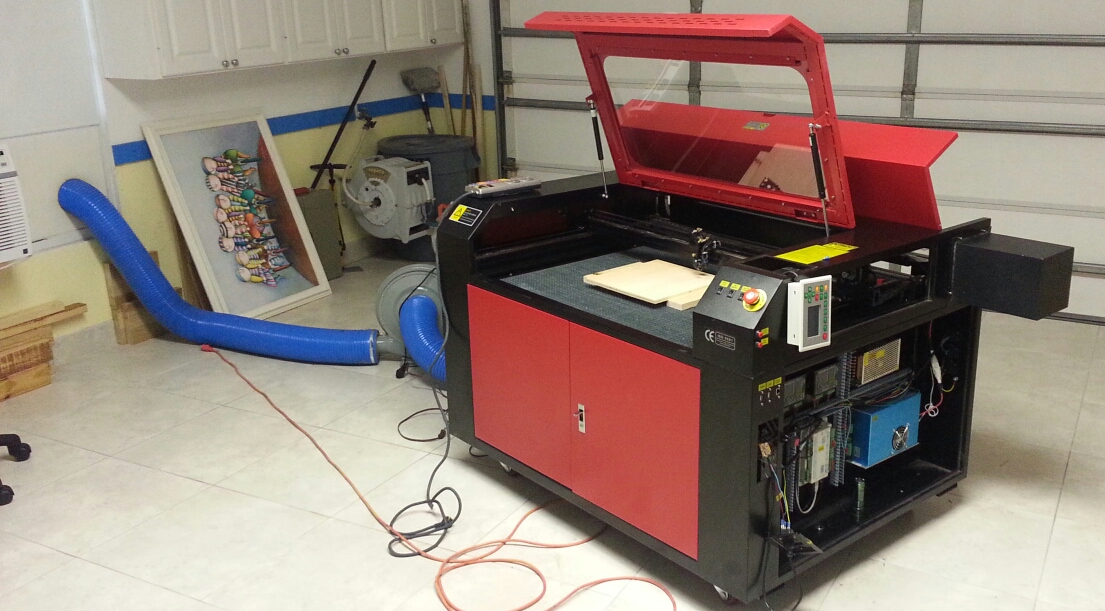

The monster, in my air conditioned garage!
Temporary hook-up, I cut the 6 inch exhaust hole
next to the AC with the machine before it went DEAD>
RR

Re: My new Chinese 100 Watt Laser Cutter
Nice Machine, quite similar to mine..just a bit larger.
  The chinese will help you out typically, at least for awhile. Mine had a similar problem when
the Estop button got loose, it wouldnt turn on.. Im sure it till be the main  fuse or something..
No power at all is usually the easiest trouble to fix..
