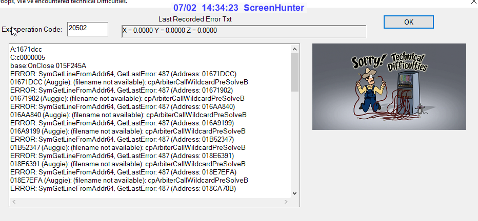

Re: reading Pokeys pins
Any chance that's because your acceleration settings are too high?gburk wrote: The only problem I seem to be having is if I use RapidTo or FeedTo the system seems to loose it position's
Gary:
Ill check the Rapid and Feedto to see why their different than Gcode..
and Ill re-release with release version, now that we've tested the debug.
The reason you see that script is that one exists in the standard saved screen.
One of the panels calls a script that fails and then ignores it. I havent been
able to update the panel yet in the release, so if you enter in debug it logs it,
otherwise it doesn't. Its from an old panel and Ill see if I can update that
file in next release, Ill try for one this weekend.
Gary:
I found the crash was due to no tool number being set, it was defaulting to tool #-1267 for some reason.. who knew.. I made it default to zero. No more crash.
I cant find any real difference between rapidTo and Gcode calls for a rapid, but if it
works better Id stick to GCode. Unfortunatly in the case of the freeaxis, there is no gcode
interpreter assigned, just a planner which is fed by freeFeed and Freerapid.
New version is online to fix the crash and it may also explain weird numbers in
some circumstances..
