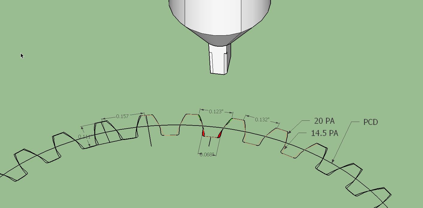

Well here's my CAD attempt to superimpose a 14.5pa on a 20 pa (20dp 30t)
as you can see it involve a broach type chisel to shape out the flank area of the tooth gulley
It doesnt appear to remove much mtl but should allow the meshing tooth full depth
next step is to make some
It wont satisfy purists but will it do the job, maybe need some running in with a tray of fine abrasive fluid?
what do you guys thinks
All data thanx to GM btw
I might try animating by stop motion by swivelling gears by 1 deg but its time consuming and tedious making a gif

I dont think there is anything wrong about this at all. Trochoidal's are one are with little or
no specification. Gearotic uses an incredibly complex algorithm to trace out the actual
tooth curve but its so complex I have long forgotten how it works.
It was a sticky point in development, as were most specs that turn out to be non specific
so I implemented as math pure a solution as I could at the time based on the laws of
meshing more than any spec from gear makers or published standards.
Gears have more modifications that most are aware and dozens of special
tooth profiles for specific situations. I dont think anyone can look down at
a gear that works. :)

I appreciate what you say Art
Tooth profiles have challenged some of the top minds worldwide for decades
Way out of my depth
I am busy making up some gears and mounting them on a test rig
I dont know yet how to make a judgement on whether a pair meshes well or badly other that by eye. I wondered if I put some load on the driven and measured the noise/vibration whether this would be an indicator
I rather get the impression that there's a lot of dark info kept secret by gear makers
One of the impressive examples I came across was gearboxes for wind turbines. They have a speed up ratio to 1:100 and have to xmit 5MW under large varying load conditions (which is a killer for them). They have a life span of 3-5 years and weigh 20 tonnes
Way out of my depth
