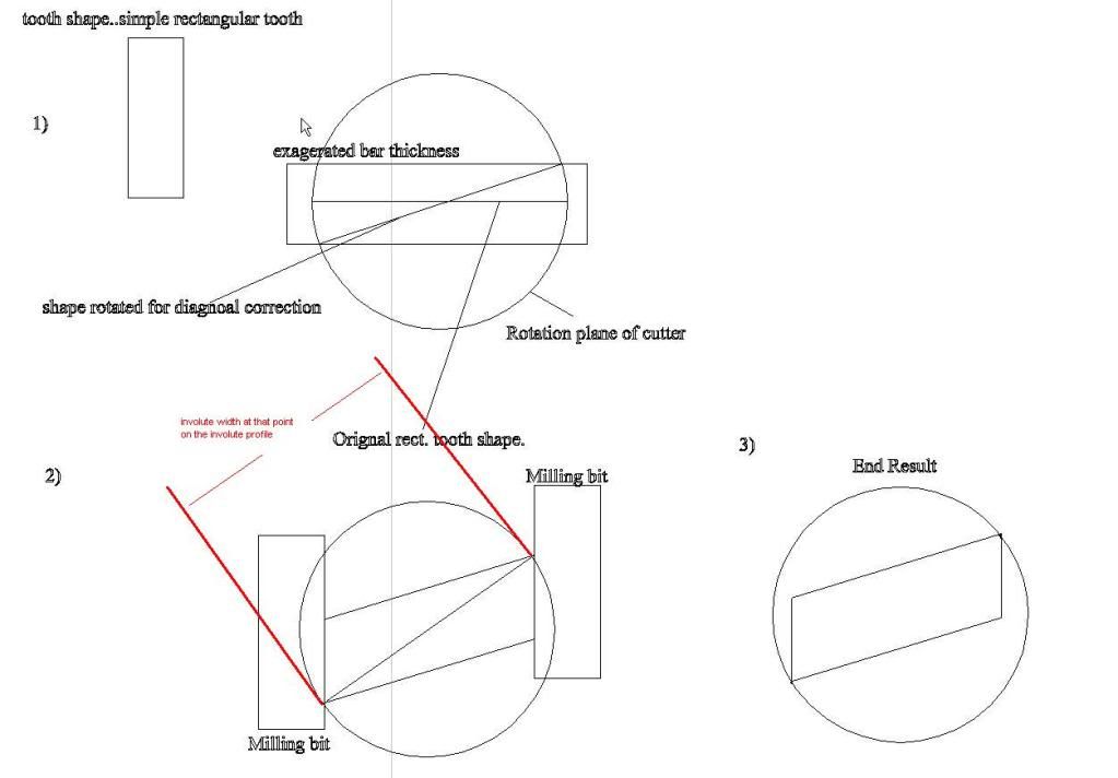

The width of the diagonal between the two cutting edges should be the involute profile width at that point on the profile.  Clearly not only will the end-mill have to follow a path that is a "narrowed" involute profile but also the end-mill path will have to be distorted from the true involute path because the cutting edges are not perpendic ular to the the cutter. The issue is much clearer when you look at figure 2 in the diagram.
I know you may have answered this before but I can't get my head round how you would make these correctio ns without some very fancy maths.
Phil:)
Then rotate the bar and the shape to the relief anngle. This should all work unless you see anything Im missing.

« Reply #32 on: August 19, 2011, 07:43:39 PM »
Phil:
 I just upoaded a version 3.57. I verified its math and that tis properly takingn into account the
diagonal of the bar. The display also shows the thinkness, and its based properly on the tooth, not
the bar your machining down.
  I will try to run one tomorrow to verify its code on the 4th axis, but I think , unless theres a bug in there ) that this
version will properly cut tools for larger modules, and show the limitatio n in size for the smaller ones. Ill post  a
photo when I do the test cut.

I had a second attempt. This time I cut the flats manually and then just ran the program for the volute with safe Z's inserted for each pass.
I thin the graphical presentat ion of the cutter thickness in the volute profile needs to be the diagonal thickness of the cutter. My second attempt was still to thick to sallow the cutter to rotate without rising some way out of the tooth profile as the diagonal passed over the tooth flanks.
The final Z height when cutting the involute seems to be way high. I had to run it again with Z0 2mm lower than the top of the stock. This may have something to do with me doing the flats manually and getting resetting of Z0 wrong, but I don't think so. The low side flash came of 2 passes earlier than the high side. Looking at the code as the end mill passes the cutter tip on the last pass the end mill should at least have a Z value that is half the stock diameter plus half the tool thickness and it is not.
Cutting the involute by progressi vely lower Z passes (with the same small DOC as the flats) seems to result in deflectio n of the cutter on the last pass. If the end mill came in from the side the risk of deflectio n would be greatly reduced and the need for constantl y varying the Z height as it follows the involute profile would be unnecessa ry.
Phil:)
PS: I think a better graphical presentat ion of the cutter tip would be your diagram 3, where the circle diameter would be equal to the involute width at the cutter tip location (at the root).
« Last Edit: August 20, 2011, 07:26:59 AM by philbur » Logged

  >>I thin the graphical presentat ion of the cutter thickness in the volute profile needs to be the diagonal thickness of the cutter. My second attempt was still to thick to sallow the cutter to rotate without rising some way out of the tooth profile as the diagonal passed over the tooth flanks.
    Your probably right. The one I just cut in 3.58 does fit well though.. but then the graphic showed a clearance on either side at 25%.. so its fits as expected. Ill change the display to show the diagnonal instead though, instead of how it fits at 90 degrees. You also have to be carefull when checking them to use a gear cut with GM, as GM's roots likely dont match retail gears, roots change from maker to maker, so a test gear pretty much has to match what GM does..
  Mine cut properly with no flash this time.. but Ill check the numbers.. both in the program and in the final Gcode to make sure that the depths are correct.. I do see that the zero is extremely important in terms of it doing the rigth depth, it doesnt allow much for error.

   I just upped 3.59 which has the diagonal of the tool thinkness as its display. It also has a finish depth per pass, which is the involutes depth per pass.
Things are still cut with the varying Z, the algorithm was designed to accept only that, but Ill look into making it do it on a flat plane, many more passes
to do that though with the finish pass depth it may not be necessary .
  It seems to cut a decent tool now, that fits properly and removed what I expect, but I havent finished crunching all the test numbers to see if its proper.
Initial measureme nts on the tool seem proper for the mod 5 Im cutting, tooth width on the diagnonal and such looks right, depth is a touch more, but that looks
like my test gear depth was .5mm out when I cut it. Other than that, this tool would definitel y cut a mod5 gear..
  Family BBQ today, so Ill be off muching for the day.. Ill do more tests later..
