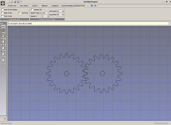

« Reply #15 on: February 14, 2011, 04:15:52 AM »
 On the project screen or the design screens? ( And is this Win7? )
Both. machine is XP Pro.
Will try it on a W7 laptop tonight and one of the machines in the shop today that's on XP as well.

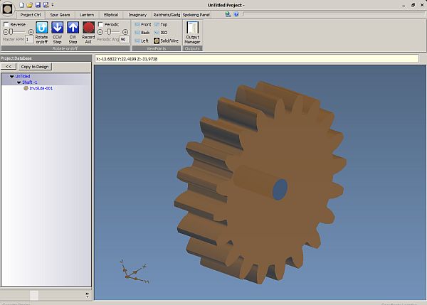

Art, "  Hitting the >> button... ....." are you referring to the >> that is lower left of the screen? If so' on my windows 7 screen when pressed it toggles tool bar options. Also when gearotic design is open it suppresse s my windows hidden  tool bar and I have to retrieve it by pressing windows button on the key-board. When I move  gearotic to my second monitor, the tool bar on the first monitor works as normal. Hope this is relevant. Dan

Correctio n, I found the >> button in the project data bar where it works. I do not see it in any other bars, ie.spur gears etc. Dan

Dan:
   Its meant to only work on the project screen. All the other bars are not required , ( except when making a helical or bevel
) so they shrink. I didnt remove them as I have some plans for them, but they purposly shrink away to make sure you have as much screen as you can have.
  Johns photos above are exactly the way it should look...ex cept for the lack of text which is kind of a mystery to me at the moment as all my text works fine. Other than that though his screens look pretty good.. and is what you should see.
   I think the new screens look and work much better as ar as intuition of use, but we do still have a few bugs before Ill call the new GIU done..
